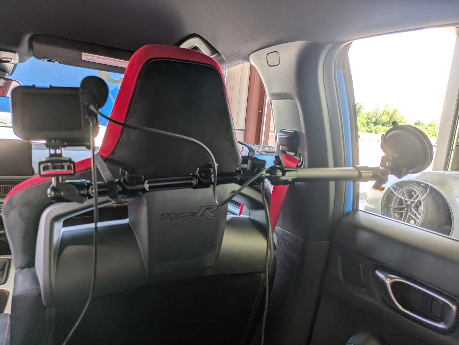

I messed with a couple different options and ultimately settled on a suction mount from the rear glass with extensions to get the POV I wanted. I run a small strap through the seat passthrough to help stabilize it since it's a pretty long lever arm, but so far it seems to be the best solution, aside from 3D printing a mount that would fit through the passenger seat, which I'm also working on with a friend.
Here's the perspective, I'm happy enough with it that I'll probably just stick with it until I get the time to work on an actual seat mount:
do you have the exact link to the suction and arm?

Thanks for the info, but my 2025 FL5 does not have an adjustable headrest, and I don't see anywhere else that a clamp mount would work.
The fabric of the seat. I just pinched it.

Im not sure how well it will work, but I’m going to try this.
11th Gen Honda Civic Easy camera and mount for track days? IMG_0713
