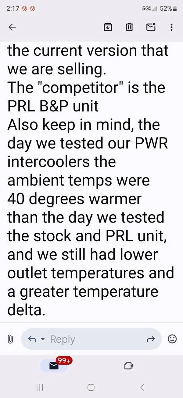

Forgot to add this information about the data that I posted. This is also something to take into consideration.
I think that just makes their entire dataset null and void, worse ambient temperatures affect more than just the inlet and outlet temps on the intercooler. This is blatantly just bad testing. The product may very well be the best product on the market, but incorrect data is just that, incorrect.

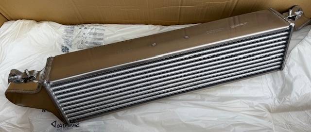

Ordered the J's Racing Hyper Intercooler on 11 February and was given a lead time of 1-2 months for manufacturing before shipment. Intercooler has since shipped.
simpleisbest
Aug 22, 2023
126
118
So. Cal
2023 CW CTR, 2023 Subaru BRZ
No adjustments needed ?
Interesting that they said removing the OEM Air Temp bracket was optional because just judging by the IC thickness it doesnt look like the OEM bracket would fit. Maybe they meant you can bend the OEM plastic bracket out of the way?
