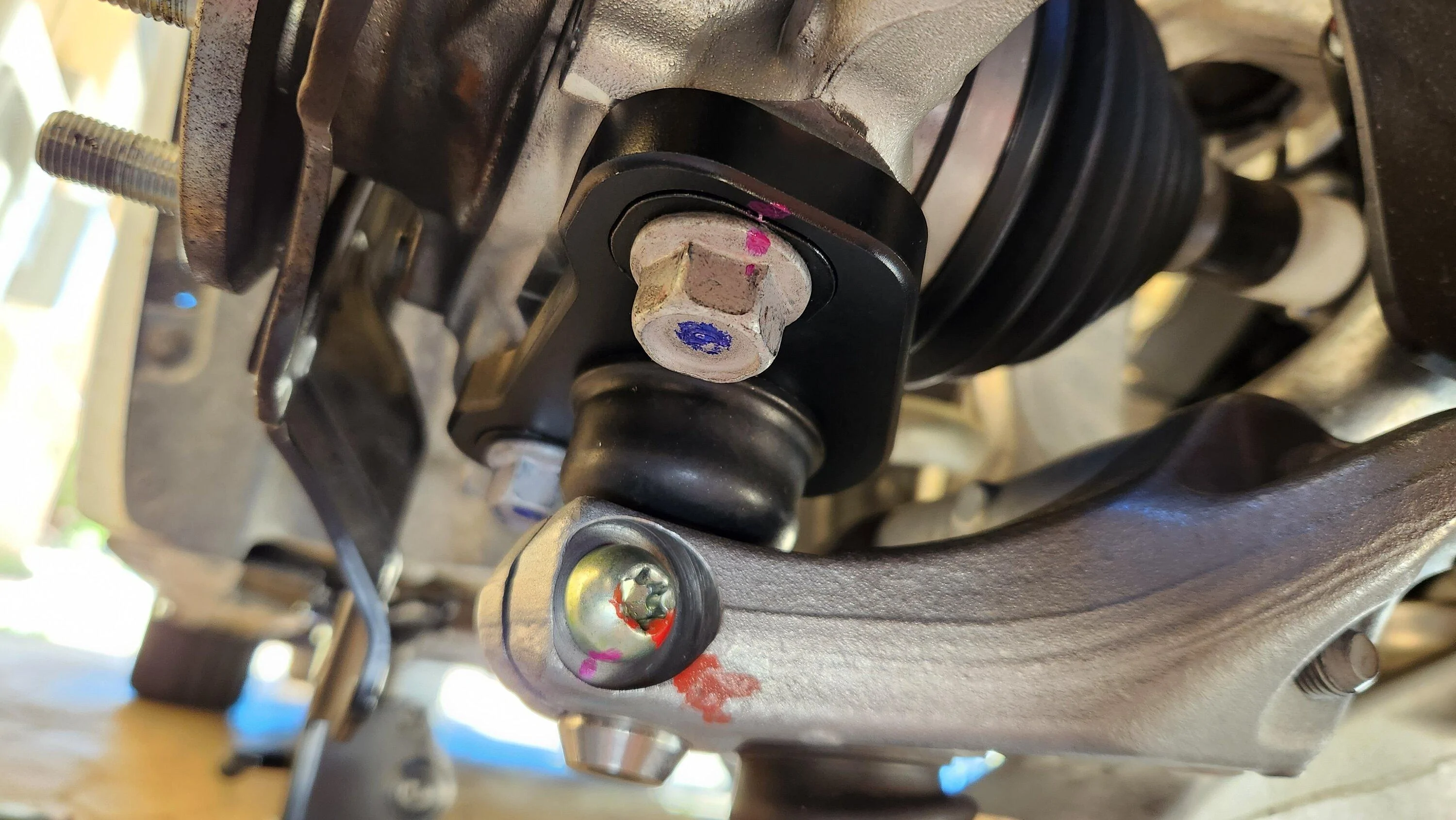

Like keller has mentioned, the stud of the ball joint is pinched by the control arm by a torx bolt. Once the torx bolt is undone it will slip out with relative ease.
The more challenging part is getting your head around how the whole dual axis assembly fits and how each part works and overlaps each other. I have to admit - I'm a seasoned mechanic with a lot of experience and even I was there for a good 15 minutes trying to work out how I was going to tackle the job, at some points I was thinking I was in over my head!
Firstly, the brake rotor must be removed. So that means removing the brake caliper too. You can do this without disconnecting the brake lines, just undo all the brackets that hold the brake lines and feed the caliper forward and place it on a box of some kind (as the lines are in such a way that you wont be able to place it on the ground). The philips head counter sunk bolt that secures the brake rotor to the hub can be challenging - as the brake rotor has moved in relation to the hub and is binding on the countersunk head from the forces applied during braking, this is evident when you observe the alignment of the brake rotor hub in relation to the wheel studs - the best way to tackle this is to rotate the brake rotor in the opposite direction of the braking force to recentralise their relationship. You do this by putting the wheel nuts back on the studs (to protect the studs) and a large screw driver inserted into the brake rotor fins, and elbow grease lol... Once you've done this you'll find that the countersunk bolt much easier to remove. MANY are stripping these philips heads and wind up having to drill it out (which isn't all that difficult tbh just an inconvenience) Alternatively, you may use the brake caliper as leverage (so perhaps best to tackle this countersunk bolt before you remove the caliper) but make sure you wrap it with a thick rag to protect the red paint.
Once the backing plate is moved out of the way (you won't be able to completely remove it as the hub face is too big) the rest is relatively straight forward - undo the 19mm bolts holding the ball joint to the knuckle, undo the two bolts (one long 17mm head bolt, the other a shorter 14mm head) holding the lower knuckle to the upper fork, then undo the torx bolt pinching the ball joint, and push the control arm down clear of the ball joint stud (best to undo the 12mm ride height sensor bracket bolt to allow full articulation of the control arm without over extending the height sensor). You should then be able to remove the factory ball joint with relative ease.
NB: Make sure you have a good quality torx head 3/8" socket set as this torx bolt is damn tight. Don't use an impact wrench here.
The ball joint 19mm bolts are 145NM, the Torx bolt is 83NM, the brake caliper bolts are 145NM. Remember you're working with a heap of cast aluminium parts, so avoid using the impact wrench. You'll be surprised at how loose all these bolts feel when you undo them...
Also, you can 100% do this job successfully without damaging anything. Just requires patience, proper tools for the job, and care. Whoever said it can't be done without damage is not being careful and patient enough!
Hopefully this helps you. Let me know if you have any questions.

@tezzasaurusrex instructions are solid. Removing the rotor allows you to rotate the dust shield and have a clear view of the lower ball joint. I guess it's only important if you are working on the floor on jack stands. I didn't loose the inner bushings as well, you can easily push the LCA down. Yes, you need to remove the brake pads. Just remember which is inside and outside for reassembling.
The most difficult part for me was getting the two parts of the damper fork correctly in place again. They have to be perfectly aligned so you can screw the 17 and 14mm bolts back in.
Also, you need to have both front wheels in the air so you can easily rotate the hub to facilitate using the breaker bar and torque wrench. Most of those bolts require a lot of torque.

Brake pads stayed in situ - my car only had around 5000km though. So if your rotors have worn down and developed a lip you might need to pry the pistons back a bit. YMMV.
You can use an impact driver on the philips head bolt. Giving it a good couple of taps with a hammer also helps as @keller mentioned.
Yes this was tricky for me as well - and you absolutely dont want to be forcing anything together as the aluminium casting is very weak. Patience is key for sure!

The thing I dont like about the whiteline design is that it doesn't have a recessed home for the flip chip - rather it is secured by pins and by the friction between the mounting surfaces - so I prefered the hardrace design as it appears to offer a greater level of strength and security with the recess.
I've just found old pictures of the lower ball joints hardrace used to sell for the fk8. They used the holes and pins design. I can't believe they changed their design for cost reasons. Now I'm not exactly comfortable with this choice. They are even missing a pin in these pictures...

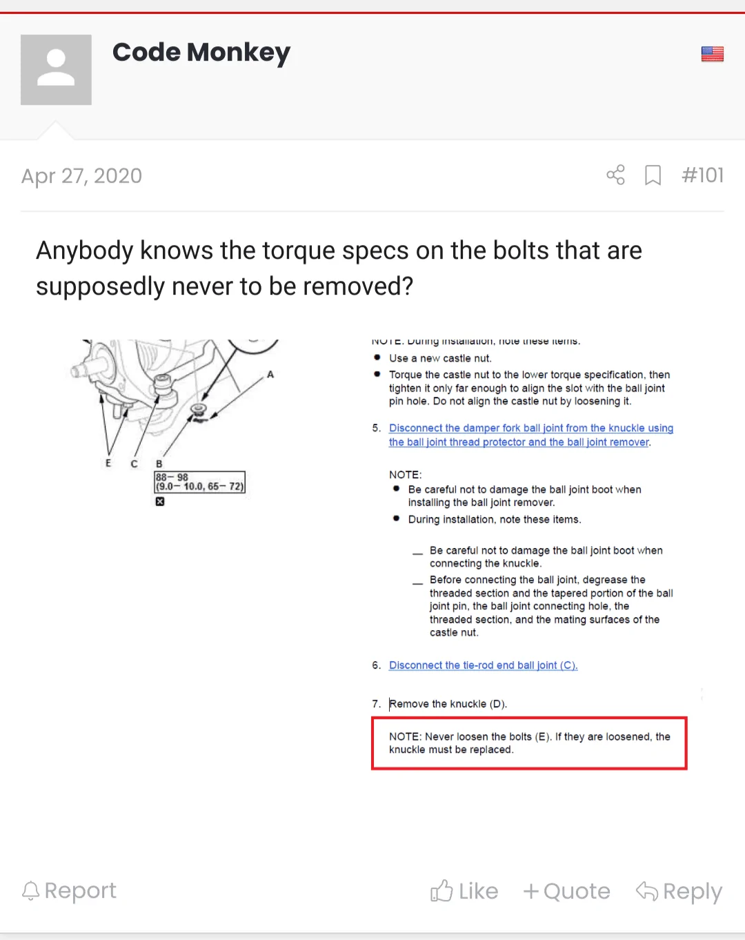

Lol the fk8 service manual explicitly says to never even loosen the bolts of the ball joint.
Yup! Honda even recommend every suspension bolt/but is replaced as they deem these to be one-use only. The chance of thread galling is high on these cast aluminium components so extra car should be taken. I've re-used hundreds of these so called one-use bolts in my time with no issue - although I would recommend if it was engine related that you'd follow the manual to the tee!
As for the Hardrace design - the recessed version is for sure the better design of the two.
