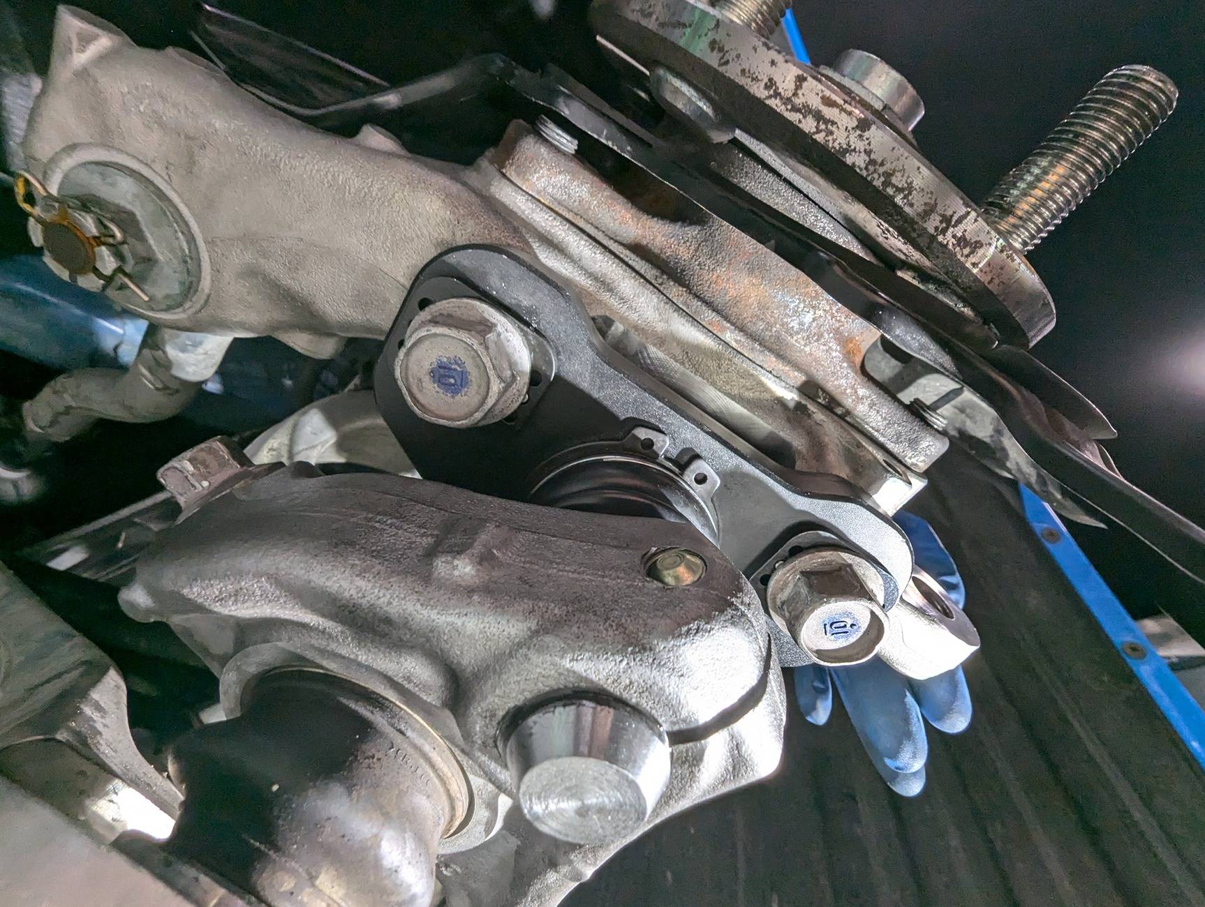

I wish I would've read this before installation. Lots of amazing tips here. Unfortunately, I used an impact only for removal. Luckily didn't have any issues putting everything back together.
11th Gen Honda Civic Stock Front Camber and tire wear on track PXL_20241104_214301443
I only removed the 19mm bolts and T50 Torx. I was able to pull the hub out, and upward to expose the ball joint. It had just enough clearance for removal and entry. Certainly requires a ton of patience.

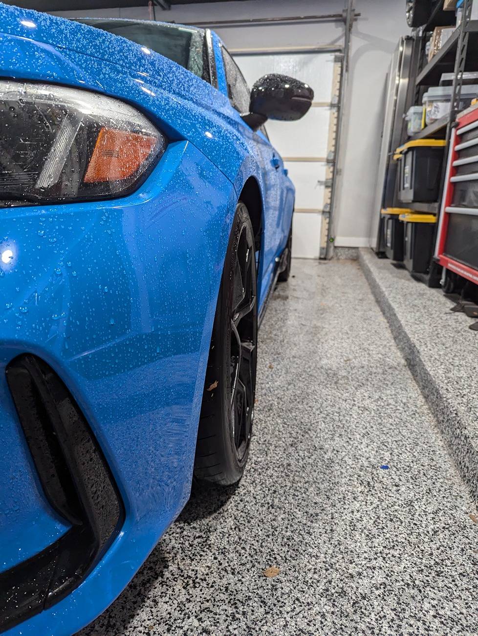

Some tips for anybody planning to do this by themselves:
  • Removing the rotor makes the job 10x easier if you don't have a 2-post lift.
  • For the rotor screw removal, find an impact Phillips bit and use an impact drill to loosen. Lean your body against the drill to gain full contact. I found this to be extremely effective after chasing down a stripped rotor screw on the other side. I didn't have any luck with the Vessel Impact screw driver.
  • Make sure you have alignment shop close to you. The car will essentially be undrivable after the install.

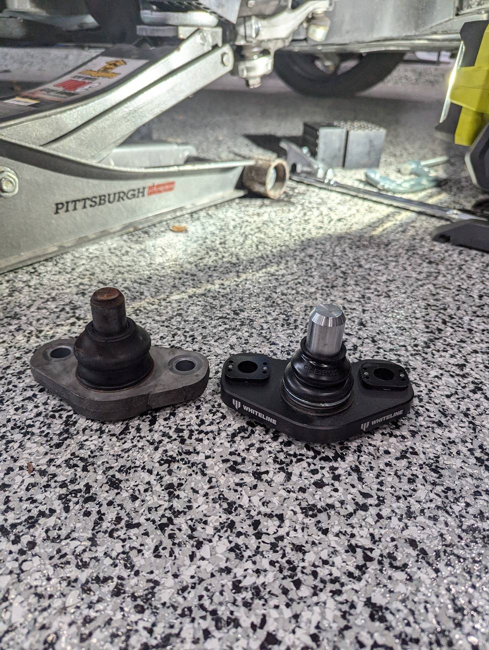

Just reading about the rotor removal though gives me the sweats, phillips is such a bad design but have also had hex strip on me so can't win, it will probably be a drag.
Edit: actually question for yall, are the whiteline the ones to get? Any difference btw those and other brands? I remember hearing of some wear on the little plates that lock the camber?
