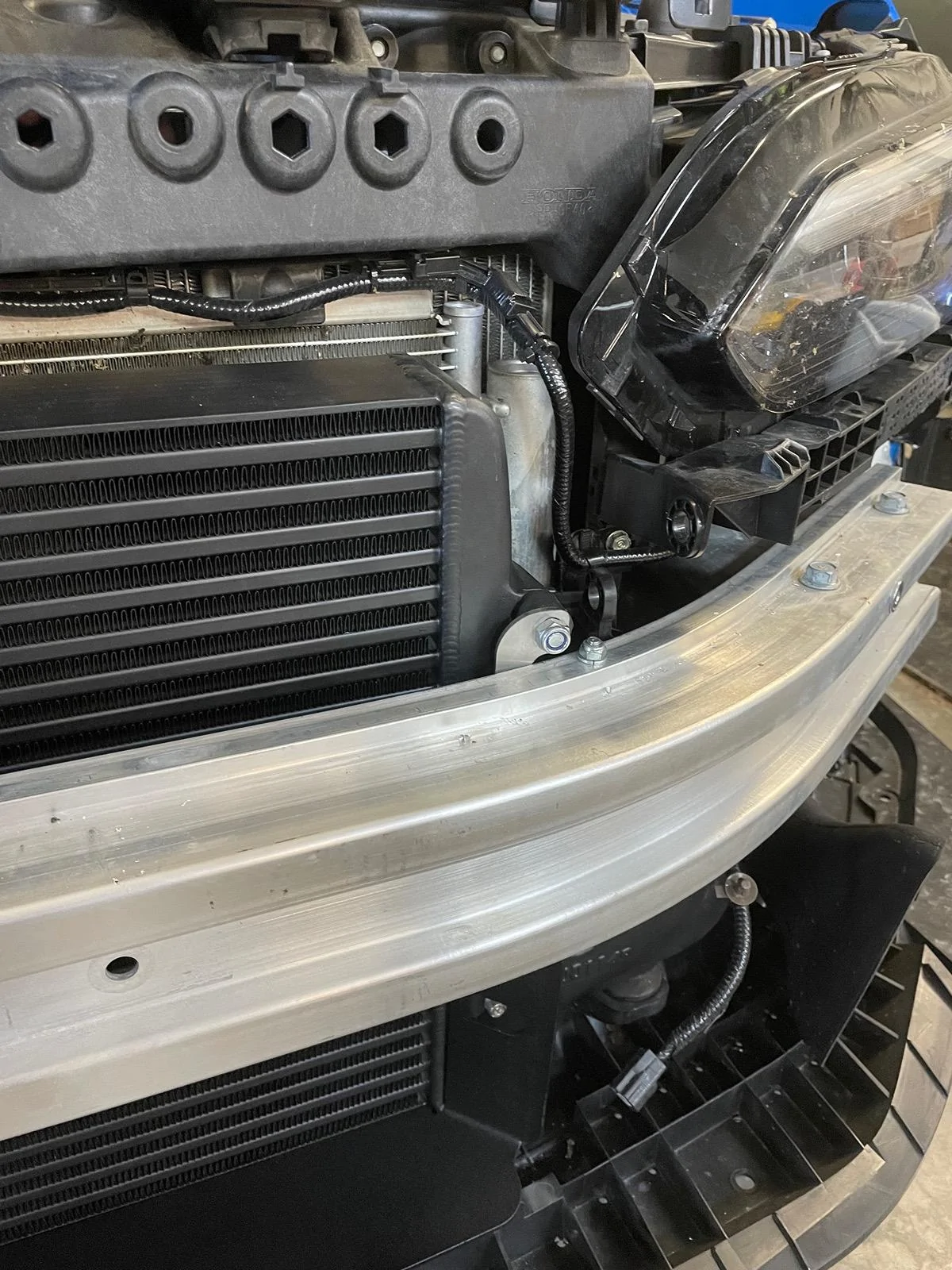

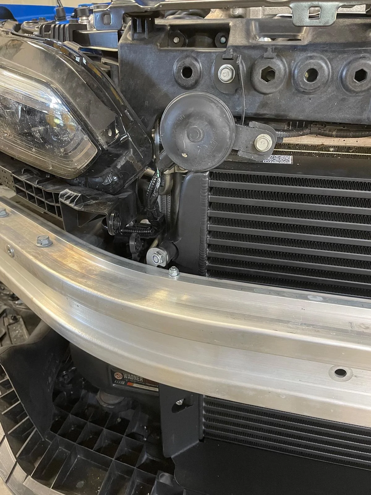

This is how I ended up doing mine. Mounted the isolators and brackets on the intercooler with the lip tucked under the rim of the crash bar, marked a dot for each bracket location, drilled two holes through the crash bar lip, and secured the brackets with two stainless bolts with lock washers and nuts. Somewhat of a pain in the ass to get the bolts in the bottom of the holes but I used a short magnet on a stick to guide the bolts up from underneath and then dropped the lock washer on and threaded the locking nut. Overall pretty clean install and it’s very secure now. Sure wish this was a bit clearer with some instructions, the rest is pretty straightforward. I’ll run my Hondata and collect some logs on my drives for the rest of the week and send them over for comparison.

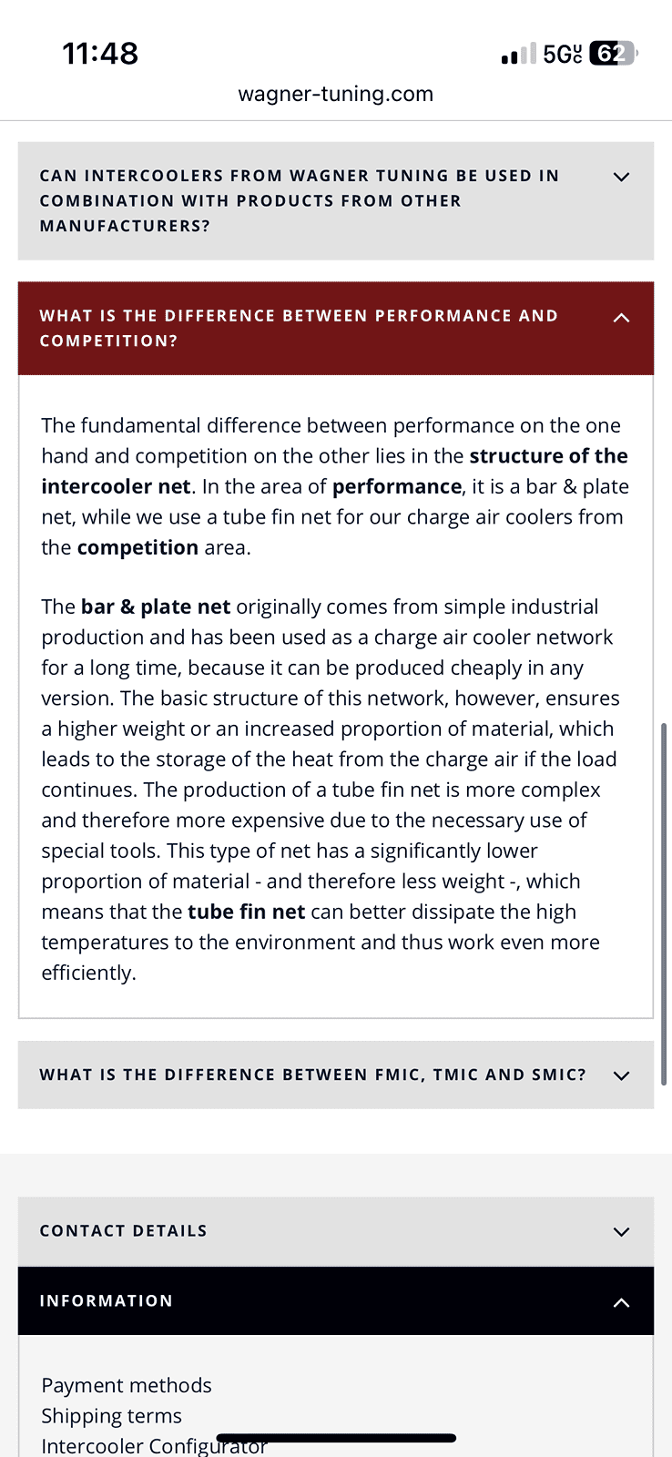

I was told it was tube / fin. (Pics appear to show otherwise.)
Can anyone confirm?
Can anyone confirm?
Those interested in a quality and cost effective tube and fin design should keep an eye out for a new release from PWR. I'm sure it will be more than $890 but less than the JDM options out there.

These guys were discussing bar and plate v. tube and fin late last year. The discussion starts at about 6:30 and testing follows.

2023 Civic Type R #2486
