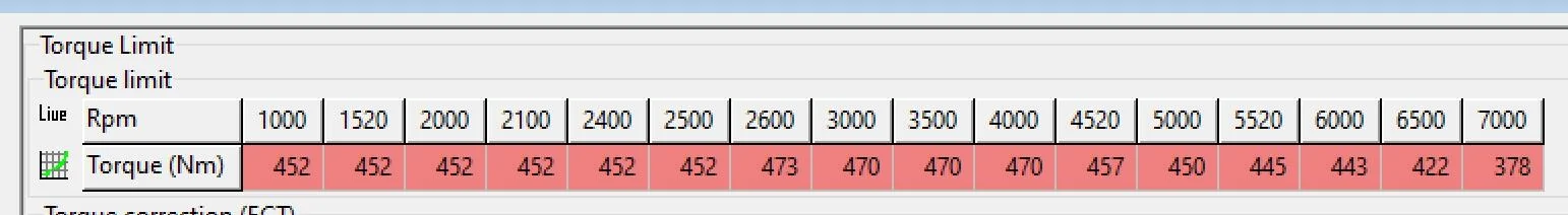

If I recall correctly from my FK8 days, the Bosch ECU is programmed to reach torque targets based on throttle position and RPM. It uses the air charge to do math. It will not make more power if you use a higher octane than what the torque targets were designed with. In the FL5 that is 91 octane.
The knock retard strategy (again, IIRC) is:
press gas pedal -> low octane will knock ->car pulls timing/reduce knock
However when you let go of the pedal it forgets everything and does it again next throttle press
So you can use 87 in a pinch, but long term stick to 91+, as you will continually hit the cycle of knock then reduce and repeat.
For reference the DE5 ITS has a slightly more aggressive tune than the FL5. It requires 93+ as written on its gas cap, vs. the FL5's 91. I have to check Honda's base maps to see if it's due to increase torque targets or the pop and bangs.
Edit: added default torque limits. Seems ITS is a bit higher after 4000 RPM. Below that Type R is slightly higher. My guess is the 93 octane helps with higher rpm increased torque targets
11th Gen Honda Civic What type of gas 87 or 91 FL5_Default_Torque_Limits
