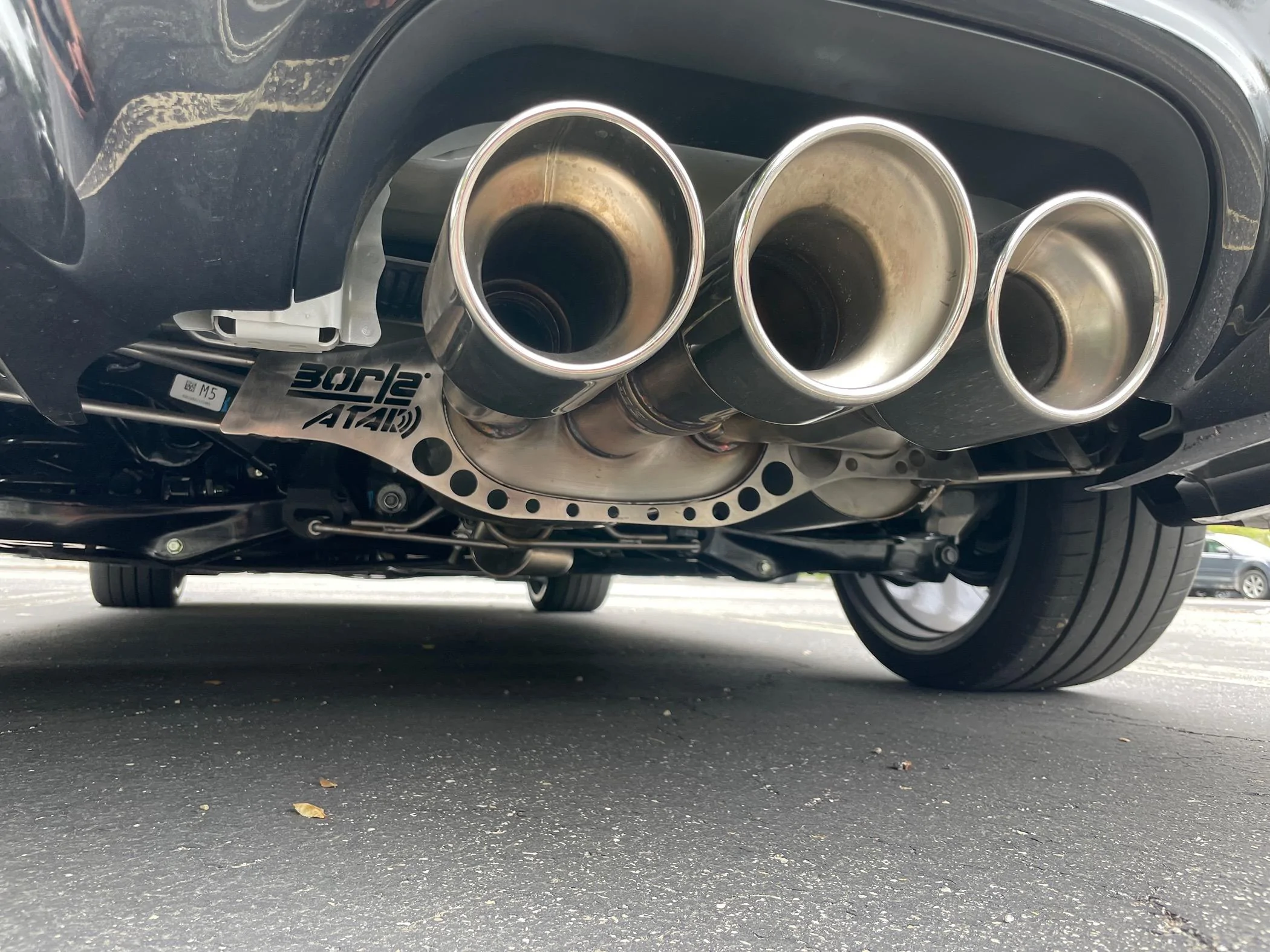

Here's a pic btw.
11th Gen Honda Civic Tegiwa intake comparison/test IMG_2471
Interesting to note that they stayed with the uneven tips that's currently on the FL5 system.
