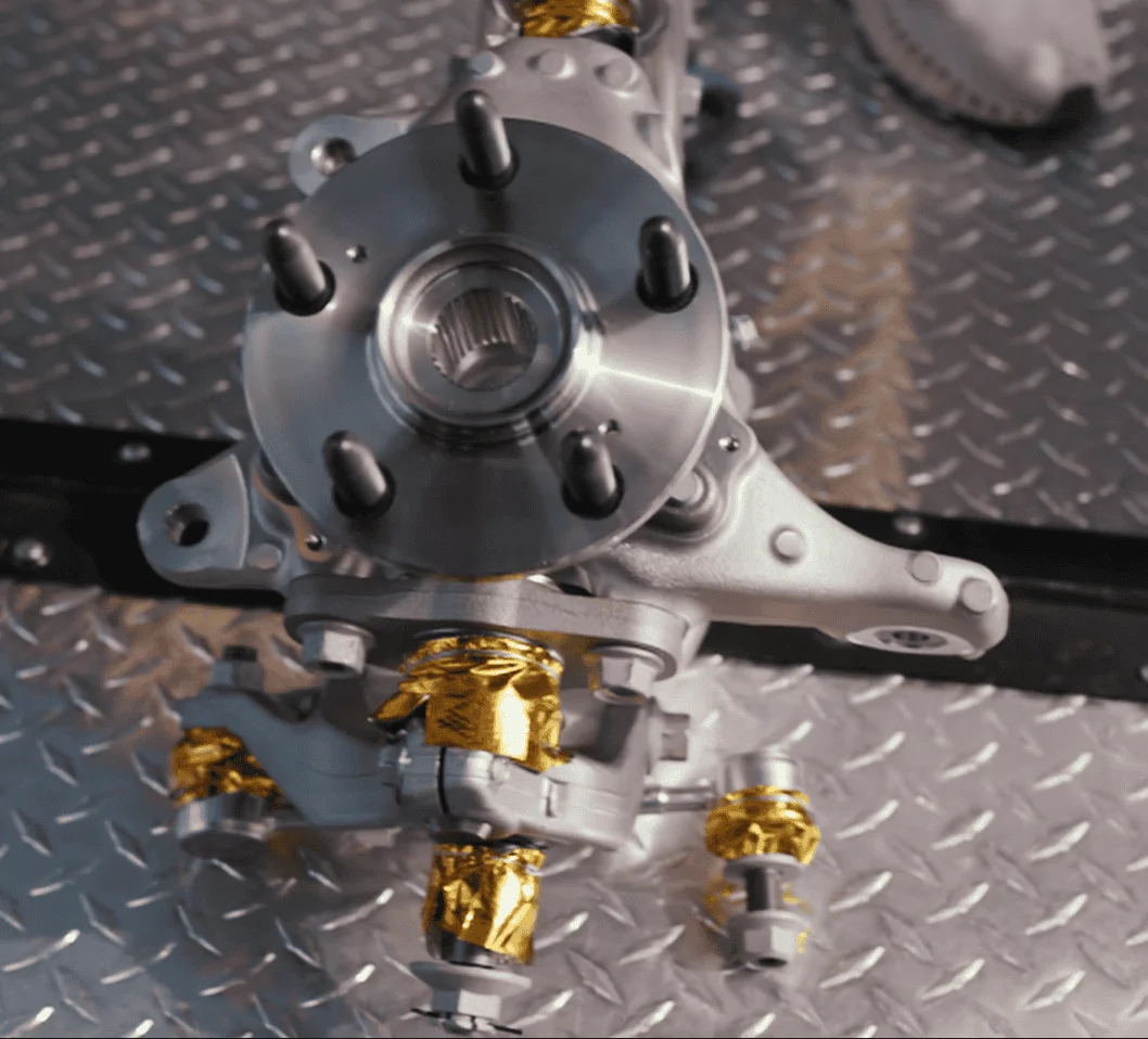

Was watching the Spoon FL5 video of their 25 hours of Thunderhill race, and they showed the front knuckle and control arm, and all exposed rubber wrapped in gold tape and what looks to be metal zip ties (same as what I do). Thought was interesting and thought of you.

I'm gonna do the same thing!

It looks like they may have used mechanics wire to hold the tape on!

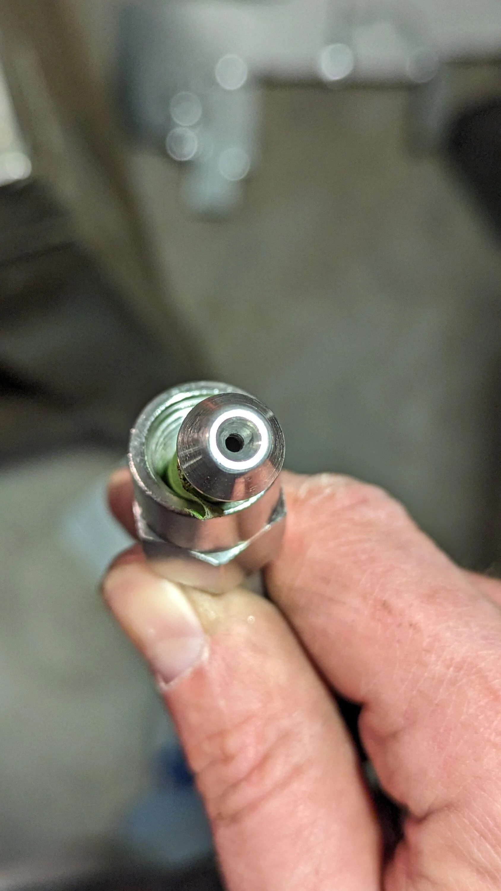

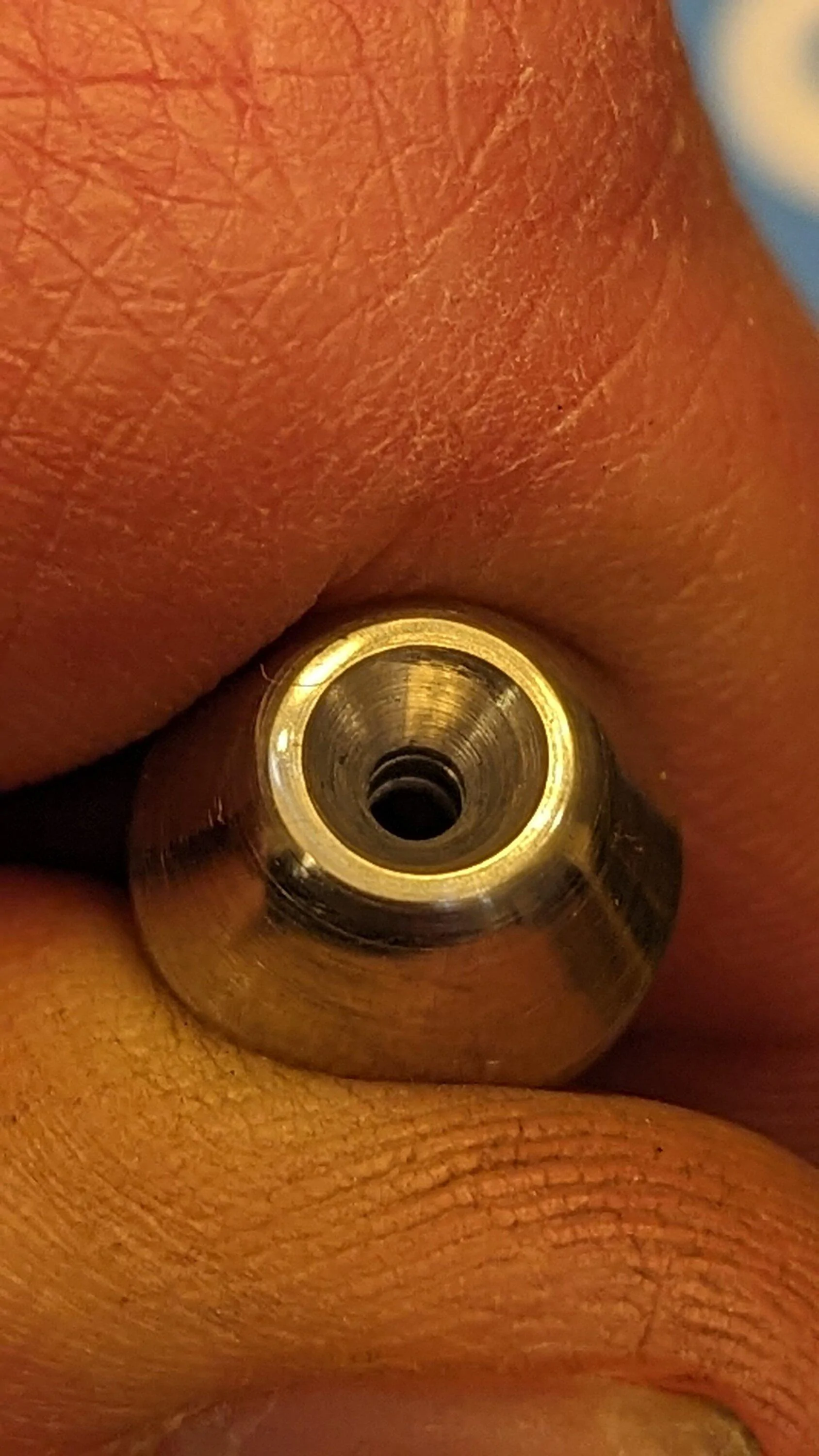

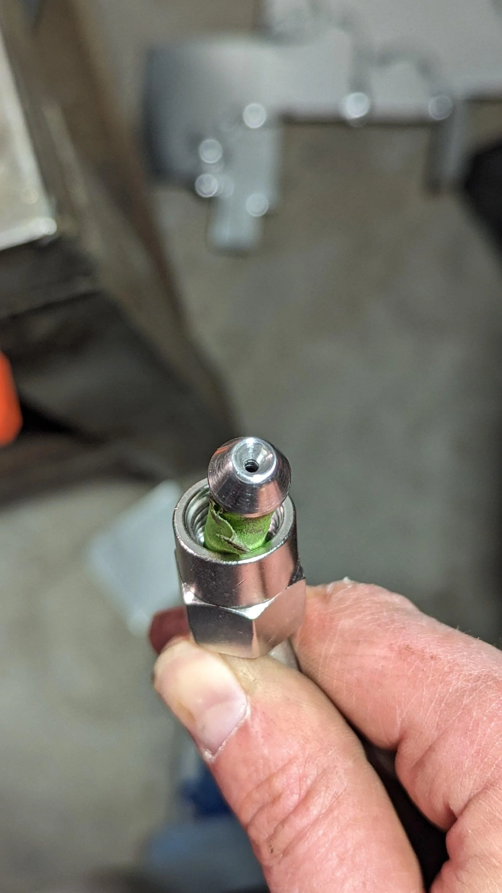

Did a little fuel line mod today! Managed to get a quadruple taper! .073-.076-.078-60° countersink to 82° countersink. Needle file deburr in the smallest sections, then polished the out lip to 1500 grit @Jester04 will be the guinea pig!
I think I’m going to change my username to guinea pig?.
