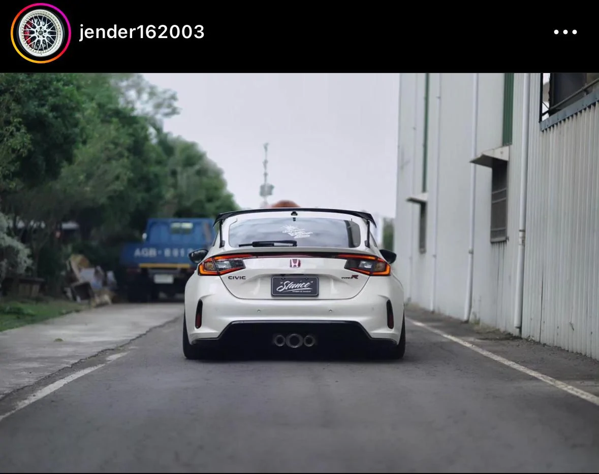

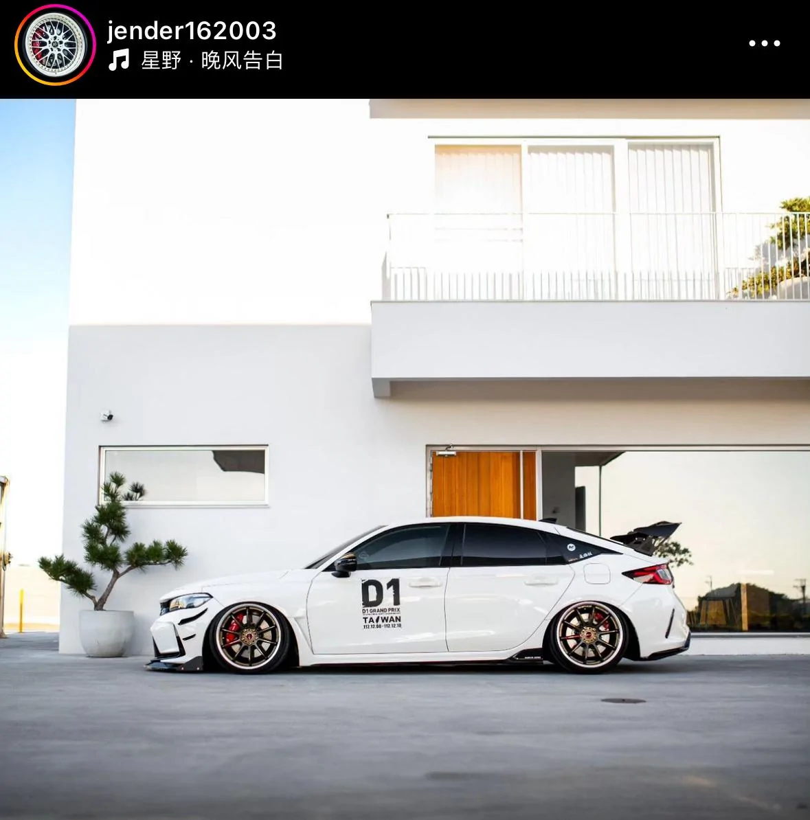

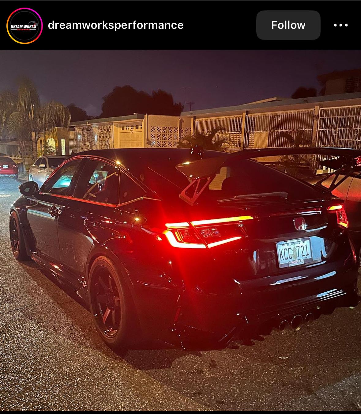

Just chiming in to the Cusco risers as I was really interested with it too.
These photos are from ig with OEM wing:
(Added the ig handles if you want to check it further)
and these are with the Varis CF Wing which I think looks better with it being bigger and more aggressive imho.
Personally, I’m going to wait for the upcoming Voltex and Varis Evo to release more photos of their CF Wing and decide where I’m heading at.
hope it helps!
what wheels are on the white fl5? Anyone know
