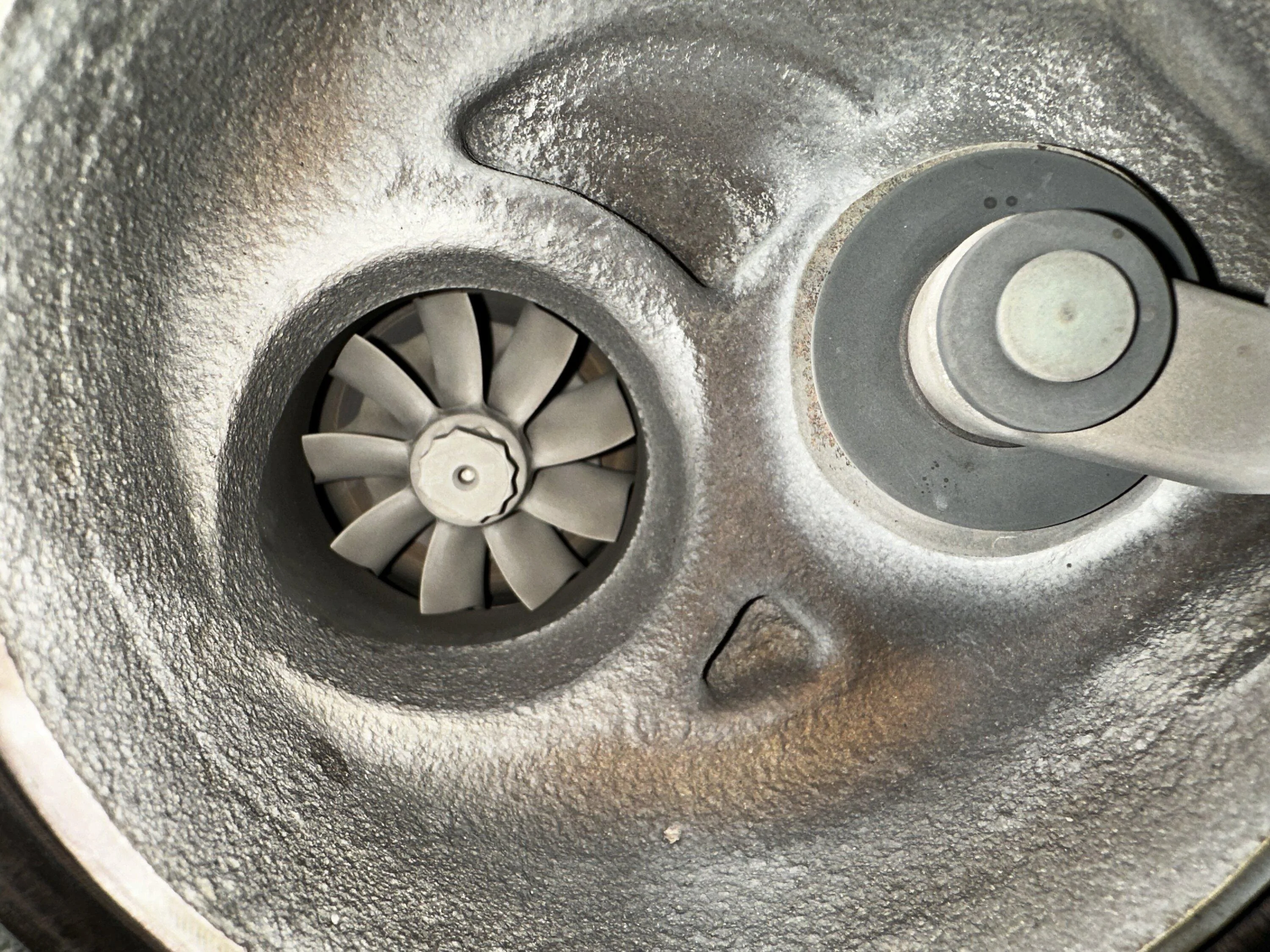

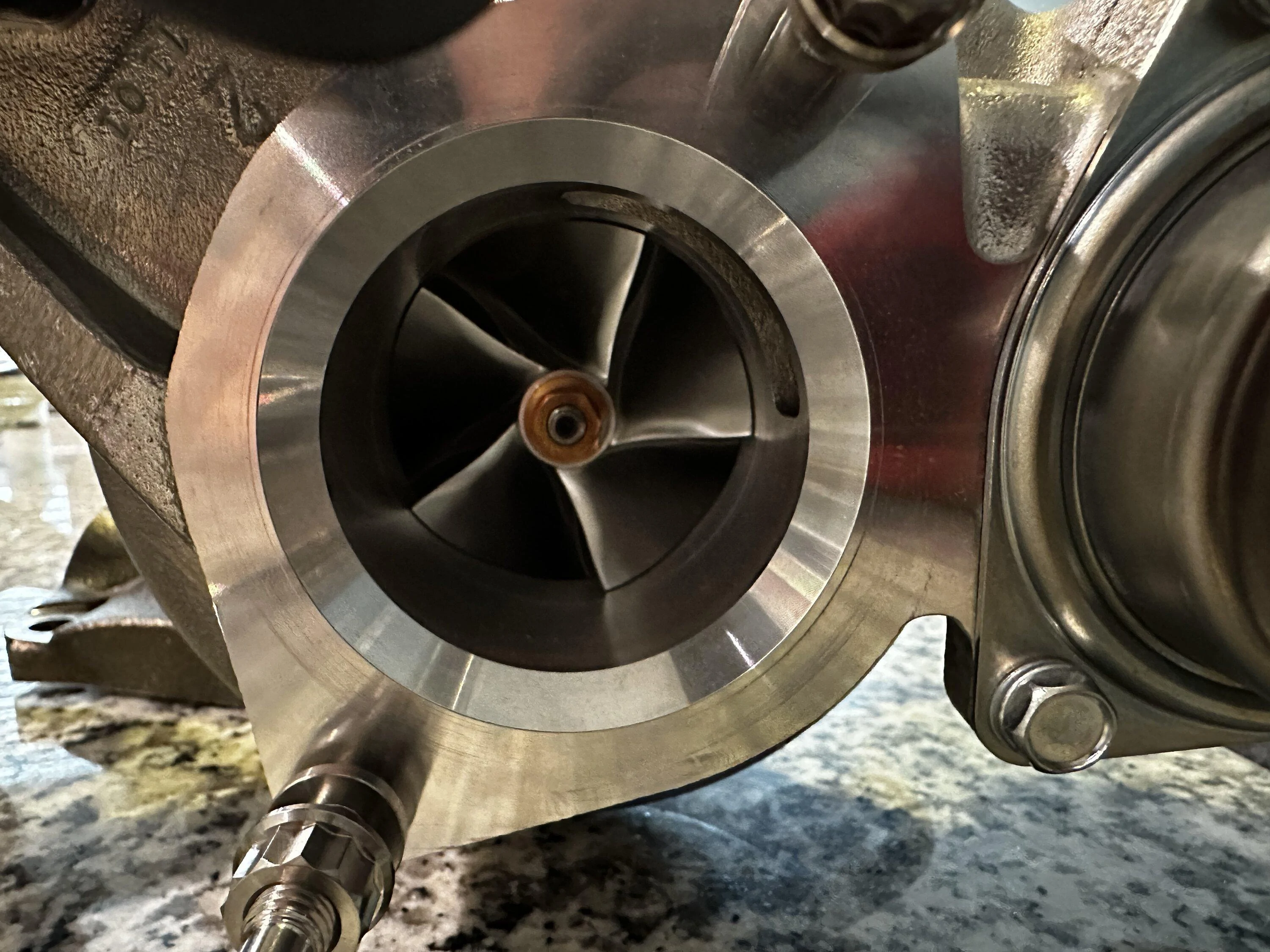

So it took a bit of time to get you guys an update had some issues with some hardware. So was working resolving that. I’m not 100% happy with the current downpipe so I might go with something else in the future but for now that will do.
Stock turbo

MHI stage 2
