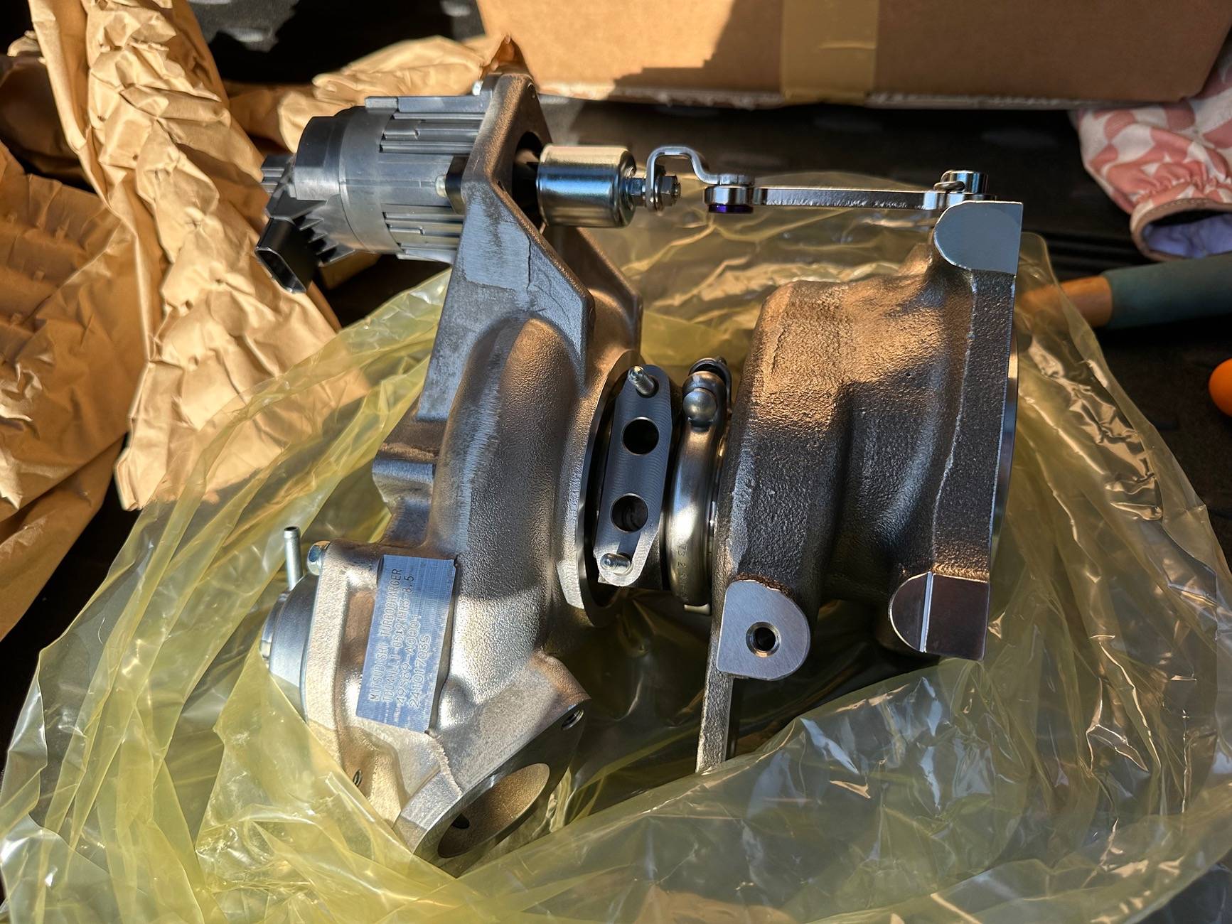

Hey, all. I’m really new to this scene, so forgive my ignorance when it comes to stuff. I’m really just ordering parts to have a lot of fun with my car.
So far, I have the Eventuri Charge Pipe, Eventuri Intake System, PRL Intercooler Billet, and AWE Track Exhaust.
I’m planning to order the Kuro+ Turbo and 27won Downpipe. Eventually, I’ll be upgrading the fuel system, so that’s why I’m going with the + rather than the regular Kuro. Other than that, does it seem like I’m missing anything that could do me a lot of good?
I already know the Turbo is overkill since I’ll mostly be on 93 Octane (at least for now), but it looks like it’s probably the best fit for a guy who wants power but plans to spend 90% of their time driving for regular purposes/on regular streets.
