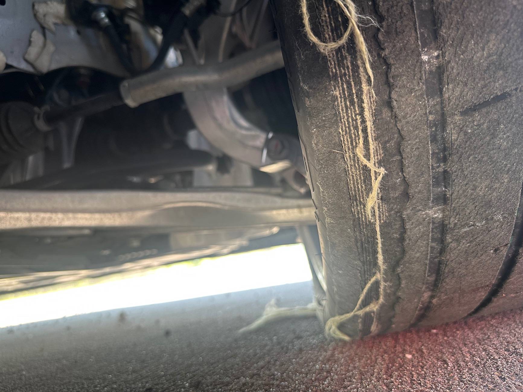

Going back to alignment, I dialed the front back to around -2.8° for negative camber.
After I did that I thought I'd take a picture of last year vs. this year, and as you can see from the labels this isn't a perfect comparison, but the previous set (same size, same wheel width, same offset) still did similar sessions on the front + additional sessions on the rear, and still isn't worn through.
Didn’t notice you are running RE71RS.
From my experience they are definitely happier with camber around -2 to -3. When I used the Advan A052’s I noticed they like much more camber, as I had destroyed the outside edge at -2 camber.
that wear pattern of the one of the left looks awfully like toe wear.
I wonder if its possible that with the increased front grip, you are getting increased dynamic toe change in the front when under heavy load. Have you thought about upgrading the lower control arm bushings (especially the rear compliance bushing)?
Your 8 session front looks like my Trofeo R after 7 sessions with -2.75 camber. Mine wore out the inside, similar to what you’re showing. Previously, at -1.5 camber, I had a similar outcome on the outside of a PS4S.
I’m at a loss on how to get decent tire life on track. Stock camber I destroy outside edge, more negative camber and I lose the inside. I’ve never had any similar issues with any other cars.
7 sessions, 45 hot laps on a 2.21 mile course:
What other cars are you referring too, and what alignment lasts the longest for you?
It's possible, I don't know enough about the changes of toe with load on this platform, although I don't know that it would be much different than last year? I ran the same tire setup, just with different springs and dampers (and with my rates I should be better-controlled vs. last year). I do know for sure I struggled more with corner exit power delivery which definitely would be consistent with the wear, so we'll see how this weekend goes and go from there.
I had track oriented alignment on GT-R (2 different ones) and Lotus Evora with negative camber and I never had any accelerated or uneven tire wear like I’m seeing with the FL5.
The other cars I’ve tracked (Focus RS, 911 GT3RS) didn’t have any aggressive alignments, but they also never destroyed tires.
Was this with rotation? Are you making a lot of power? With rotation last year and the lower camber (~-2.5° front) I actually got pretty even wear on all 4, with basically full use of the tread (as you can see in my picture).
What is your rear alignment set too?
It's never been adjusted, just verified with my gauge / toe plates, so it's still at the factory setting, just lower - I didn't want to pay for a formal alignment until I stopped messing around with the suspension. But, it's about -2° camber with 1/16" total toe-in (I'll run somewhere between 0 and slightly out on toe once I actually get an alignment).
