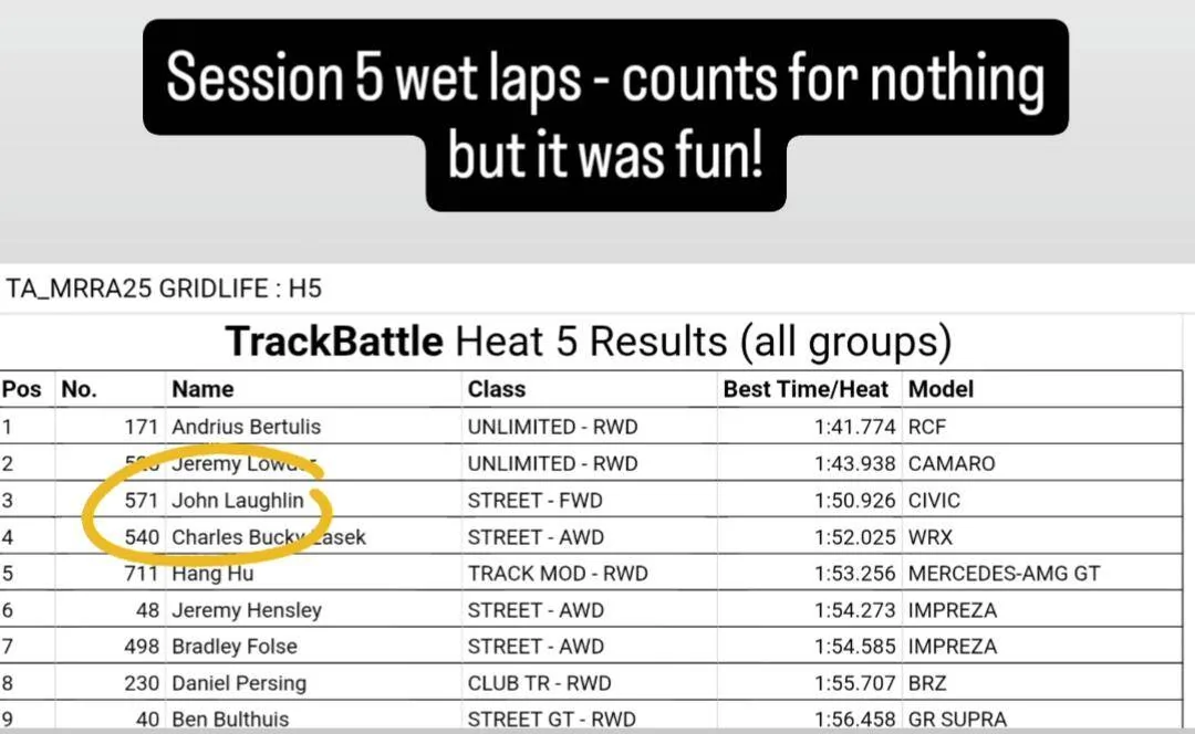

For interested parties...
So, it was kind of a mess - session 1 yesterday had 3 cars off on lap 1 that stayed there for the rest of the session - aka, 3 local yellows in different areas (mostly mechanicals) - total mess. However, this wasn't my only issue - we tried e30 for this event (because super fast back straight), but with the sustained long 5th gear pull the HPFP was losing pressure - dropped to 1900psi from ~3000psi and threw the car into limp mode into T10.
I had no time in session 1, so I ended up at the back of group C for session 2 (aka the slowest cars), and had to navigate around a bunch of Honda Fits and other cars just to get a lap, which is the lap I ultimately stood on (1:38.3 - which I couldn't get a video of because the camera literally fell over onto the rear carpet) - I had one that was .4s up into 10 that suffered a fuel pressure drop again (only down to 2500psi this time), but it killed it, so not even a great time here.
Session 3 I was back up to group B and we made more changes to reduce boost by ~4% in gear 5/6, but it was hotter and I ran into the same issue and came into the pits on the first flyer to key cycle it after limp, but they were behind on the schedule and checkered the session short before I could even get around for another flyer.
I had Brian make a big swing after session 3 (because at this point I didn't care if I lost a few mph I just needed to not hit limp), but it wasn't to be since it rained for sessions 4-6 today.
I did at least go out in session 5 today and verify we finally got the tune working, as it didn't go into limp, and I still managed 141mph into 10 (fastest yesterday was 144 and T7 was garbage in the wet, so I think realistically I didn't lose anything meaningful), just didn't have it sorted when I needed it. Unfortunately, it was just something that would never be detected on a street pull or dyno run. @JST Performance (Brian) thankfully was incredibly supportive and helpful and did 4 revisions for me on site (despite also running GLTC this weekend and having to do his own stuff as well), just the nature of doing a new platform for actual track use. I can't thank him enough for the on-site support!
I did have some fun in the wet though!
getting out there alone is a job well done, but to be 4th in that class is an achievement.
Congrats!!

Thanks! I think a lot of people didn't get representative times due to a variety of issues, so I'm not sure if I had it worse or better than others, but we'll keep working at it!
No way I was catching Luka or Josh though, I don't think that time was there. I did find out I was only about 5mph slower than Luka though into T10 (149 vs 144), even with my issues, so we may be getting somewhere.
