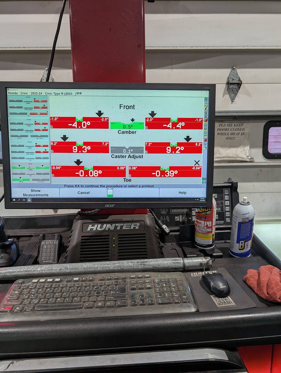

These are my pre-alignment settings after installing the EVS ball joints. The joints are currently in their most aggressive setting. I'm going to swap the collars for the middle setting instead to reduce scrub radius (per @tezzasaurusrex ). My pins are pulled and maxed out. I'm thinking -3 to -3.2 is the sweet spot that I want. 4.4 is just redonkulous. After adjustments I was able to dial the camber down to 3.7 on the aggressive setting, which is still a bit much for me. You can also see how far off the toe is after the installation...lets just say the drive to work today was...sketchy.
*Ignore the castor. These alignment heads are the clip on style, and not the style that actually grabs the rim.
