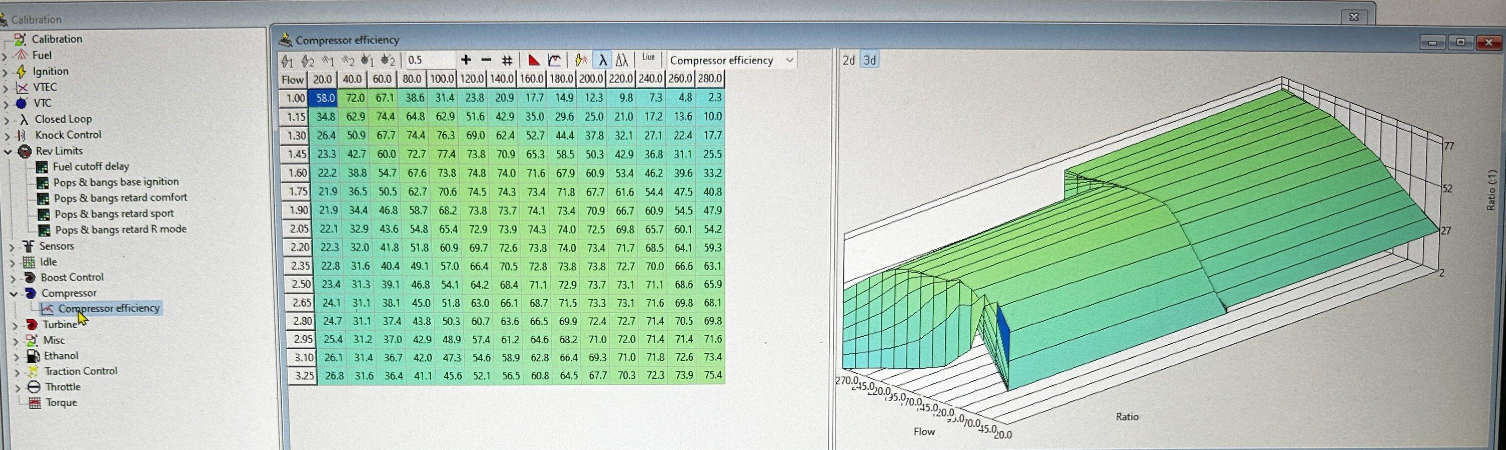

Thanks for sharing great insights! I am a fan of sharing information as that is likely to up the quality of tunes overall.
Is it relatively easy to scale tables for say 8000 rpm redline? As we go beyond factory parameters, I would imagine we will need to figure out turbo model data as well.

So can’t give insight on the new turbo tables since I have not used them yet since I’m stock turbo. Scaling up in RPM’s is ok to do, but for safety reasons I would recommend upgrading internals so it can handle it. I would not go over 7500rpms on a stock engine.
Hondata will keep adding features and making the software more complete so in time it will get better. But if 8k rpm’s are the goal I would jump to Motec if it were me. Hondata I would limit it to 7,500-7800rpms and even then you will lose some resolution of the tables.

For high rpm, I think there are quite a few areas to address in order to do it “properly”.
1. As @Jester04 already pointed out, having sufficient resolution in tables is important. While that might not impact dyno numbers, better resolution (assuming well tuned) will result in a faster and more reliable car.
2. Valve control. Ideally, lighter valves, cams, head work, springs, etc.
3. The bottom end might be okay. Rod bolts could be a good idea. Of course, lighter pistons, longer rods (assuming geometry and other compromises allow), bearings, rings could be helpful if one wants to go further.
4. Overall flow of the system. The turbo is likely the big one here. Flowing enough air at 7500 rpm for peak power at the desired efficiency level and pressure ratio likely means a different turbo.
5. The HPFP is cam driven mechanical. This is where another mechanical limitation exists. The XDI pump is rated for 7800 rpm. If one is not maxing things out, 8000 rpm should be doable.

Yes these are all the appropriate considerations when deciding what to do with the car. And what the goals of the owner are. Things are not as simple as oh I want 8k rpms and a huge turbo. A lot of time planning and upgrading parts goes into this.
