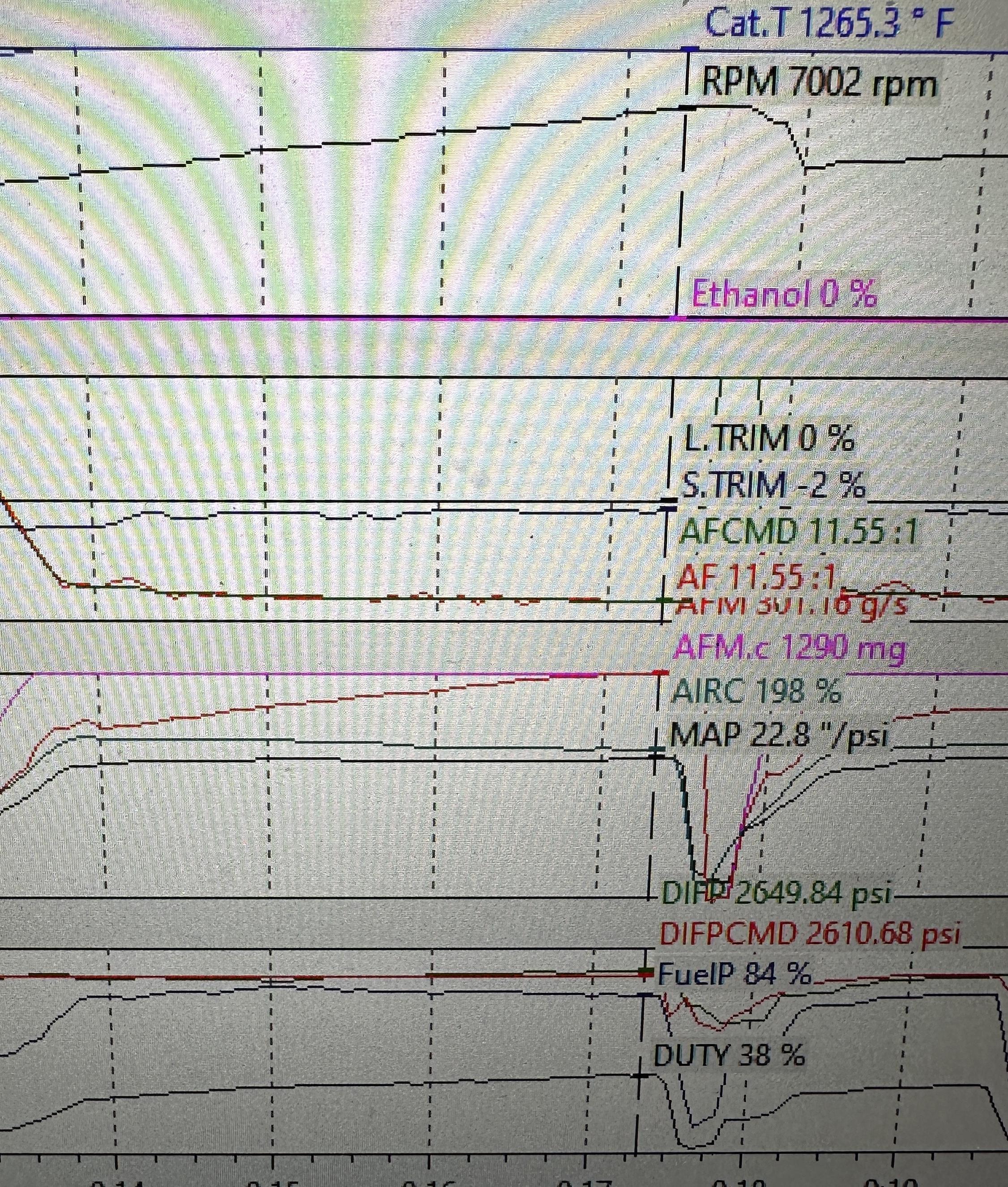

So I think I’m happy where it’s at without stressing the car too much. 22psi on the final revision for the pump gas stock fuel system tune. Going to brush up the afr peaks now to make it all smooth but as far as timing and boost goes it will stay there. 80’s to 90’s on the fuel pump duty cycle.
Also here is a little video of a pull on the car the way it sits.
11th Gen Honda Civic Jester’s Hondata thread IMG_3323

Wow, getting a lot more sound inside the cabin than I'm used to. Still stock intake, right?

I think you're hearing the piped in sound.
You can still hear the turbo spool up at the beginning but most of the sound is from the symposer. But yes @ABPDE5 stock intake and inlet pipe. Just a drop in filter.

testing has shown from my car to jesters that the drop in filter did allow a higher G/S of airflow

Yes it has! Every little bit of flow matters! Plus the less restriction the turbo has on the inlet side the more efficient it can perform.
