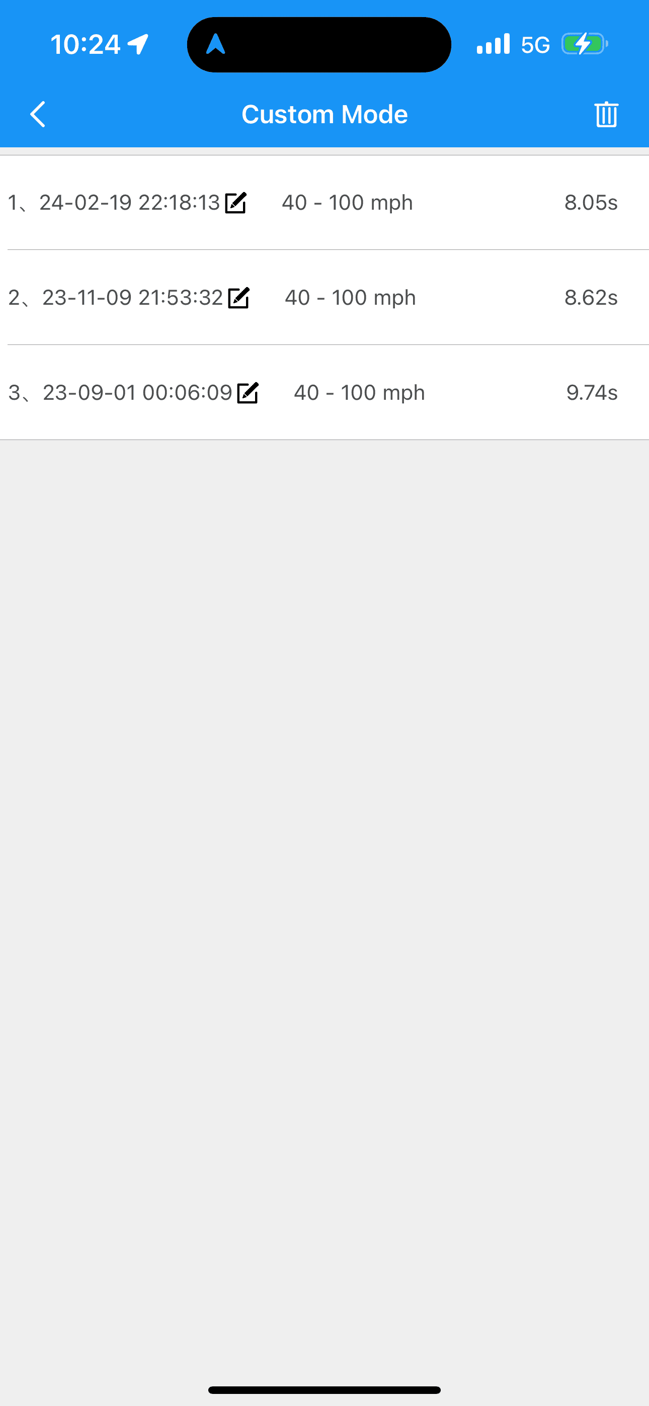

Here is a little comparison. These 3 are 40-100 mph pulls.
Stock 9.74, tuned the 8.62, big turbo xdi pump tune is not done at 24-25 psi 8.05 it would have been faster if it wasn’t spinning so much lol. Should easily do it in the 7 second range with less spin.
