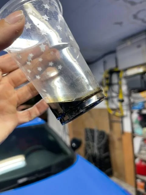

I have the Mishimoto installed on mine. Measured and emptied it 1000 miles after installing - it collected 4 ml - exactly the same amount as Mishimoto said they saw in their testing after a 1000 miles.
About 5000 miles later I changed the oil and emptied the can again - it collected a further 18 ml, so it’s more or less a consistent 3.5-4 ml per 1000 miles. I drive my car hard, but always wait for it to warm up before pushing it.
Here’s what those 18 ml looked like when I emptied it the second time:
11th Gen Honda Civic Is an oil catch can needed?  Just hopped on the Unity Group Buy for the HEL Oil Cooler. 43477477-6375-4159-A9FB-BAE503F83D8F
That’s not a lot, but it’s not nothing either. The can can only make things better in the long run, so I would still recommend it.
Supposedly the k20c1 has a built in oil-air separator - essentially a catch can that dumps what it catches straight back to the pan. That goes a long way towards explaining why not much is caught by the added can, and why inlet fouling isn’t commonly brought up in connection to that engine, despite it being a highly boosted DI without added port injection.
Regarding the radium cans, I recently saw a clip on YouTube where a car (don’t remember what it was) was smoke tested for leaks after some issues, and the pipe fittings on the radium can had smoke pouring out of them and were traced as the issue. The mechanic said it was a common issue with radium cans. Personally I never tried them.
