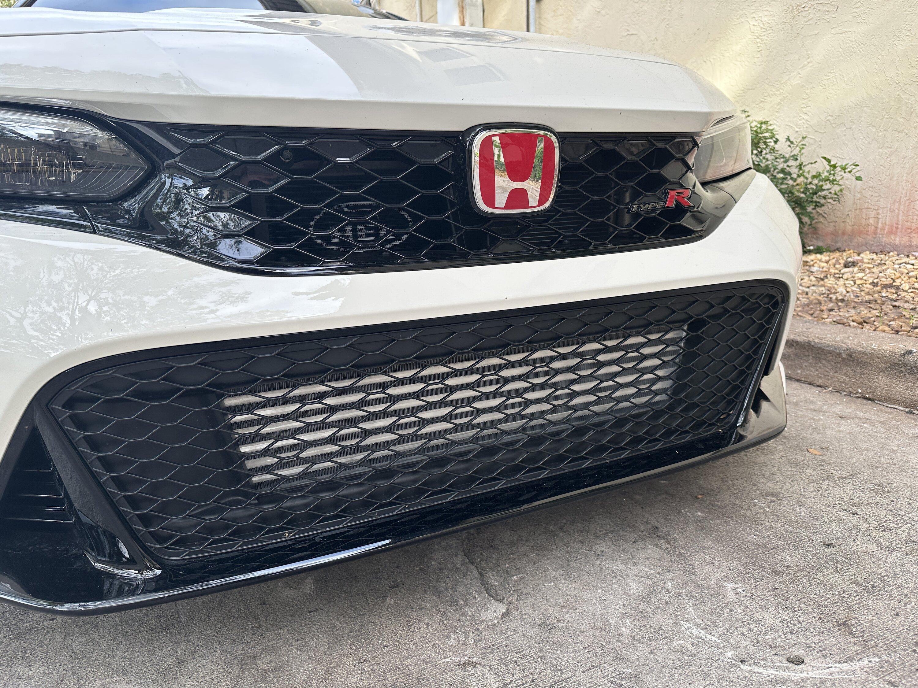

teddytypeR
Sep 22, 2023
west palm florida
2023 type R 2019 gt350 2022 model X plaid
If you can, I'd recommend doing intercooler, oil cooler and radiator in one shot to minimize the number of times that you have to remove the front bumper. Though I've gotten good at it, I still cringe every time I have to remove the front bumper because of all the plastic tabs that hold the bumper on below the headlights. I'm considering upgrading my intercooler piping with the PRL kit, which means I'll have to remove the front bumper AGAIN. Hindsight is 20/20. Wish I had known then what I know now.
11th Gen Honda Civic UPDATE: HEL Oil Cooler USDM & JDM Now Available! IMG_0512.JPG
I did not do a radiator :( im hoping a the oil cooler and intercooler will be the only cooling mods needed.
