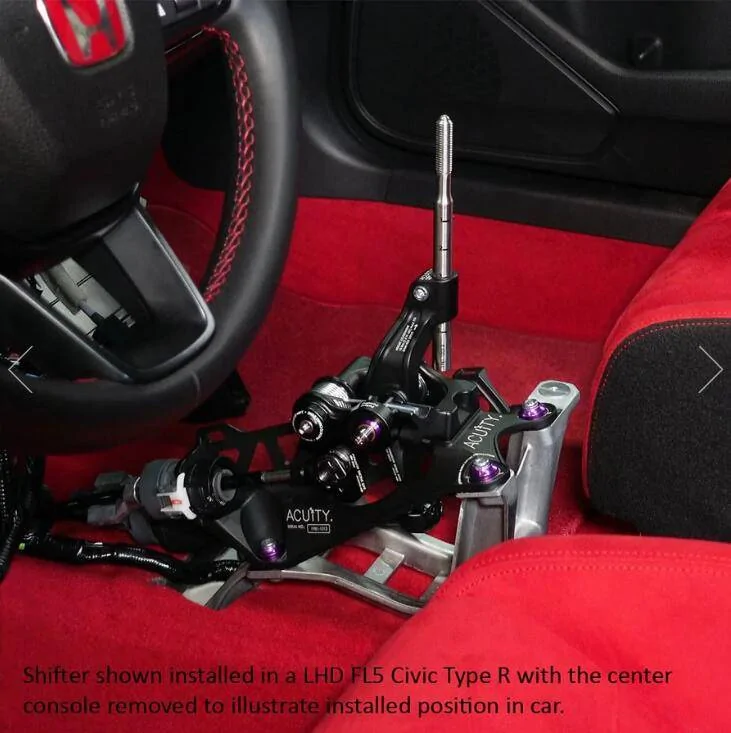

How is everyone going with their Acuity kit? How easy or hard is it to get into 5th gear? And what settings do you have it at?
I've had mine installed for a month or so. It is truly fantastic. I was hesitant to upgrade the factory shifter because it already feels great. The Acuity shifter only improved that feeling. I have tried a few different adjustments, incrementally decreasing the throws and gate spacing. Right now I have the gate spacing on the shortest setting and I actually think it’s perfect like this. The throw is set at about 3.5 and the height about 2.5.
The shifts feel smooth and direct, but overall effort has increased only a little, and that is mostly a result of decreasing the throw.
I know what you mean about 5th gear feeling a little awkward, I've noticed that on my last 2 Hondas as well. Surprisingly, I don't notice any difference in effort to select 5th with the Acuity vs stock.
In my experience with aftermarket parts, I think Acuity puts far more effort into their products. I just wish they had more offerings!
Acuity’s Short shifter / High preload centering spring and Shifter cable bushings is solid. Very notchy and satisfying mechanical feeling, definitely more than enough for daily driving/street or even Track use imo. Honestly no need for anything else unless you want something more aggressive like CAE. Plus, not really a fan of ridiculously tall shifters lol.
Car has 39k miles and no issues with 5th gear, easy to shift into. Currently using the shortest throw, slightly shorter than factory gate settings, and knob is set slightly higher than factory.

Thanks all. Just installed the shifter myself which is set to 3 for height. Gear throw at 3 and gate spacing at 3. Maybe I need to adjust again based on feedback here for that perfect find 5th feel.

As easy it is to remove the center console and readjust everything, I’ve been lazy and haven’t adjusted it ever since install.
I just got used to what I initially set it to haha ?

Also, I found that the shifter gets a little less stiff with time as the bushings wear in.
