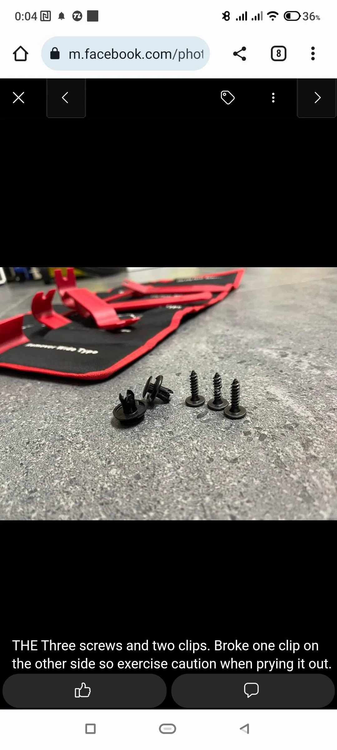

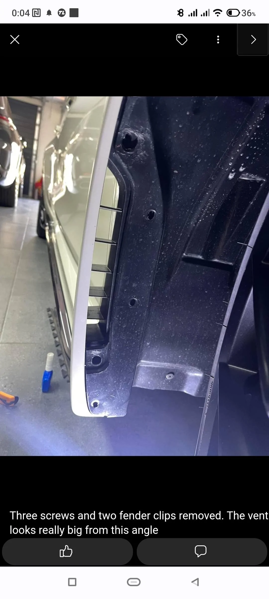

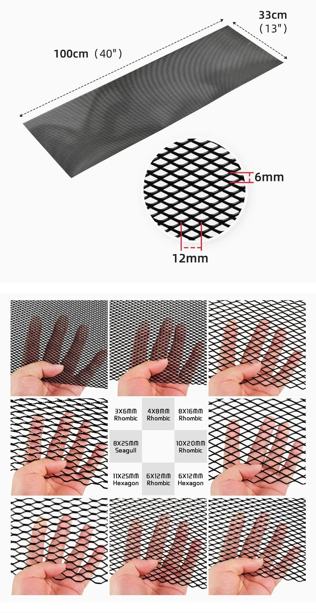

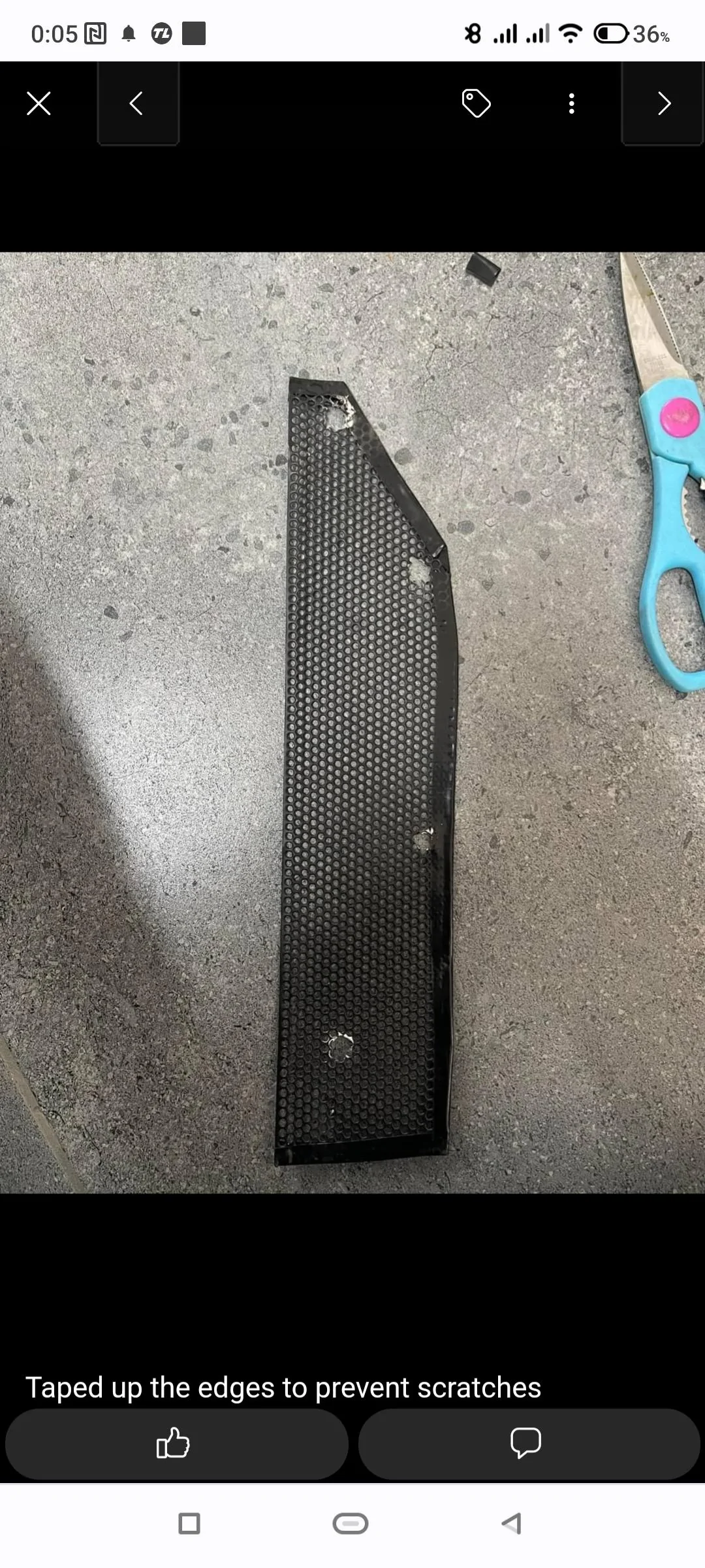

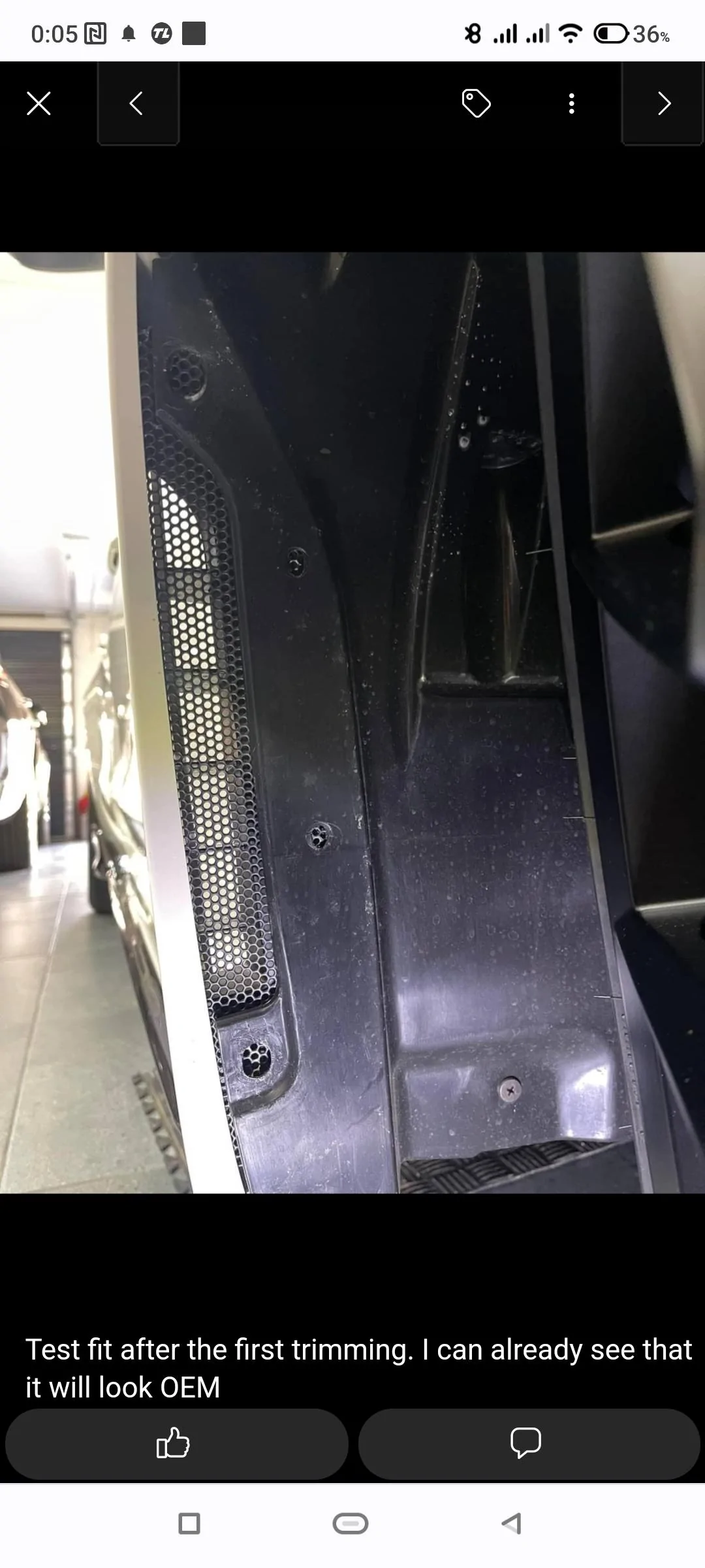

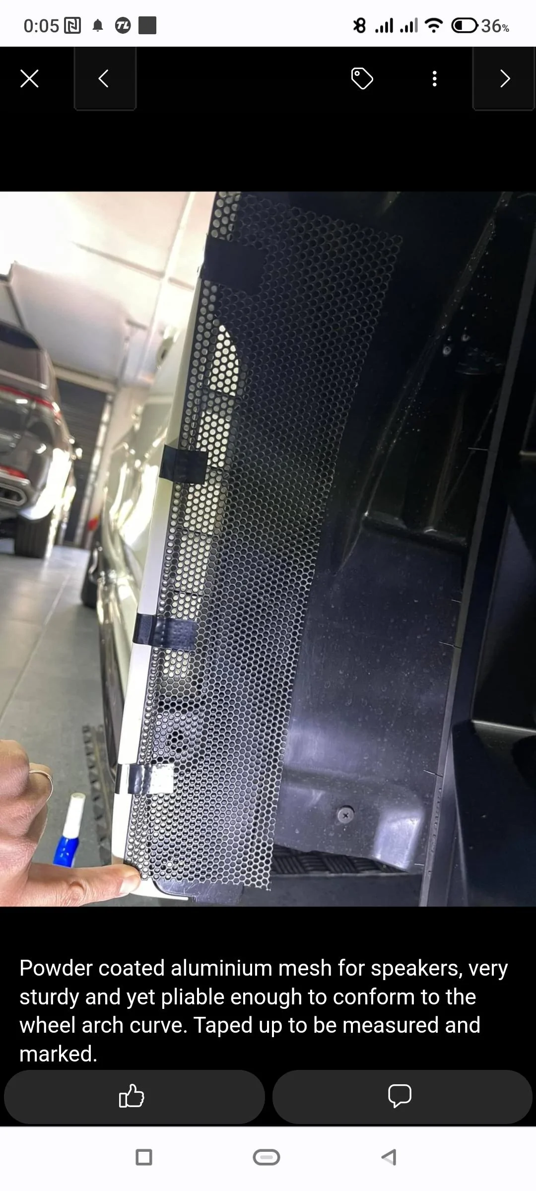

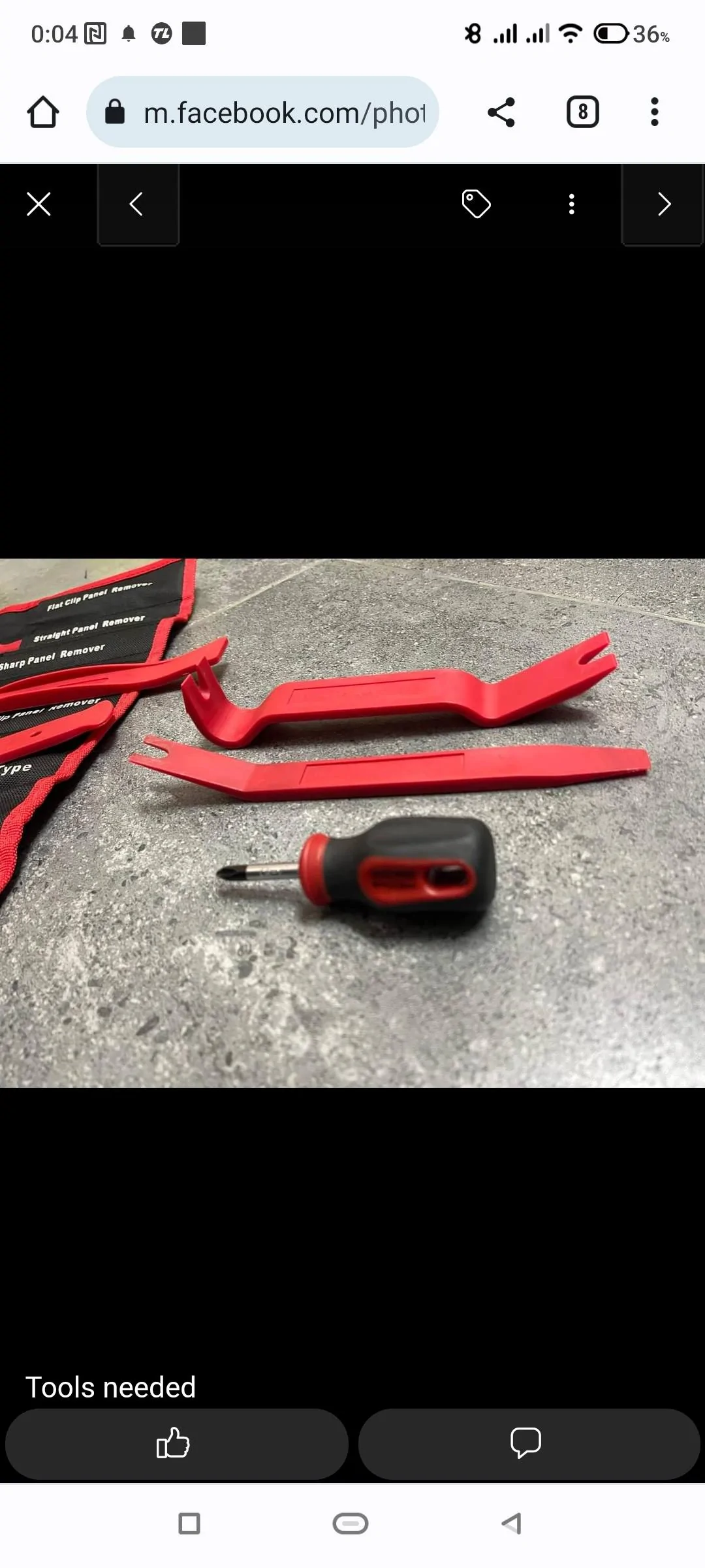

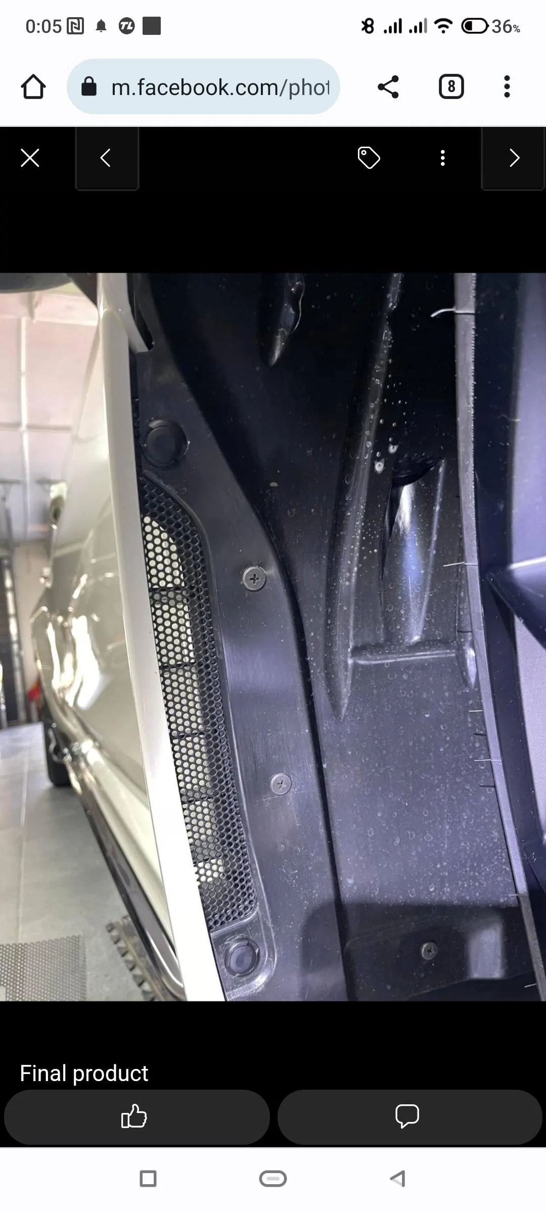

I have seen this home made mod on Facebook. Material is very easy to get on Amazon.
11th Gen Honda Civic Flapfab Stone Guards Screenshot_2023-09-02-00-04-19-063_com.android.chrom
11th Gen Honda Civic Flapfab Stone Guards Screenshot_2023-09-02-00-04-28-745_com.android.chrom
11th Gen Honda Civic Flapfab Stone Guards Screenshot_2023-09-02-00-04-44-867_com.android.chrom
11th Gen Honda Civic Flapfab Stone Guards Screenshot_2023-09-02-00-05-04-544_com.android.chrom
11th Gen Honda Civic Flapfab Stone Guards Screenshot_2023-09-02-00-05-13-980_com.android.chrom
11th Gen Honda Civic Flapfab Stone Guards Screenshot_2023-09-02-00-05-36-242_com.android.chrom
11th Gen Honda Civic Flapfab Stone Guards Screenshot_2023-09-02-00-05-42-604_com.android.chrom
11th Gen Honda Civic Flapfab Stone Guards Screenshot_2023-09-02-08-24-54-109_com.amazon.mShop.android.shopping-edit
It really depends on what you want. You can do DIY if you don’t want to spend money. Or just buy a good product at a reasonable price with great finish and be done with it in 5 minutes.
Plus you support a vendor on the page instead of amazon.
