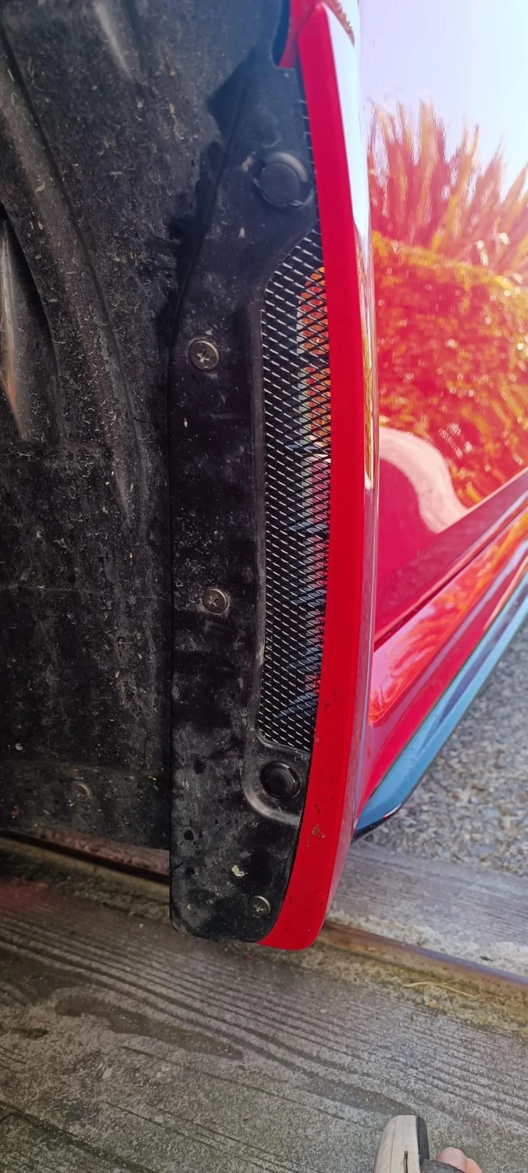

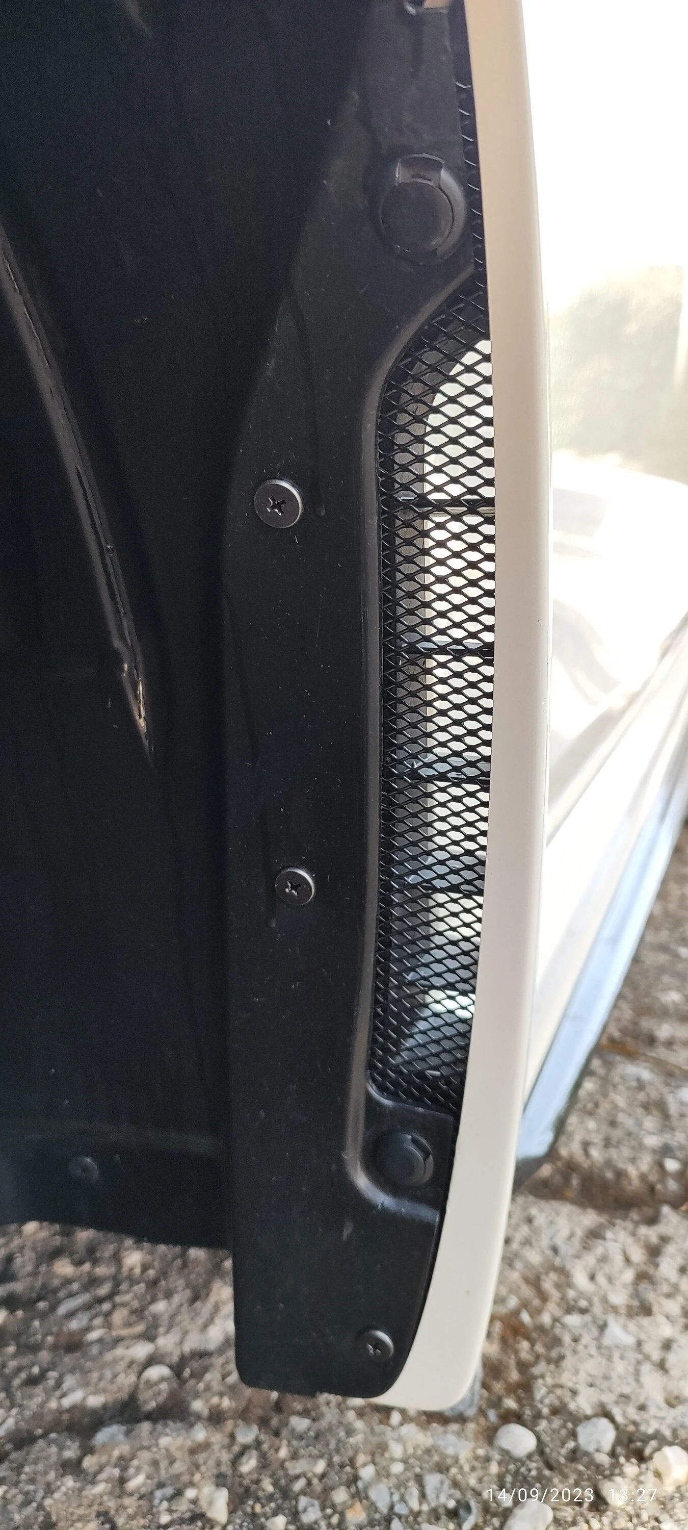

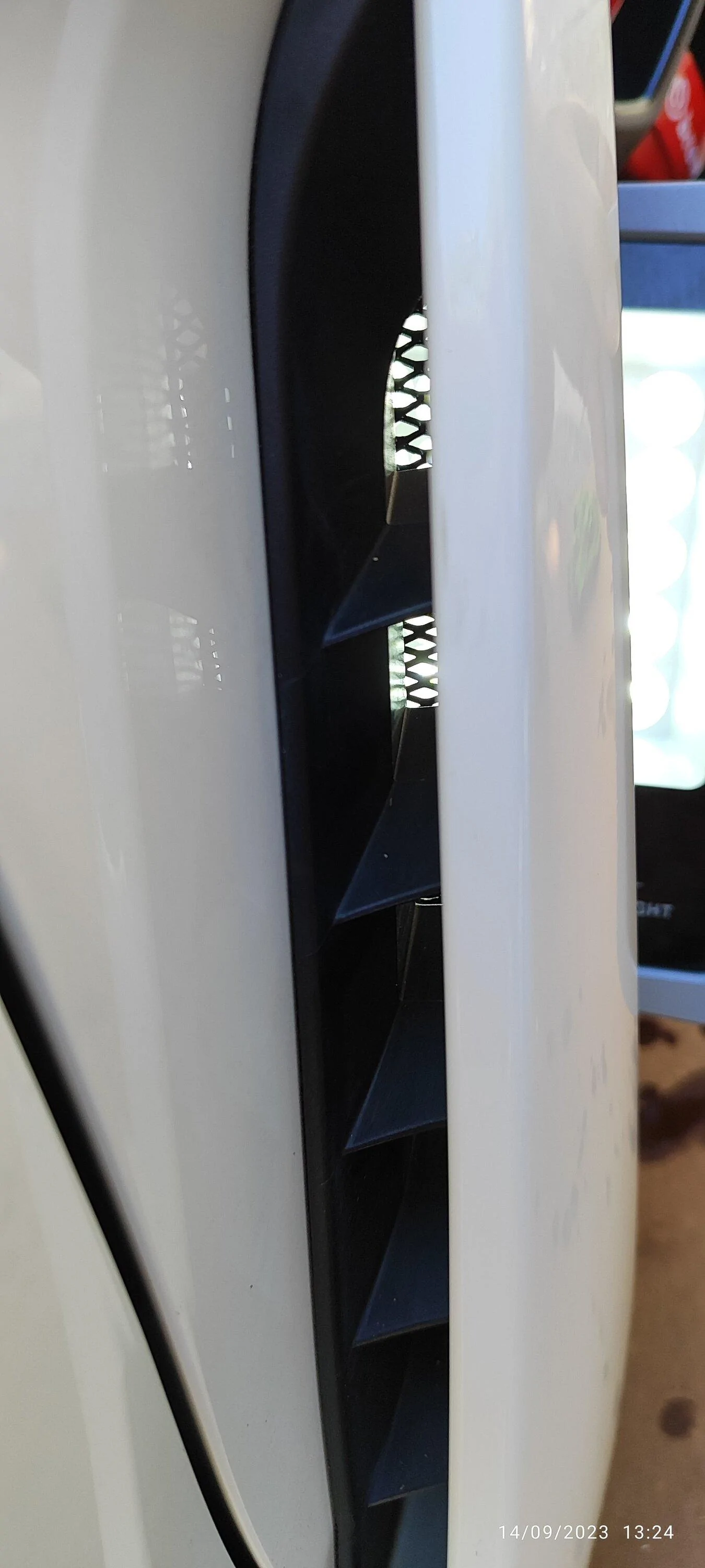

Final results:
Aluminium mesh 100cmx33cms. 23 eur Amazon. About three sets complete couples.
News Clips, four Honda OEM 91501-S04-003 reference, 8 eur.
Mesh Type used 4mmx8mm
3mmx6mm would be ok too.
Fixed with the two staples/clips and two of the three available screws.
I think it is a good compromise between protection and correct air flow.
11th Gen Honda Civic Flapfab Stone Guards IMG_20230914_132802
11th Gen Honda Civic Flapfab Stone Guards IMG_20230914_132752
11th Gen Honda Civic Flapfab Stone Guards IMG_20230914_132313
11th Gen Honda Civic Flapfab Stone Guards IMG_20230914_132422
I have seen this home made mod on Facebook. Material is very easy to get on Amazon.
