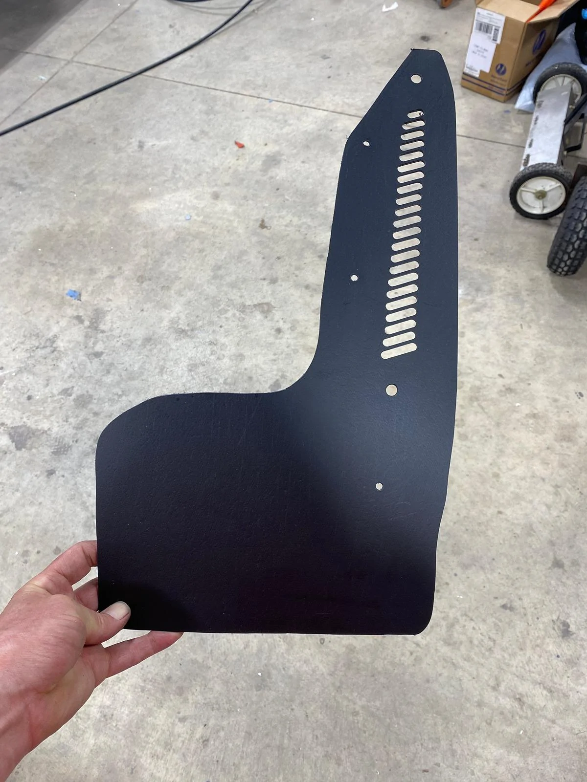

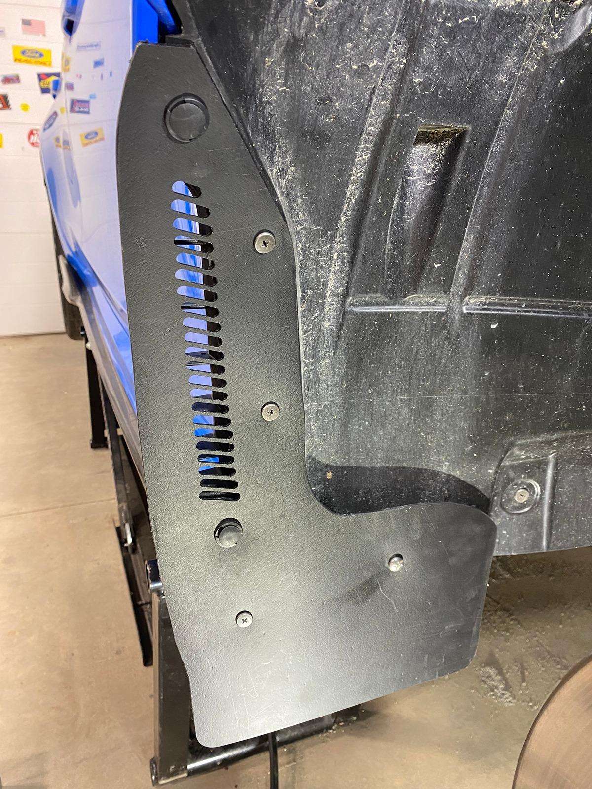

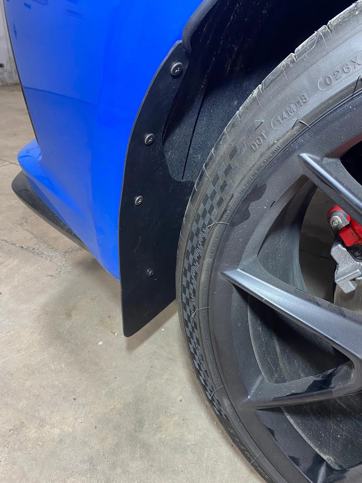

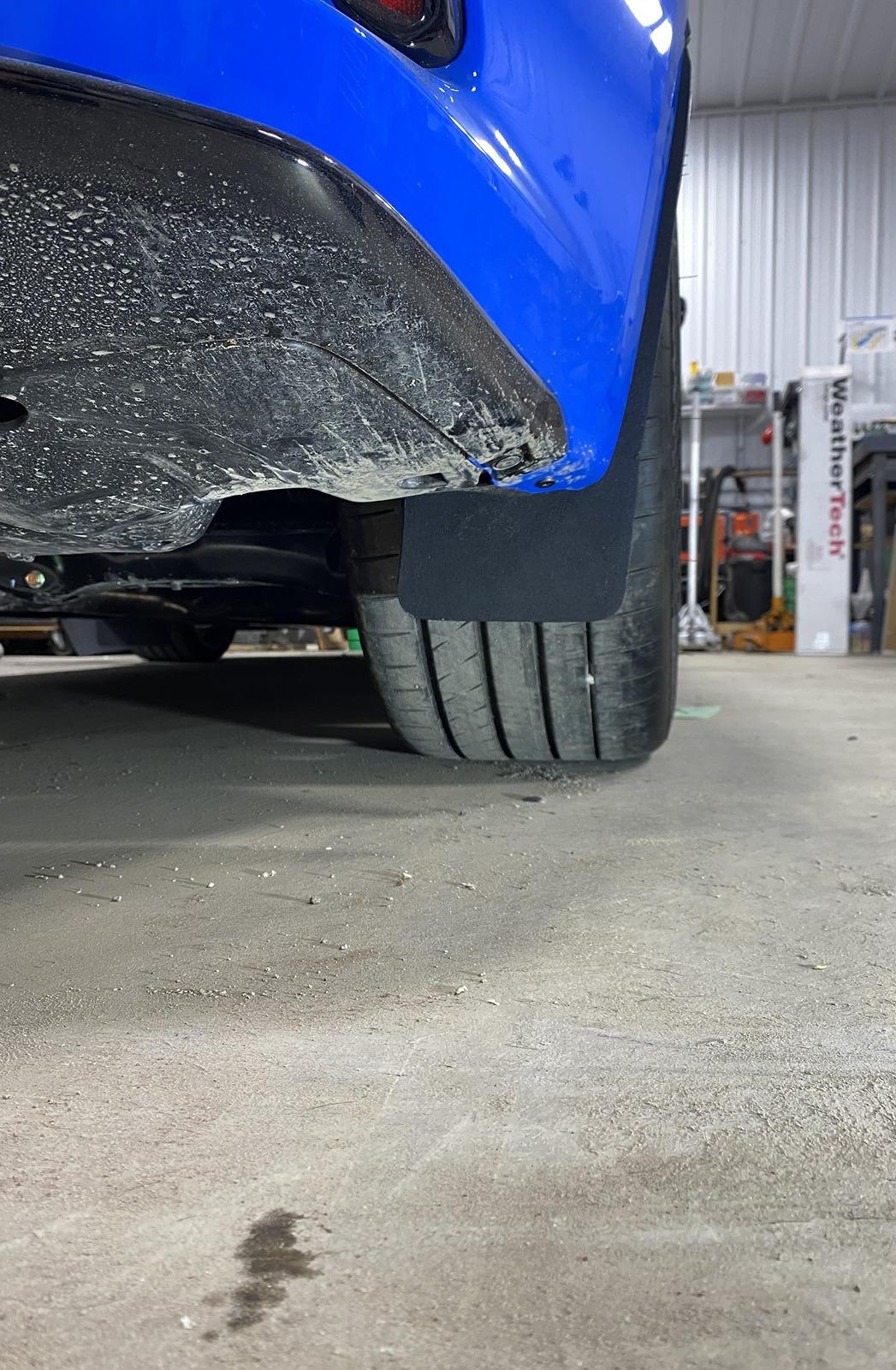

I couldn't find quite what I wanted for splash guards, so I decided to make a set. The worst part was sorting out the fastener pattern, and coming up with a way to add one more fastener to to each piece to keep it from flopping around. I chose HDPE material from Menards which is the same stuff most cutting boards are made from with a 0.1" thick, 24"x36" sheet costing only $20. I'll likely make another set with tweaks to the general shape after I live with the first iteration for a few weeks.
Jim
11th Gen Honda Civic DIY Splash Guards IMG_4526
11th Gen Honda Civic DIY Splash Guards IMG_4525
11th Gen Honda Civic DIY Splash Guards IMG_4527
11th Gen Honda Civic DIY Splash Guards IMG_4539
11th Gen Honda Civic DIY Splash Guards IMG_4538_2

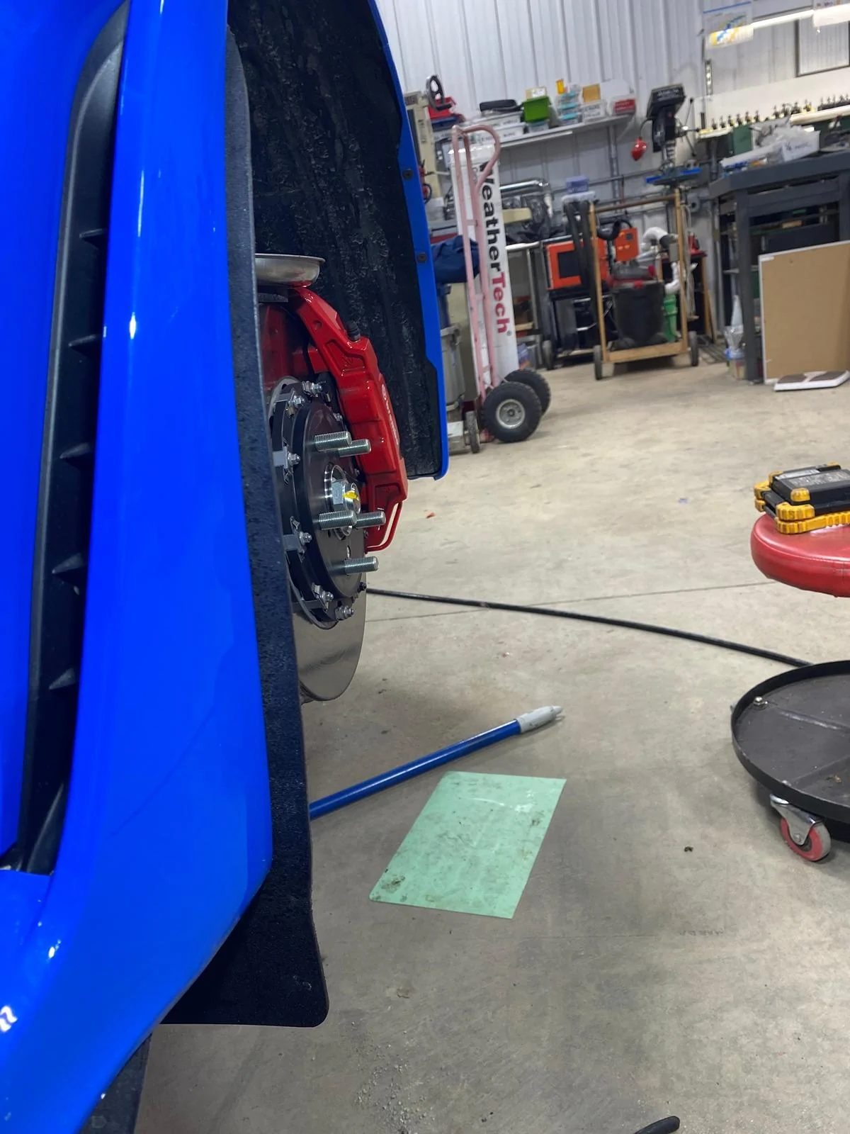

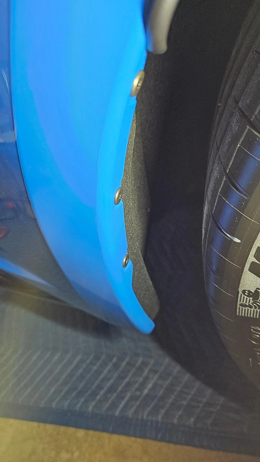

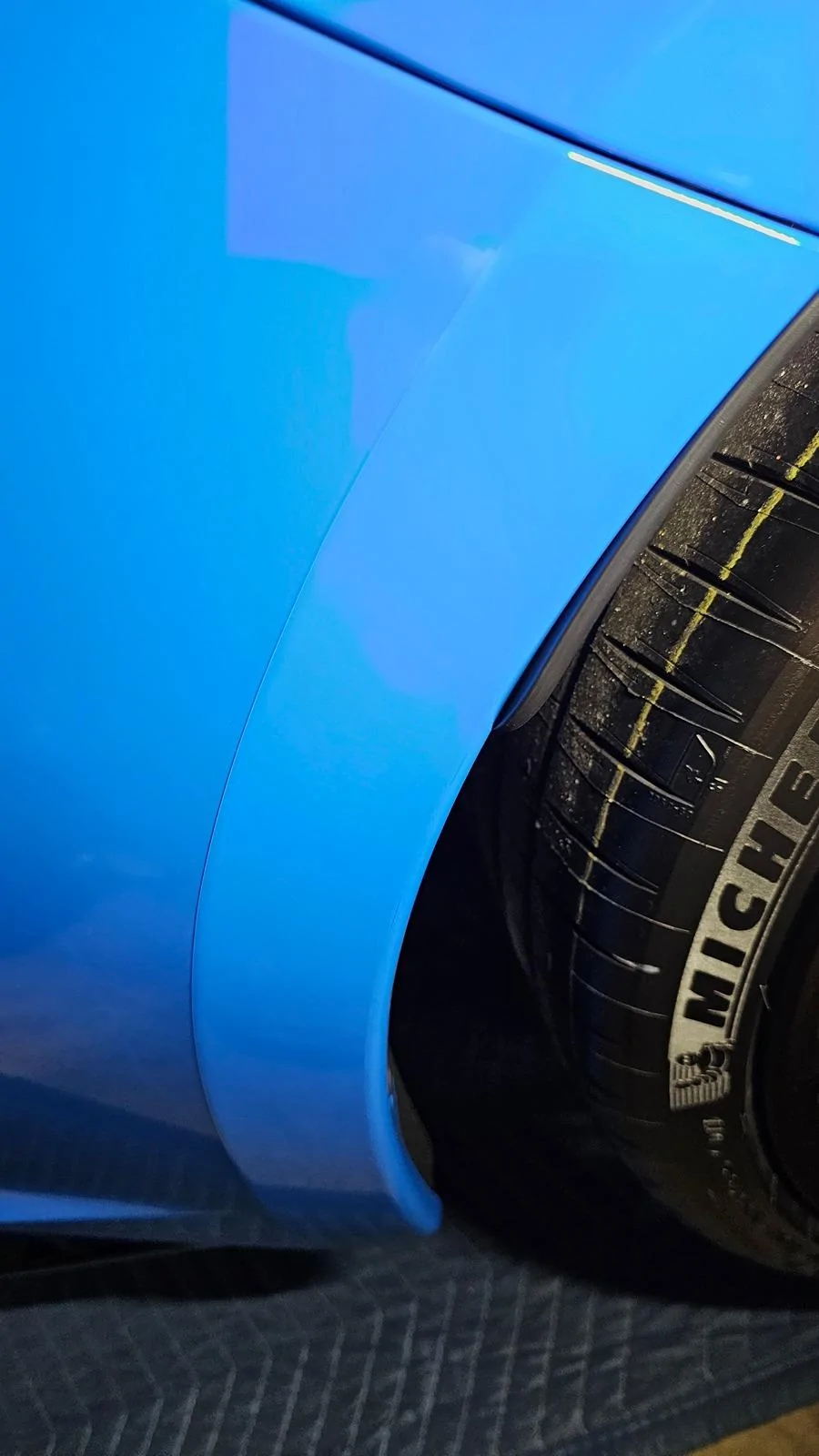

Just had my PPF guy add film to the rear after doing the whole front end in Xpel Ultimate.
11th Gen Honda Civic DIY Splash Guards 20240419_123503
11th Gen Honda Civic DIY Splash Guards 20240419_123526
11th Gen Honda Civic DIY Splash Guards 20240419_123433
11th Gen Honda Civic DIY Splash Guards 20240419_123535

Nice, I like the cleaner look of PPF over mudflaps, but I have a short bit of gravel to cover to reach the pavement so I went with the flaps to eliminate any mud slinging.
