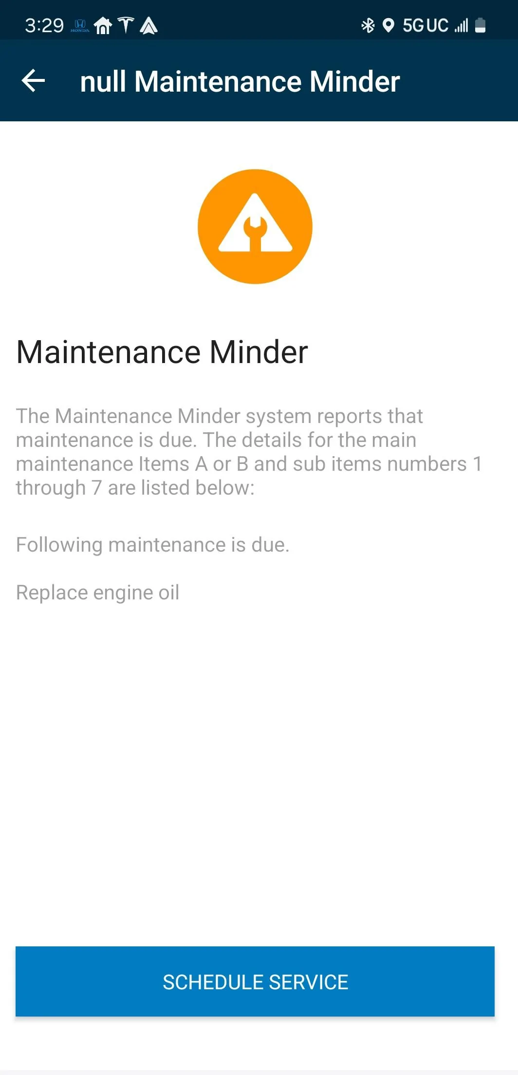

The A1 Maintenance Minder came on last week at 651 miles and I had the oil changed this week. The Carbon fiber wing will also be replaced under warranty due to a clear coat issue.
11th Gen Honda Civic First FL5 oil change mileage? 1000020002
11th Gen Honda Civic First FL5 oil change mileage? Screenshot_20240216_152942_HondaLink
Jester04
Aug 8, 2023
2,005
2,577
All of us who purchased ~one year ago should have the maintenance minder going off for oil now. I just ordered Pennzoil Ultra Plat and a Fram Ultra filter. Not utilizing the free oil change because my dealership is known to be careless with vehicles during the oil changes, so I’d rather just do it myself. Have a Fumoto valve to put on, too.
I do not have this app! Where do I get it?
