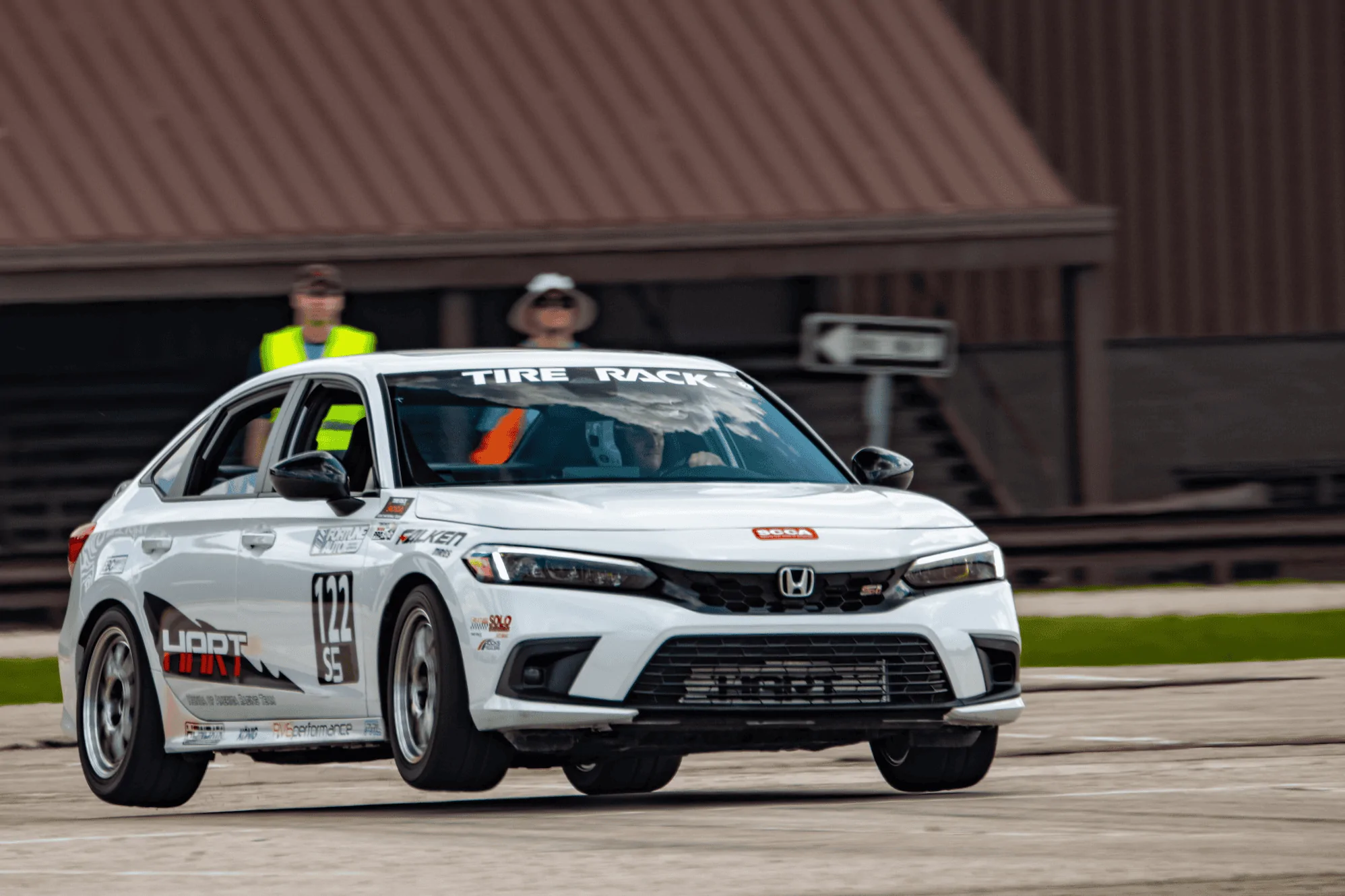

Just wanted to contribute to this thread since I autocross my car regularly. I’m running in STH right now and I seem to easily run first in class at my local events against various Focus STs, golf GTIs and WRXs. I’m running 245 RT660 tires on Enkei rims 18x8 +35. I have also been using the RV6 rear sway bar on the stiffest setting which is around 1300ft lbs since I’m still in stock suspension. The car went from very turn in understeer to almost too much oversteer which I really like. The RV6 rear bar provides and incredible amount of rotation at the expense of a very harsh ride. I just installed a set of SPC adjustable lower ball joints to add more negative camber to the front for next months event.
How camber were you able to get with the ball joints?

Front is at -1.1 now the ball joints give you -1 degree of camber
Do you have the alignment pics pulled on the top strut? 1.1* feels low if the ball joint adds 1*. You should be .5-.7 with the pins pulled so ~1.5* with the ball joint I would think.

Yea agreed. I have my pins pulled and I'm at -0.9. So with ball joint it would put me at -1.9. Still not great...but better than normal lol.

Yes I pulled the pins and asked the alignment shop to move the strut tower. They showed me how much you get and it’s like .1 degree of adjustment it’s not much so I didn’t bother with it. I’m going to have to look into coilovers for more camber adjustment
