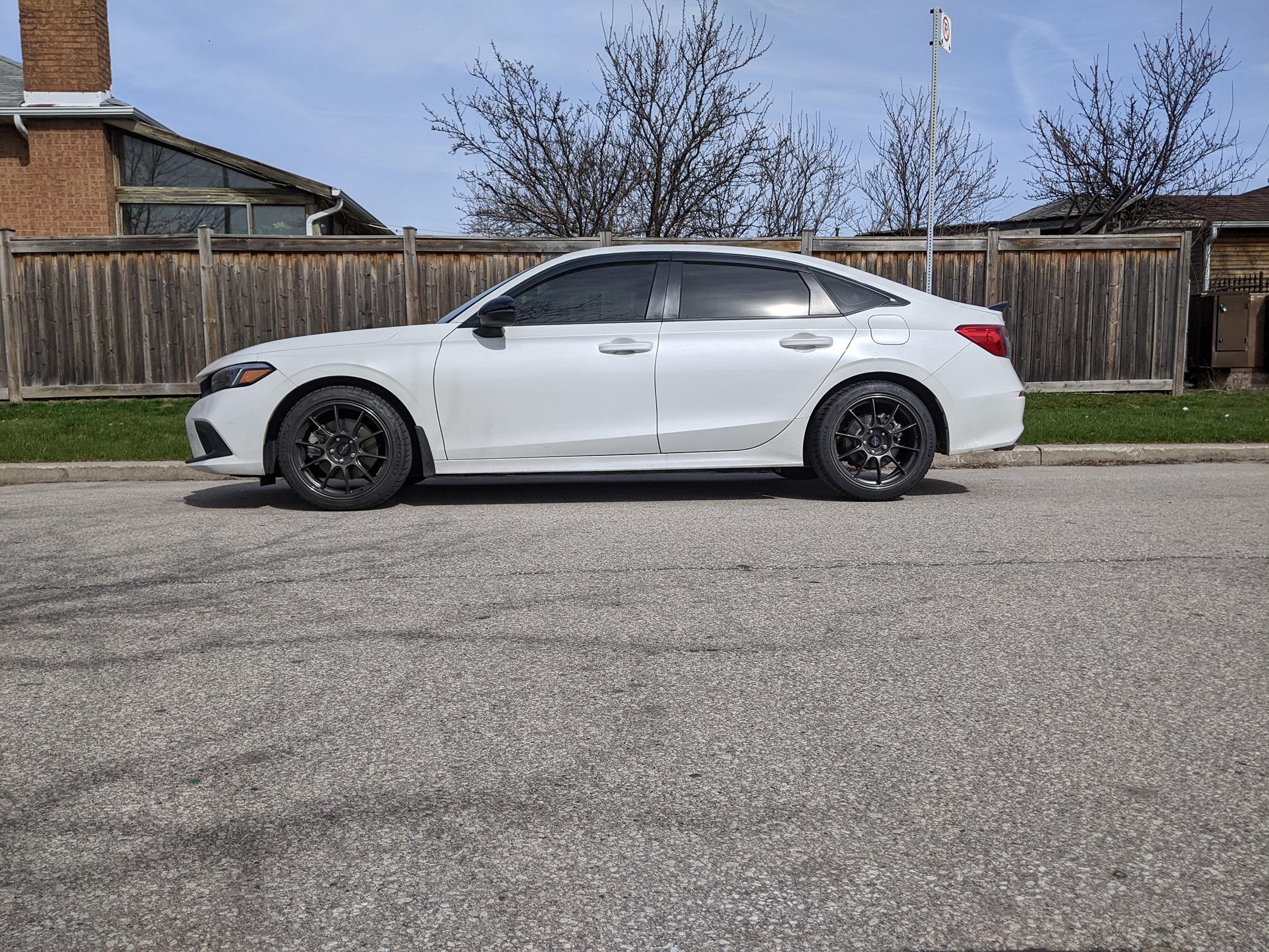

Thanks for the pic. Is the road slightly downhill?
Petty sure mine is higher in the front compared to rear.
I'll take a picture if I drive it to work tomorrow.

11th Gen Honda Civic 2023 Civic Si Spring Rates, Motion Ratio, Ride Frequencies, Autocross PXL_20240112_203407958
Forgot about this one I took not too long after install.
Maybe I should take another one in the same spot...
It’s up slightly. So slanted up from left to right.

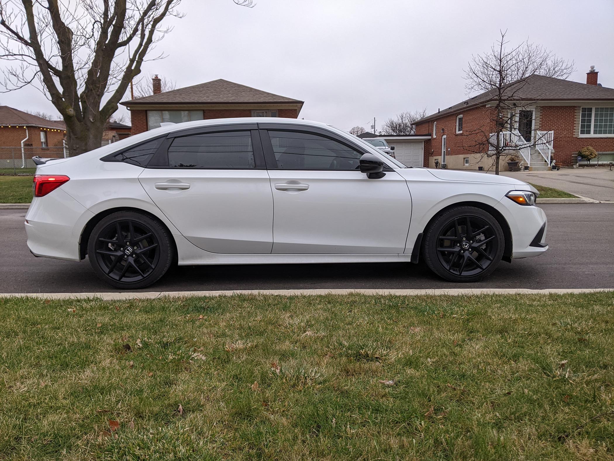

According to these pictures I took today it seems to have settled in the meantime...
11th Gen Honda Civic 2023 Civic Si Spring Rates, Motion Ratio, Ride Frequencies, Autocross PXL_20240410_195340419
11th Gen Honda Civic 2023 Civic Si Spring Rates, Motion Ratio, Ride Frequencies, Autocross PXL_20240410_195707388

Yeah that actually looks good. Can’t find any FK8 springs near me only FL5 unfortunately.
Got mine used on Marketplace. I'd love to try the ones I mentioned before. These are a bit bouncy on real rough roads.
