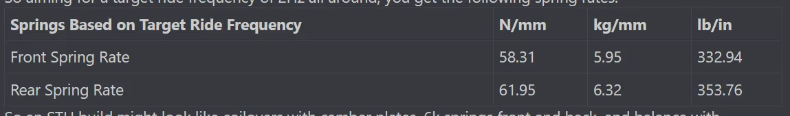

If you look into the swift springs for the FL5, they are a little bit stiffer than what you considered, but still, very close.
11th Gen Honda Civic 2023 Civic Si Spring Rates, Motion Ratio, Ride Frequencies, Autocross 1705191108393
11th Gen Honda Civic 2023 Civic Si Spring Rates, Motion Ratio, Ride Frequencies, Autocross 1705191055035
