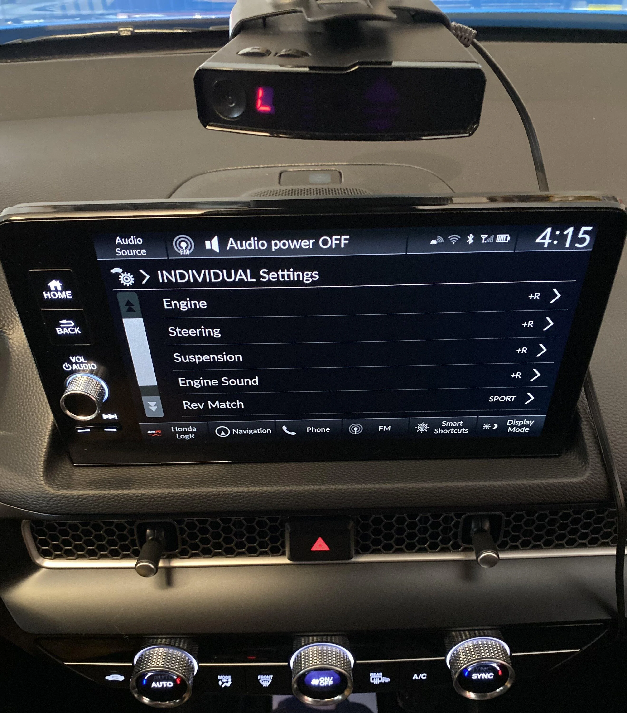

CTR
Dec 3, 2015
833
964
WA
strixauto.com
2023 Civic Type R, 2020 GX460
Engine: +R
Steering: Sport
Suspension: Comfort
Engine Sound: Sport
Rev Match: Sport
Gauge: Sport
I'm really glad that we have an Individual mode! Being forced to choose would always feel like a sacrifice. This mode is a huge thing that the FL5 has over the FK8 that doesn't get mentioned enough.
At first I really liked the Comfort steering but I think that the heavier steering in Sport seems to help with torque steer in wet road conditions so I'm giving it a try.

When you select the engine noise setting the exhaust highlights. So it would make sense it affects the valve.
Also, if it just took turning the engine sound to comfort to disable the fake noise while still having the valve open, why would people be looking to manually disable the sound. Doesn’t add up.
