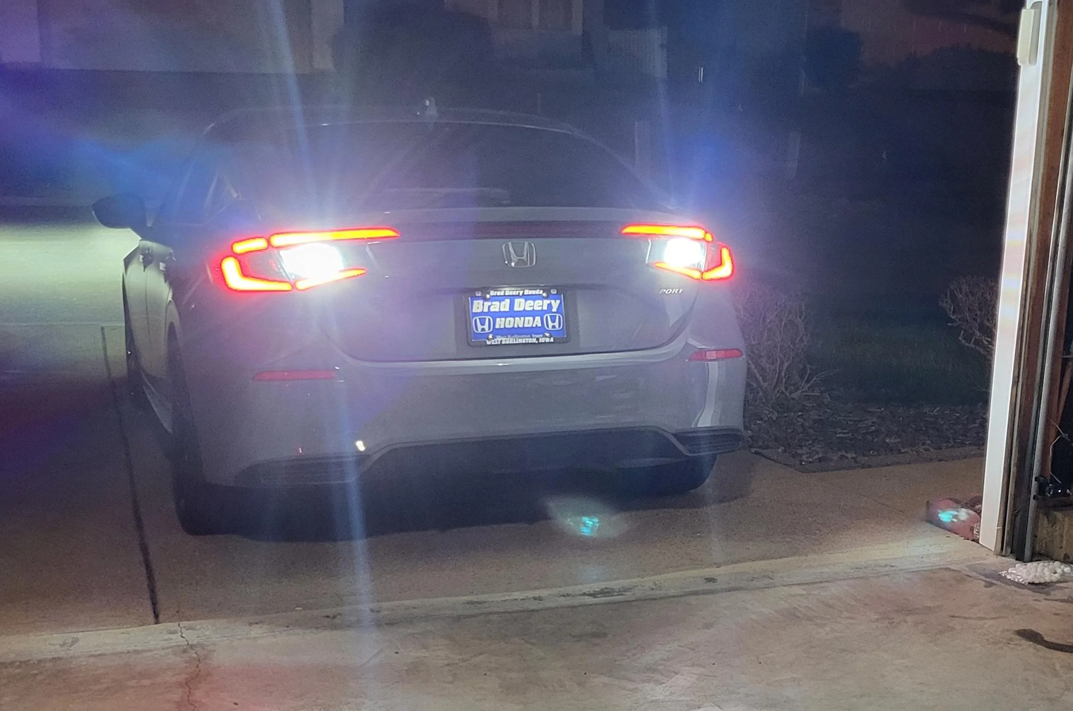

Lastly, I replaced the stock reverse lights with the VLEDS V6 Extrme 921 bulbs I had on my 10th gen. I tried the install when the car first arrived. However, when following the instructions, the bulb was too small to take place of the socket. When using the included spacer collar, it was too big!
After talking to customer support, with one of the employees actually having a Civic hatch to test, they said to twist the screws out two rotations. That worked, but scraped a bit of the chrome in the assembly.

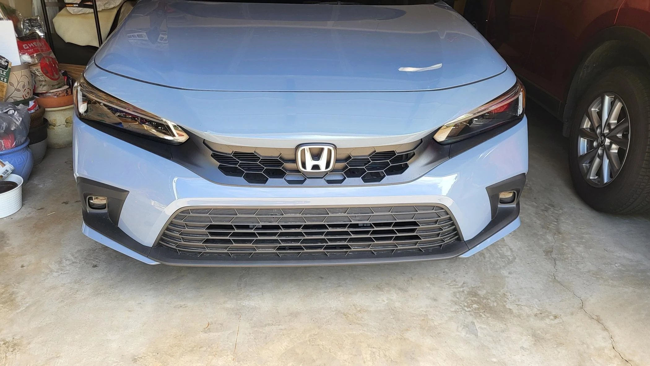

This is what happens when I look at the internet. Thanks to the FL5 section of this forum, I opted to remove my front plate mount. And I was only looking for the size of the rear plate screws!
11th Gen Honda Civic What did you do to your CivicXI today?? 20240420_134925
You can just see the holes in the front grill.
11th Gen Honda Civic What did you do to your CivicXI today?? 20240420_134931
Unfortunately, I live in a two-plate state. So I ordered the front plate mount from Kollektiv Werks.

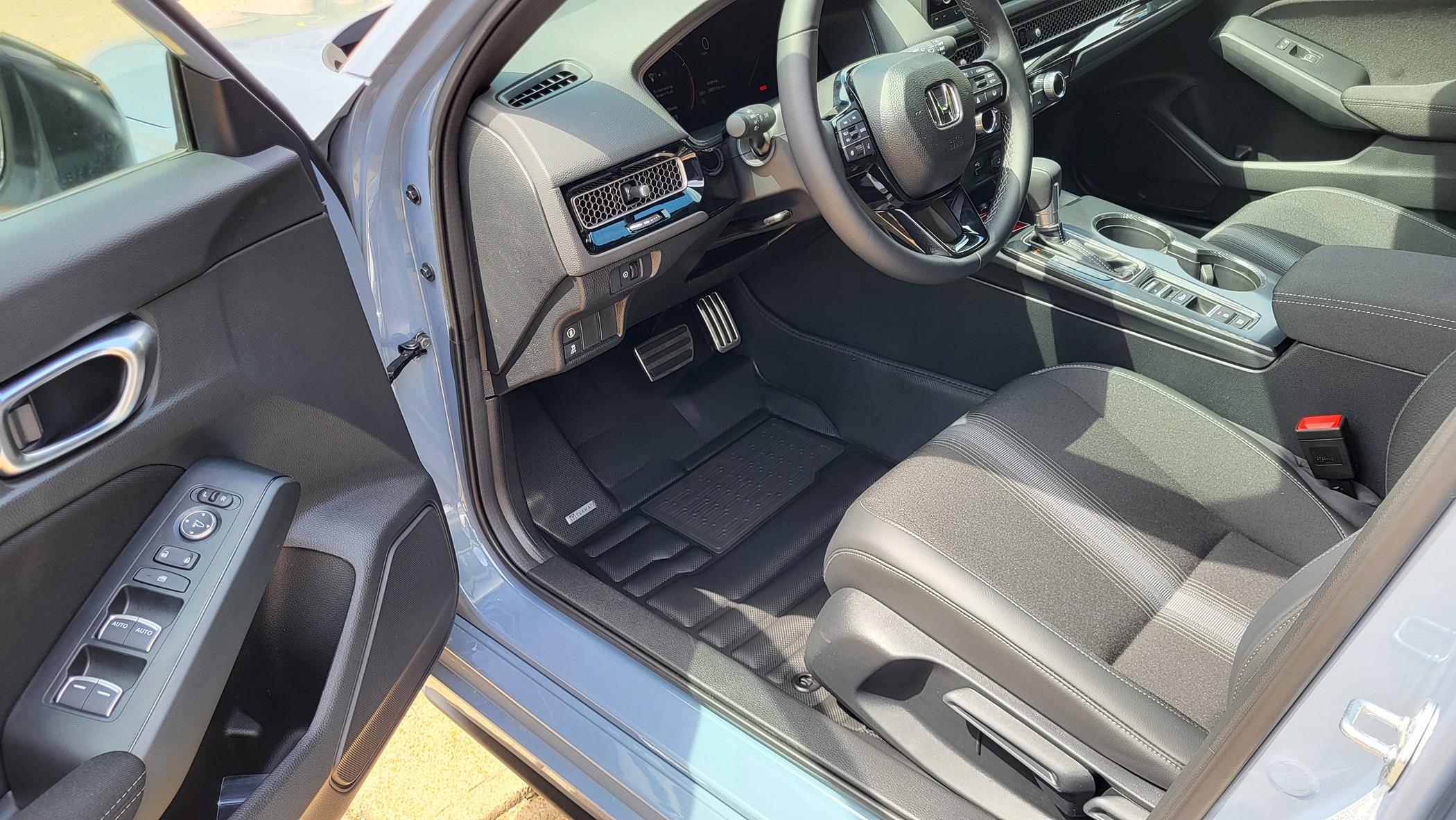

And my order of Tuxmats from @Unity Performance came earlier than expected! Coverage is great and I didn't even need to use the clips.

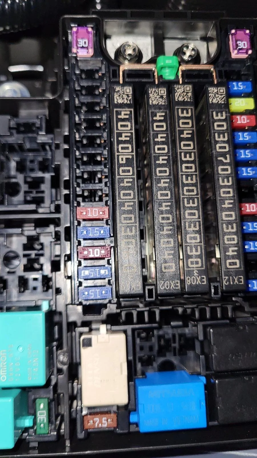

Big heads up. Please don't be like me.
While backing into a spot, the car immediately told me to put in "park." When I did, the instruments went dark and the car was locked into park. I ended up using the shift lock release to change gear. I called the dealer, thinking something else caused the issue. There was availability on the day. That was my first mistake.
I don't know why, but these LED bulbs blew two fuses on the BCM. The VLEDS have less wattage than the stock incandescent. Ditto the i-LED.
Dealer replaced one 15-amp fuse and all the rear bulbs. And caused $+450 bill due to the aftermarket parts.
I know it's a different car, but these were fine on my 10th gen.
That doesn't make any sense for something that draws less power to be the cause of the blown fuse, they normally blow because of more power. I've had LasFit LEDs since I bought my car and they draw less power. Did you mod anything else?
The only other thing I can think of is the Idlestopper. Plus my Motorola MA1 in the USB port. I haven't done anything else. I contacted VLEDs and they can test the bulbs to see if something is wrong.
Now I'm worried about my future fog light and horn install.
I have the Idelstopper as well. Something seems weird. Hopefully they can give you an answer.

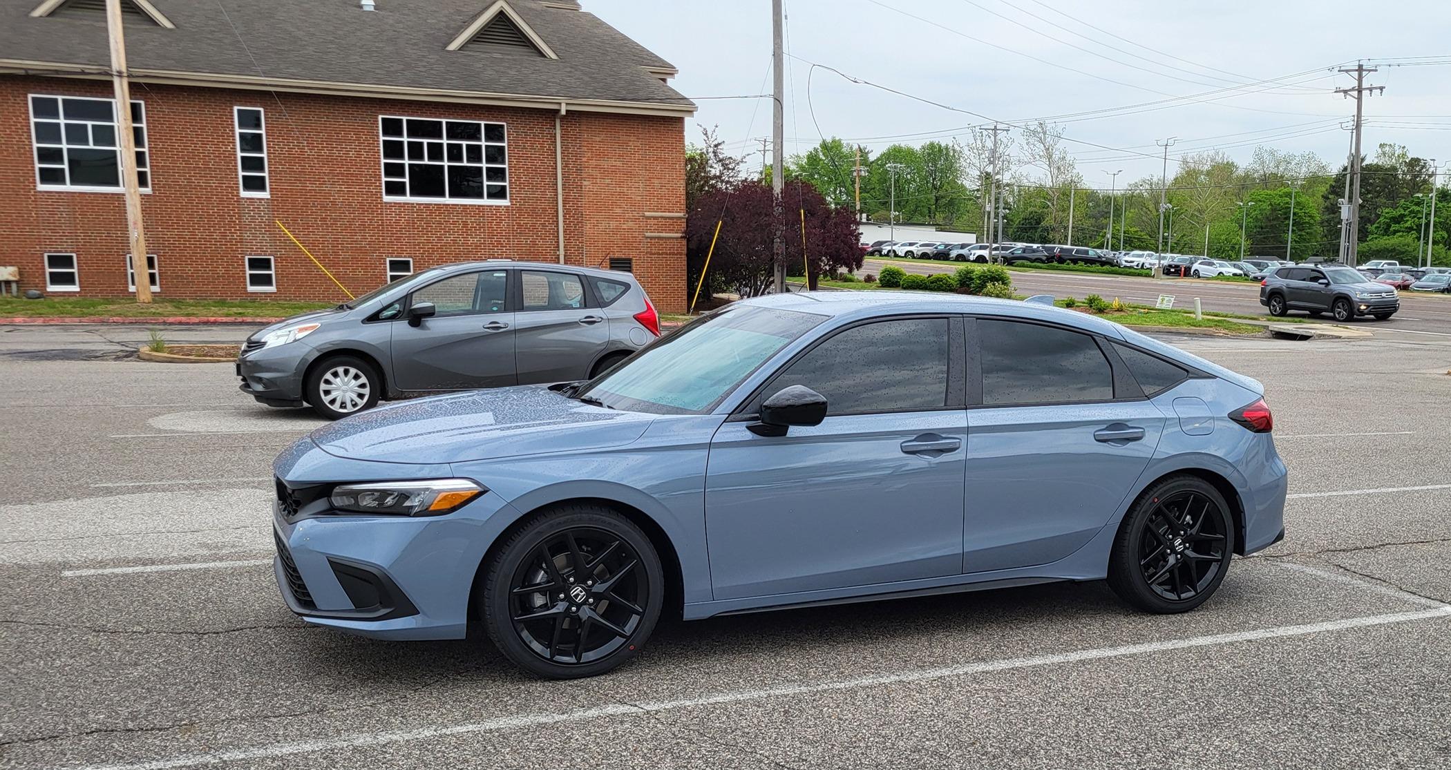

Finally had my windows tinted. No more fish bowl!
I had 20 percent around, clear tint on the windshield, and five percent window strip done. However, since I bought this car out of state, and that state puts their temporary tags on the rear window, coupled with the lack of a front plate, I may be a temporary cop magnet until the tint cures for me to put back the temp tags.
11th Gen Honda Civic What did you do to your CivicXI today?? 20240426_113133
Though, I suspect this is due to the application process for the rear window, water seeped out of the interior trunk panels. I was aware of leaks in the hatchback. But this car has been through a car wash and a downpour. No leaks were present, nor was their a build up of water in the spare tire well. Hopefully that's the case.
Yeah, its normal for water to come out of the hatch panel after getting tint done.

Well, I tried to swap my horns, only for them not to work. Now I have an Idle stop issue on the guage cluster. Would disconnecting the battery help?
Edit: New horn fuse fixed the issue! Looks like someone else will do this install. Though I will definitely disconnect the battery for the Homelink install.

You keep having issues with fuses blowing. I feel like there might be a loose ground or something causing stuff to short.
I feel like the dealer would have chased that the first time it happened. Though they did cost me money in the end. In this case, the fuse popped when I went to test the lower horn. The only thing that happend was the stock horn momentarily beeped until the fused popped.
Though the Littlefuse LP mini is a darker shade than the one from factory. If I remember, I can always buy one from the dealer parts department.

At least the car wasn't bricked this time. Trying to follow all tutorial videos, it seems something goes wrong during my install. Though, my replacement LED cargo light works fine!
It's too early for Halloween. But I guess my 10th gen is haunting me! The day I went to sell that car, it did not want to start. I discovered the negative terminal was loose by a body shop who did the repairs. Once my old FC2 was at Carmax, the second key fob battery was dead.
I may be rambling, but intrusive thoughts lead me to look at the battery. And I discovered that the positive terminal was loose. As in, the nut was at the end of the bolt. That may have contributed to some parasitic effect. Now, whether or not that contributed to my replacement LEDs to pop fuses, I can only guess.

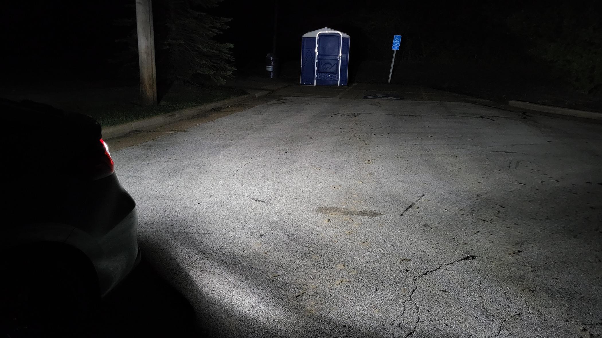

But I'm not taking any chances. To keep on topic, I installed the Diode Dynamics XPR bulbs. Unlike the VLEDS, they're direct replacement. While not as bright, they're bright enough.
