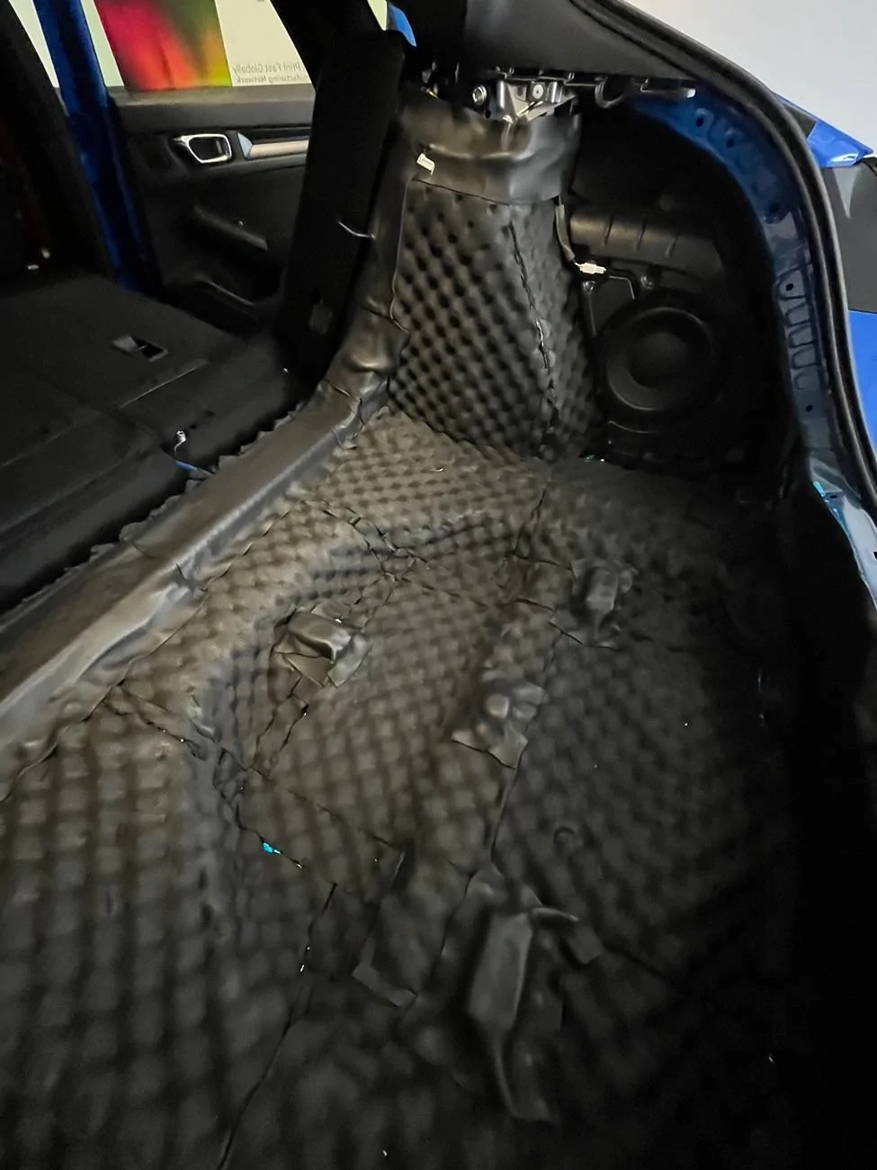

1st) Do the trunk and rear inside wheel wells. This is the easiest and this will help the most, as the rear wheel wells are the only wheel wells that are inside the cabin of the car. The front wheel wells are not inside the cabin.
This is very easy to do, but make sure you first apply the Amazon Dampener, and then two layers of the 4mm foam, and MAKE SURE YOU BLANKET the entire wheel wells and everything else. After I went back and fully covered the wheel well the sound did go down further. This is the biggest culprit probably in filling the cabin full of noise.

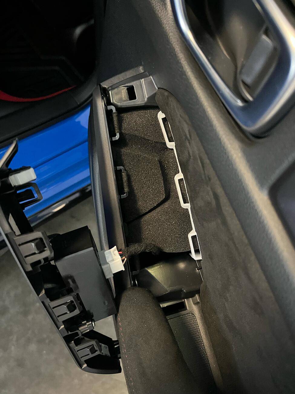

2nd) Do the doors. Next easiest, but maybe you can simply get away with closing off the inner doors with this 4mm close cell foam.
This is probably worth a shot, if you can simply seal this sound off on the inside of the door, you'll save yourself a lot of time and really no weight will be added to the door. This 4mm stuff is very thin and effective. I would apply it over the entire inside of the door, and over the water membrane.
This is very fast to do, maybe 1 hour, and you can always go back, if it's not enough sound dampening and spend 10x more time/effort to do everything inside the door. I have a feeling, it will perform well if you do something similar to this picture below but cover the entire inside of the door. This material also compresses easy, so you can easily get the door on. Even if you cover the holes, the door will pop on right over it, and the pins will go straight through. Again, I wish I used this instead of the egg crate foam. It was much easier to work with. You can use a single layer on the inside doors, and if you do want to amazon deaden and dampen the body panel, then cover it with 2 layers of this 4mm, but again I think it's worth just trying to get away with a single layer, like this photo below... And use amazon deadener and a double layer of this 4mm closed cell foam, 8mm, on the trunk, wheel wells 4mm 1 layer, 8mm every where else you can.

After I did all this, I had forgotten about some of the rear wheel wells, and I went back, and did that, and the sound improved in the cabin, so I am comfortable saying the Trunk, rear wheel wells, and while your at it, under the seats is probably the easiest to tackle and most effective.
Be sure to blanket the sound with the foam, especially the entire wheel rear well - this is key.

With the Type R - I would simply pop off the doors, take those large rectangle square, and simply just slap it on over all these wires etc. I'm 99% you will be fine and if you do the inside of the panel, I think you are all set ! Do the inside the door and do the inside the plastic panel, and you're probably gonna be Aces!

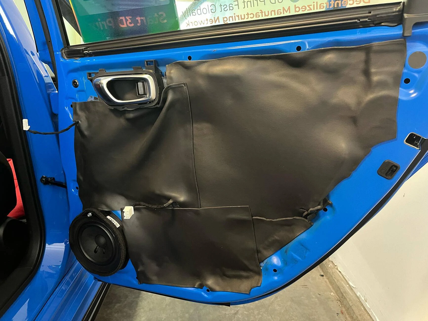

I did the inside of the doors, as I recommended it, and it also helped, and it maybe all you need.
I had done the body panel of doors, which took a lot of work, and really went all out with the Amazon deadener and Egg Crate foam on the outside facing door panel, but I went back and since I had more of this 4mm material I put in on the inside of the door -- it helped additional reduce road noise. My doors are now over over kill.

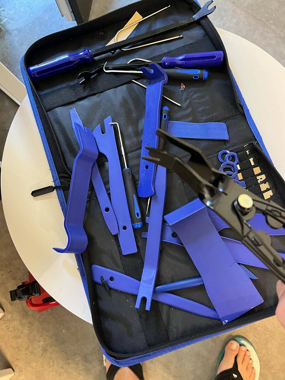

1) For sure get the amazon panel removal kit. I used many of the tools there and it helped tremendously

Panel Kit Tools are important makes life easy when clips don't come off

This worked very very well. I just did it, Maybe it was over kill to do the body panel under here.

Tools are very helpful. A must.

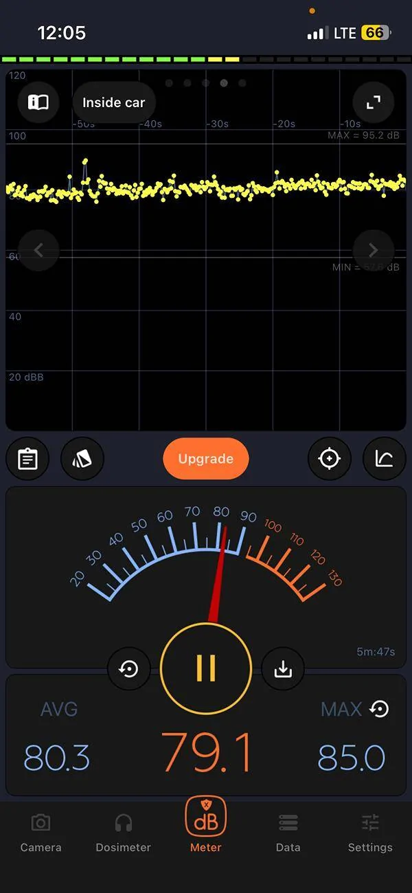

This is at 55mph.
11th Gen Honda Civic Sound Deadening Project IMG_2129
This is at 65mph on 8/10 road highway.
11th Gen Honda Civic Sound Deadening Project IMG_2128

4mm foam sealed door

I had kept this stock, because behind here is the entire outside door panel Amazon Deadened and Egg Crate foam sound insulation. I did notice this did help when I covered it. I would do this first, and maybe that's all you need for the doors.

Went back and completed blanketed areas in trunk with the 4mm in areas I had missed the egg crate foam didn’t fit.
project is probably done - maybe will try to find a type s stock hood sound insulation see if it fits

When I went into the Trunk, I realized FULL BLANKETCOVERAGE is key. Even the trunk area that has some metal showing, just transmitted sound, and today I noticed again it's even better.
BLANKET THE SOUND! Seal the sound out! That's the goal ;) This stuff is super light. If you get more expensive stuff, and can't fully blanket the sound, sound will just travel right around it, and now your project is close to useless.
