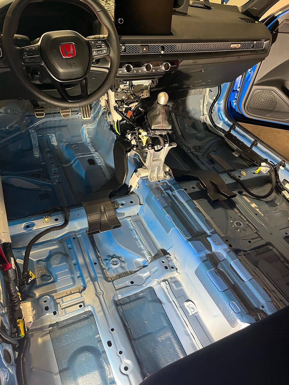

I've started the floor project, stay tuned fellas.
Will it get even better in sound dampening, or be a waste of time/money?
Let's find out..
11th Gen Honda Civic Sound Deadening Project tempImagemPza3M
11th Gen Honda Civic Sound Deadening Project tempImageRtG6Z6

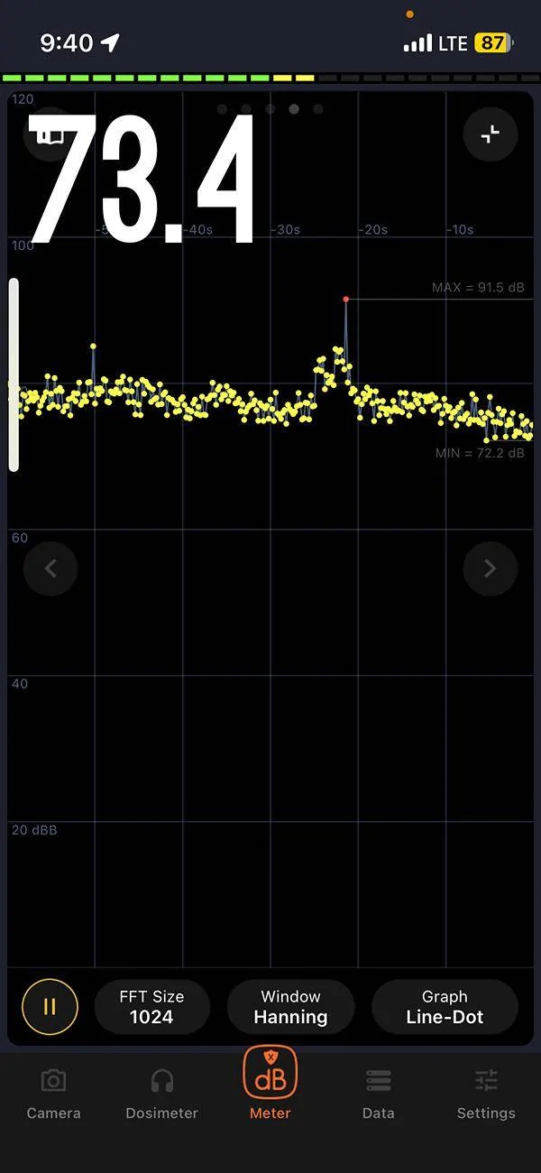

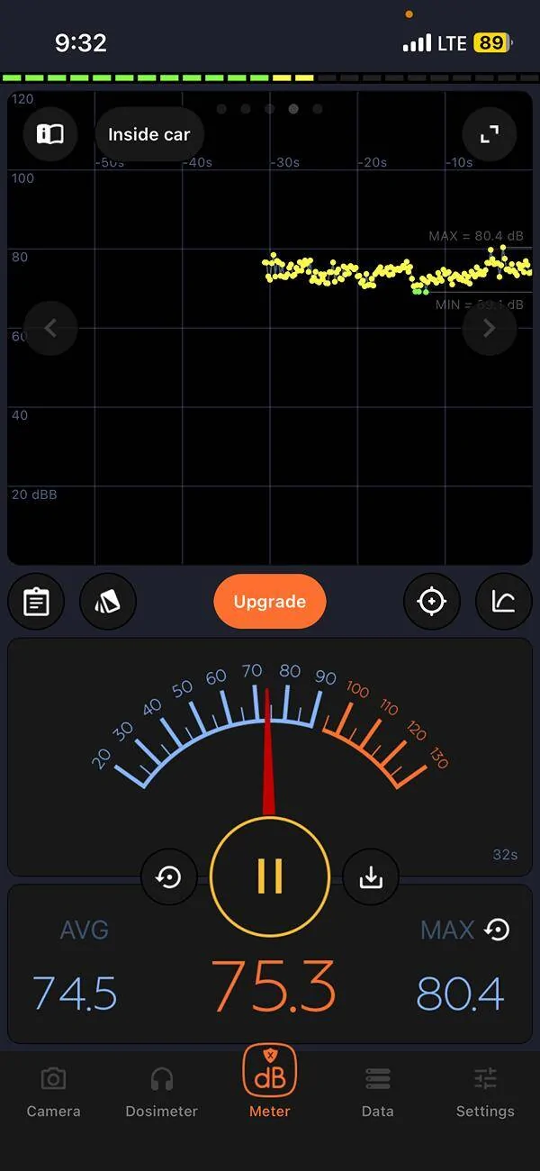

Just took an Uber to the airport, 2024 Tesla model 3 very quiet, very little tire noise, driving on a newly paved like glass road at 65mph — and as a baseline on my drive these are on my same iPhone 13mini—
11th Gen Honda Civic Sound Deadening Project IMG_1755
11th Gen Honda Civic Sound Deadening Project IMG_1754
11th Gen Honda Civic Sound Deadening Project IMG_1758
I’m getting these results.

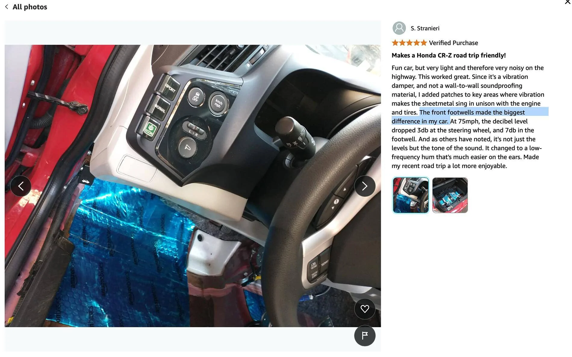

Looks like someone else in a honda CR-Z deadened front foot wells and got excellent results. 7 DB in the foot well is a lot!
