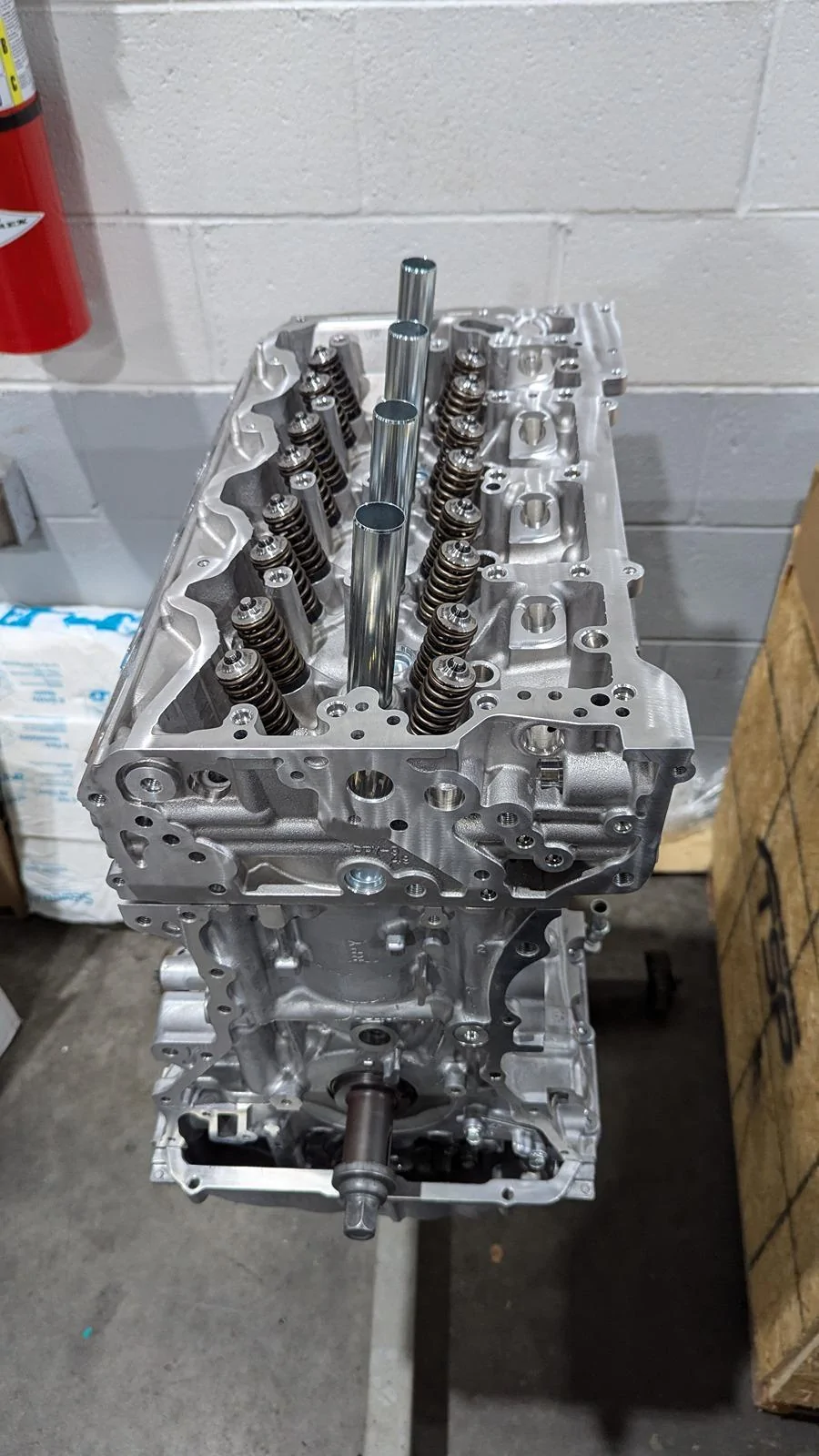

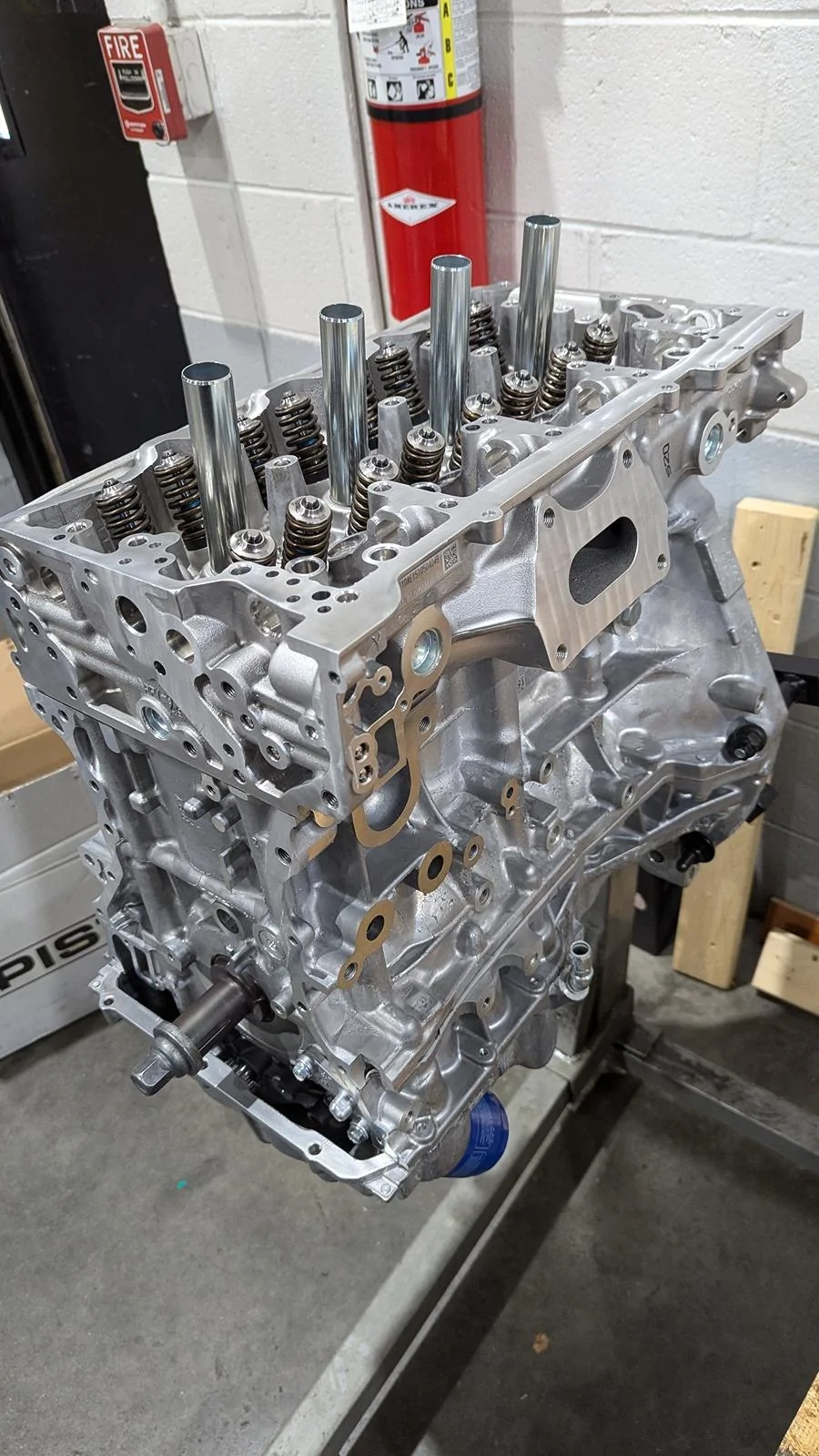

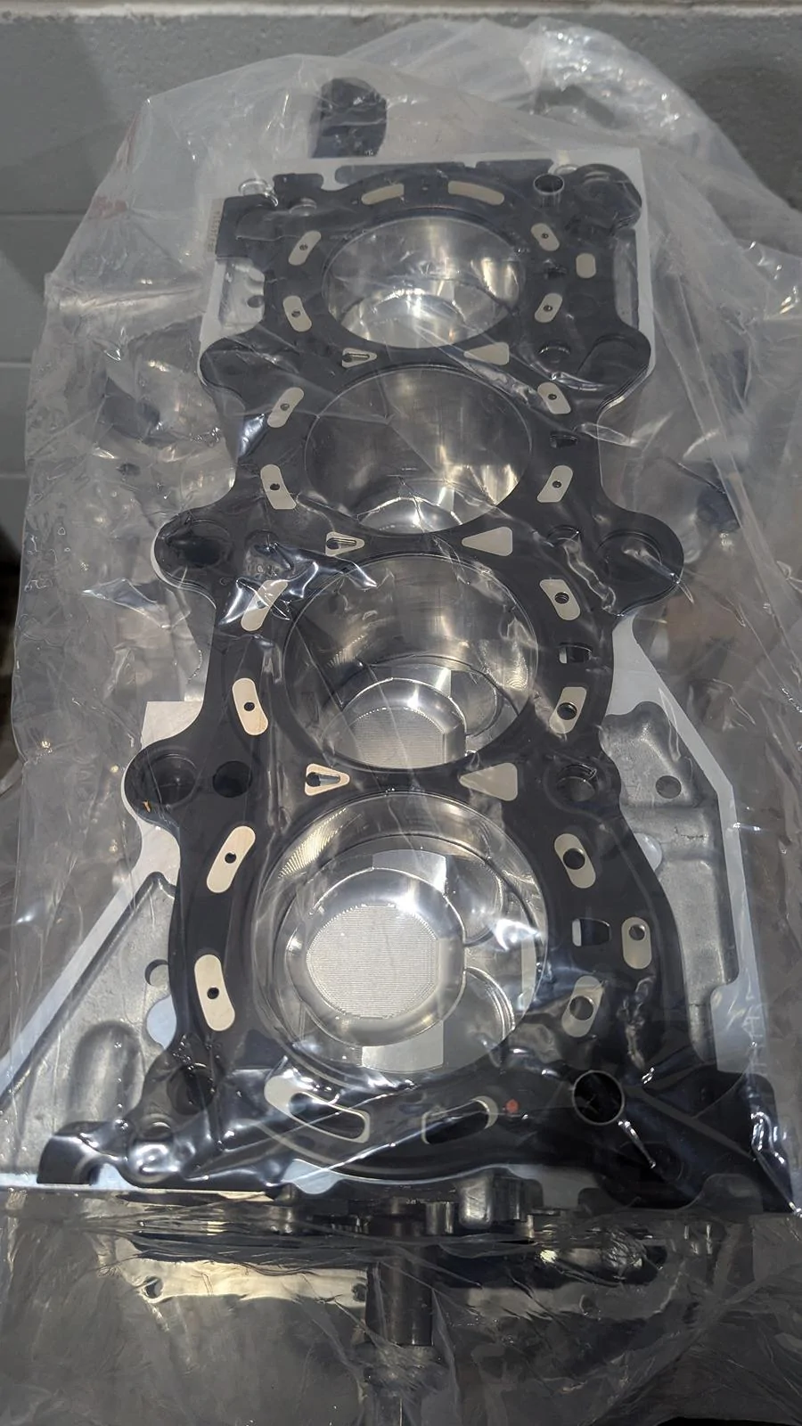

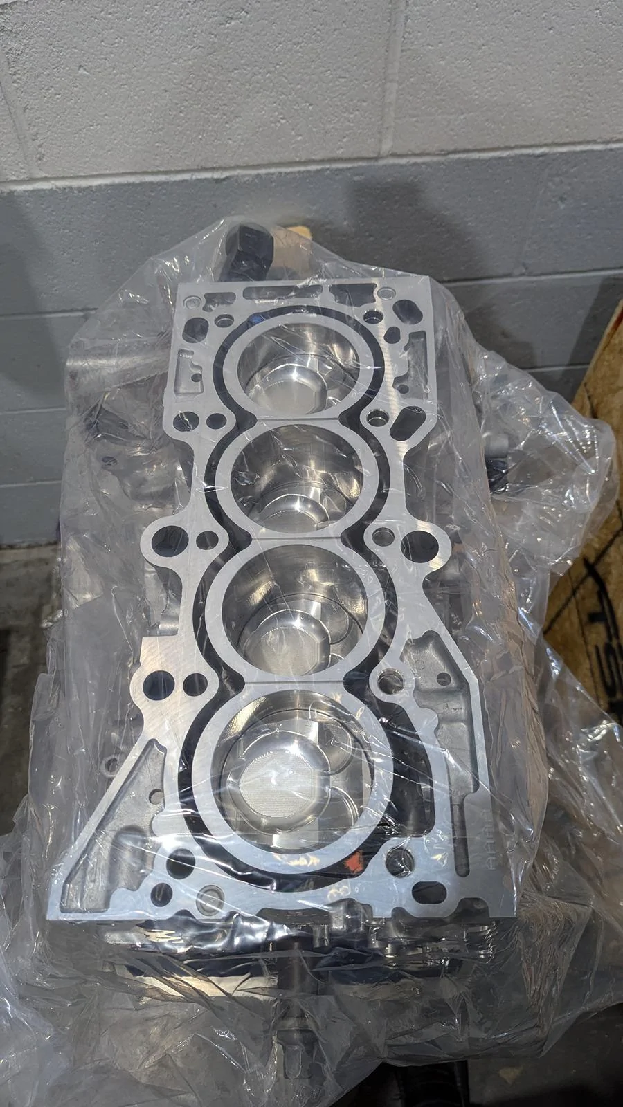

The engine build is tentatively scheduled for this Saturday, provided I can obtain all of the final parts needed for assembly!
Any of you guru's have any recommendations for break-in oil? Something with a high zinc content?
This may be old school, but this has been my process in the past:
First oil fill is with nonsense garbage conventional oil, and is used for the first engine start. After running the engine for a few minutes to burp the coolant you then drain that oil, and replace the filter with a new one, and then fill up with a break-in oil and run on that oil for 500-1000 miles. Then you drain that oil and replace the filter and move on to regular oil.

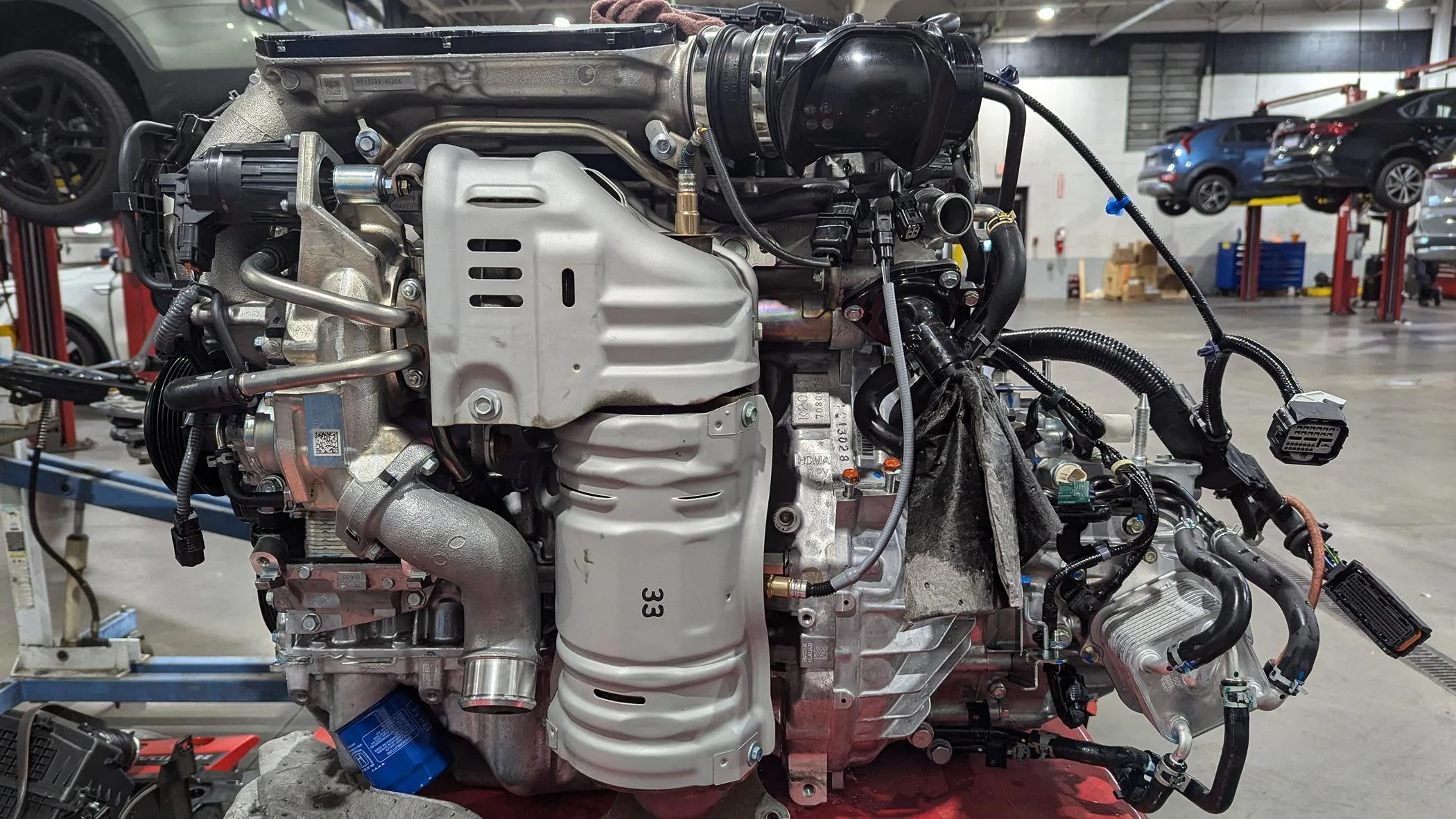

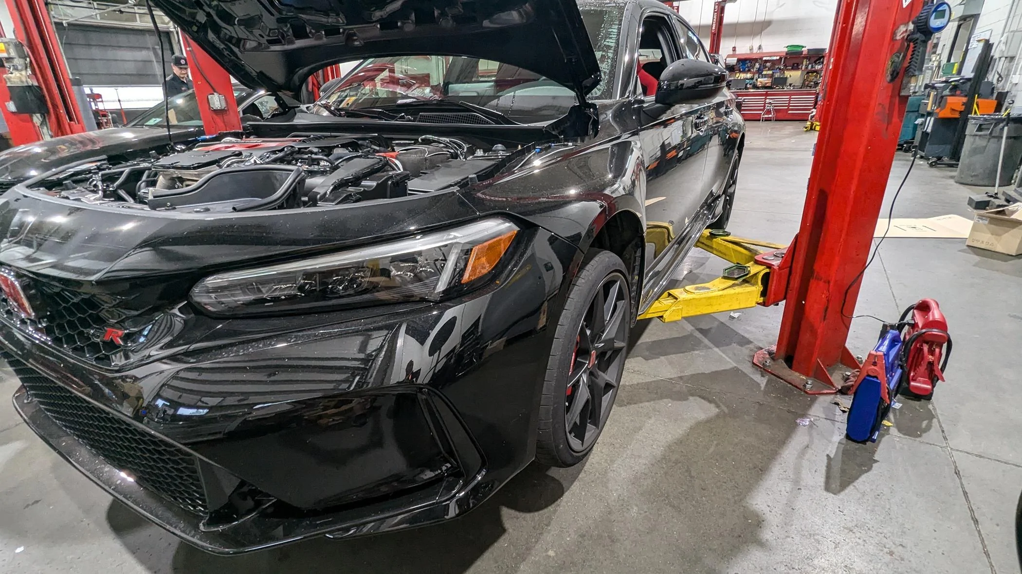

What’s going in today?
Clark_Kent
Nov 19, 2022
3,251
Smallville, KS
You are really pushing this platform forward. Thanks for sharing your journey. We are all benefitting from the good, bad, and ugly.
Maybe I missed it, but can you share the specs of this motor?
