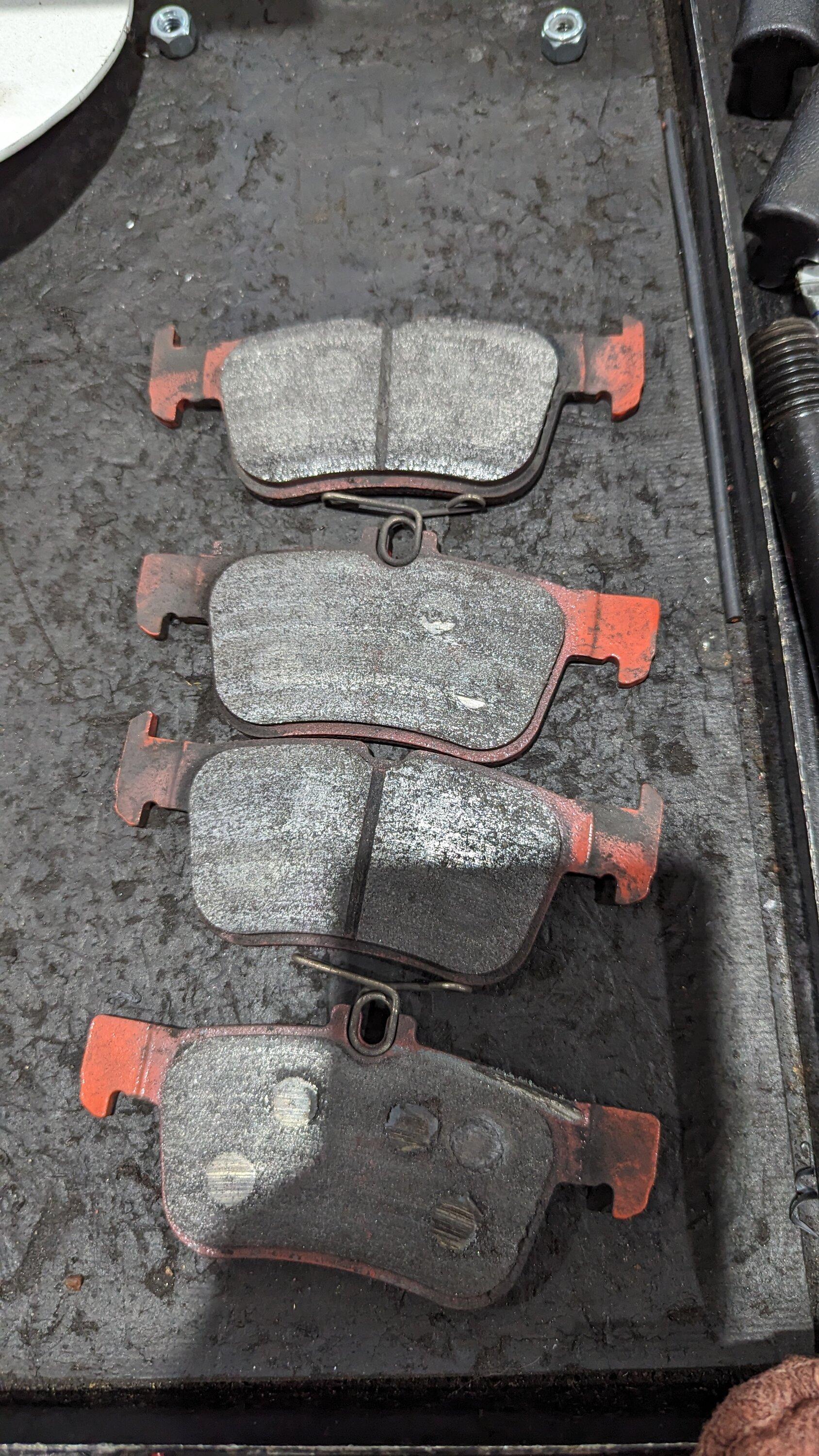

Replaced these R5's in the rear today. The inside pads were shot. Put on a fresh set for the track next weekend. The R5's seem to hold up well on the track, as these rear pads made it through 3-4 events and a few thousand miles of street duty!
11th Gen Honda Civic PointByPatrol #21985 Build Journal! RIP #9243 PXL_20240221_183411748
11th Gen Honda Civic PointByPatrol #21985 Build Journal! RIP #9243 PXL_20240221_183429297
