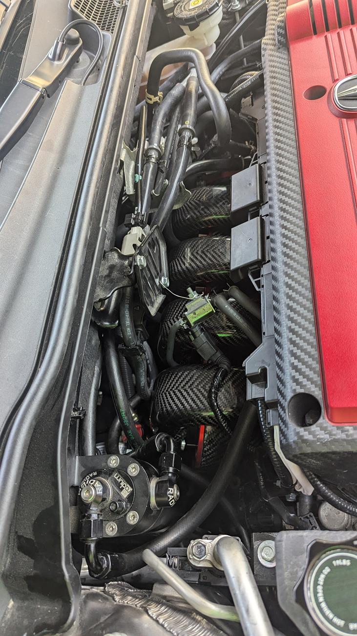

@Jester04 dialing in my latest mods.
Full-race HPFP, XDI 1400 injectors ,and pracworks intake.

Other than the price, what was the downside compared to stock?
@Jester04 told me he helped a buddy install one, and that you have to completely re-do all the vacuum hoses, and that it doesn't come with the parts to do that.

It comes with the parts and hoses and fittings, but there is no way to hold the accessories to the manifold like OEM. @Integra23 can confirm.

Thr only piece that needs rework is the solenoid to the bypass valve. The original mounting bracket can be used and secured to the fuel line cover on the firewall. You will need a longer hose to accomplish this. In the meantime i used safety wire to suspend it.

That is an easy fix, once you have the hose it will look very clean.
