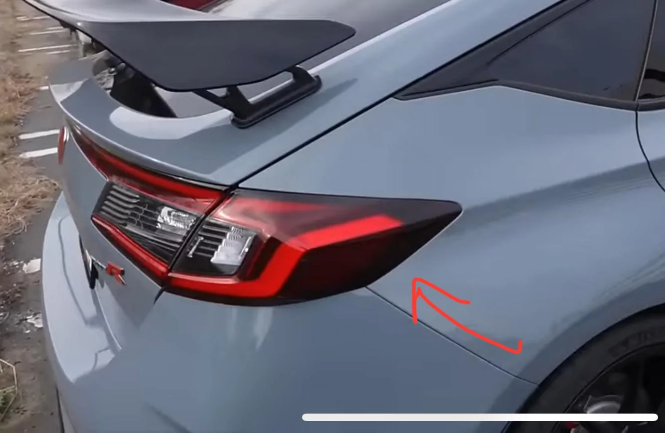

Any pictures of the JDM rear tail lights? I didn't know about that

The difference is so subtle you can miss it. No photos, but here are two videos for each - first two are JDM, second set are USDM. Scrub to the time stamp on each video. What you're looking for is the light passing through the outer tail light on the portion that wraps around the rear fender which essentially creates a sidemarker.
JDM Rear Tails
2:04
5:40
USDM Rear Tails
20:35
25:10
The JDM and USDM headlights are similar with the difference being the amber sidemarker on the USDM car. The clear reflector on the JDM, Euro, and other markets headlights are not a sidemarker. In other words, light does not pass through the clear reflector like it does on the USDM car.

No reflector.
It's not so much a reflector as it is a sidemarker. The tail lights look nearly identical with the lights off. There is a small recess where the light passes through on the USDM version. Once illuminated you can see the difference. It's the same for the headlights. There's a small recess in the amber sidemarker where the light passes through. That same recess does not exist on the JDM headlight. Too much information and a minor detail but there's a distinction nonetheless.
