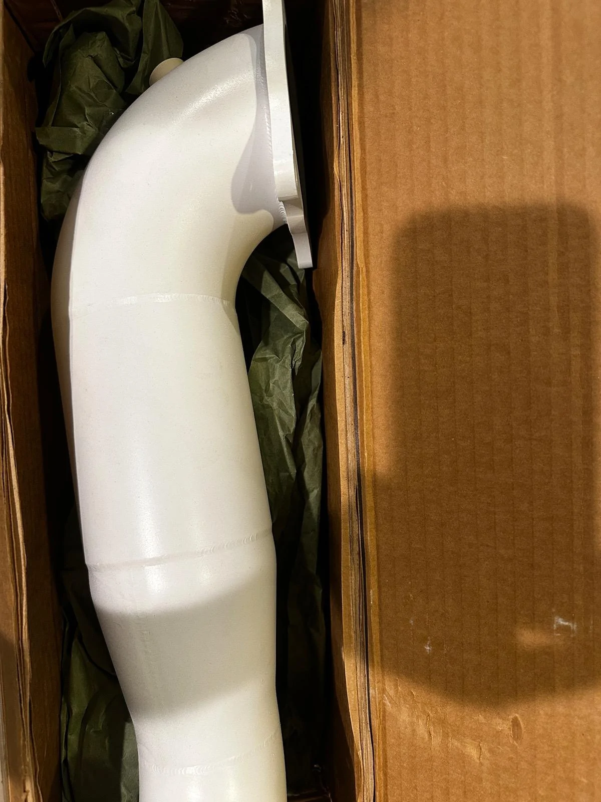

Got my downpipe on this past weekend plus did the valve bypass and I think it sounds good now. Still want it louder but I’ll drive it a while and see. Downpipe definitely bumped the sound up a bit, not a ton but noticeable. After looking at the stock front pipe, that’ll likely be the next step, trouble is some exhaust options have their own design for this so I don’t want to end up limited to only certain types if I chose to do just the frontpipe. Won’t do a slip fit exhaust so that definitely limits options as well.

Not yet, still looking at the exhaust options and not set on one yet. Depending on where I end up there will determine if a frontpipe is needed or not. Not many flanged options out there I like right now…

Do you have any favorites? It can be challenging to ascertain the info I want from a video or audio clip, but I'm not too fond of anything I've encountered. So far, I like best when someone deletes the first resonator and the valve is open.
I'm leaning toward the down pipe and front pipe (from two step, duh) and see what life is like.

I currently love my setup, little louder than stock and for now I’m happy. If I end up going the custom exhaust route I will probably mimic the stock exhaust resonator placements just in a 3 inch version. I do feel the car is starting to choke with my turbo.

Downpipe and stock exhaust, cat is invisible though. ?

The two step one is excellent and no CEL’s. Plus you get a bit more tone. Less than a catless but there is still an improvement.
