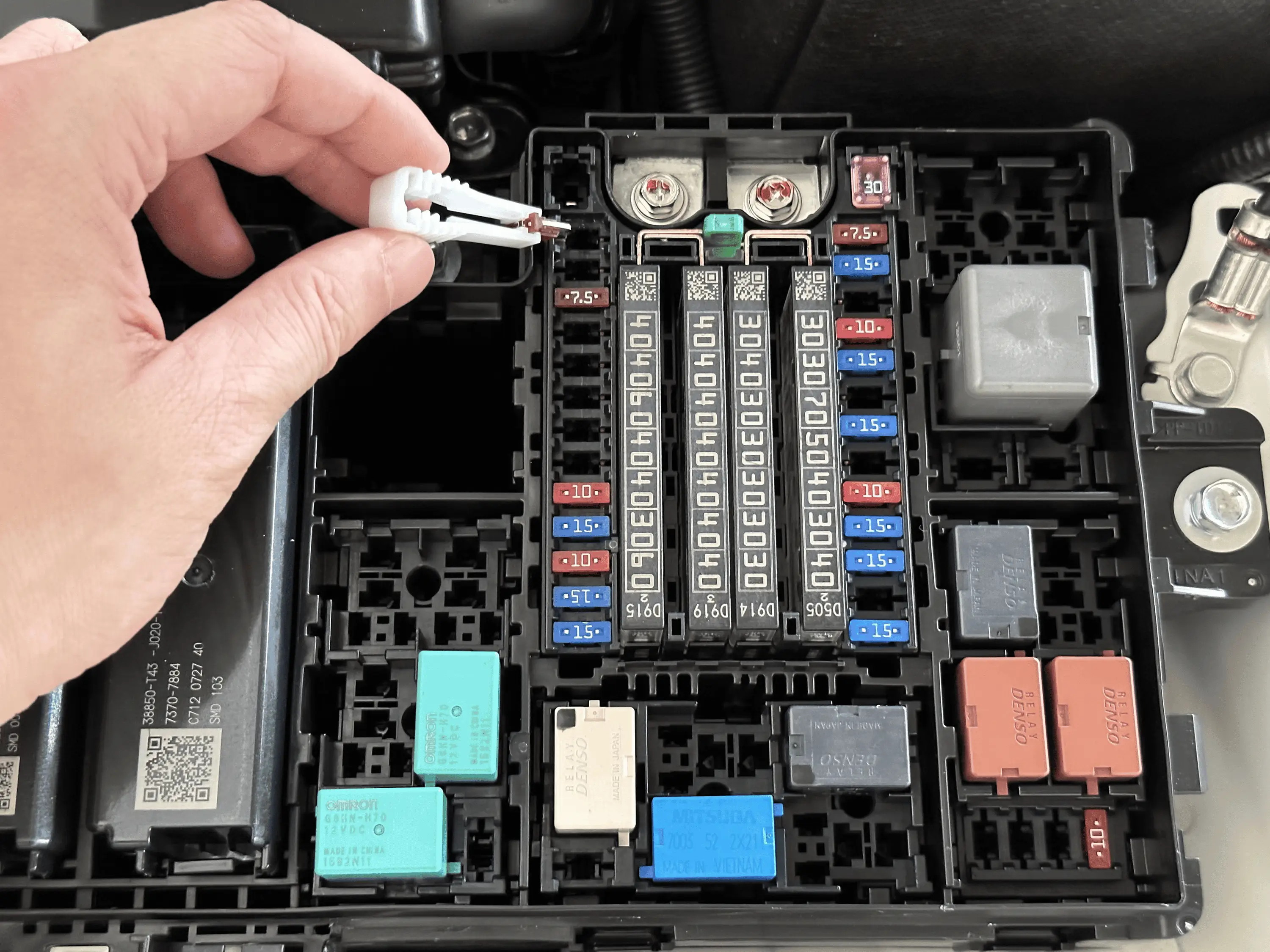

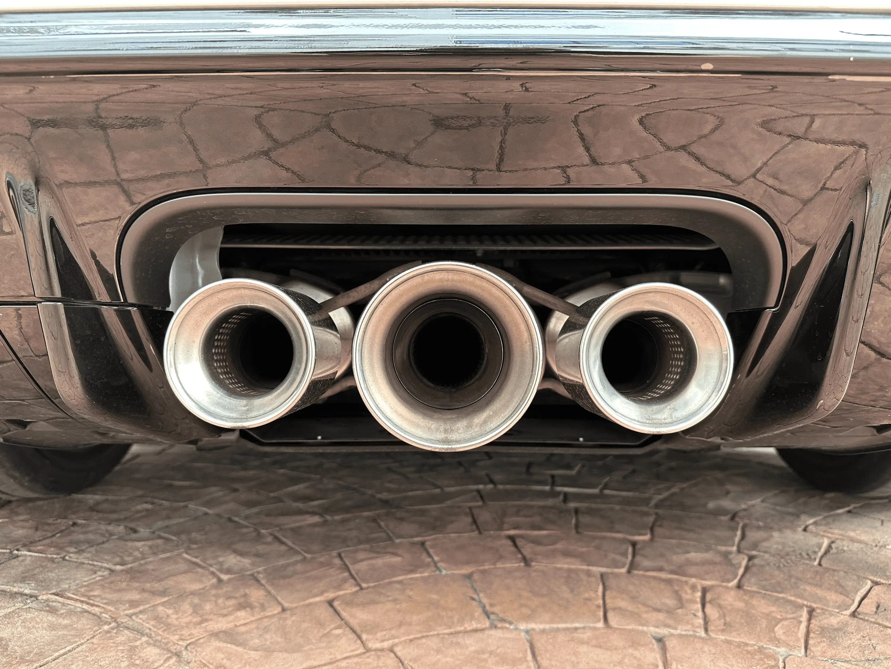

About the surprise after removing the exhaust valve fuse, it's not just the sound. After removing the fuse, the exhaust valve is fully open every day. I was pleasantly surprised to find that the problems that bothered me before disappeared, the instrument panel no longer makes abnormal noises, and the engine does not vibrate so much. Before 4000 revolutions, the instrument panel would beep and the engine vibrated obviously. I guess it was because the computer controlled the valve to open after 4000 revolutions, which caused the engine to be unable to completely exhaust the vibration caused by the gas, which affected everything in the car. . Now everything is smooth and the revs are picking up pretty fast. If you also have this problem, trust me, unplug the fuse of the exhaust valve. will solve these problems.
