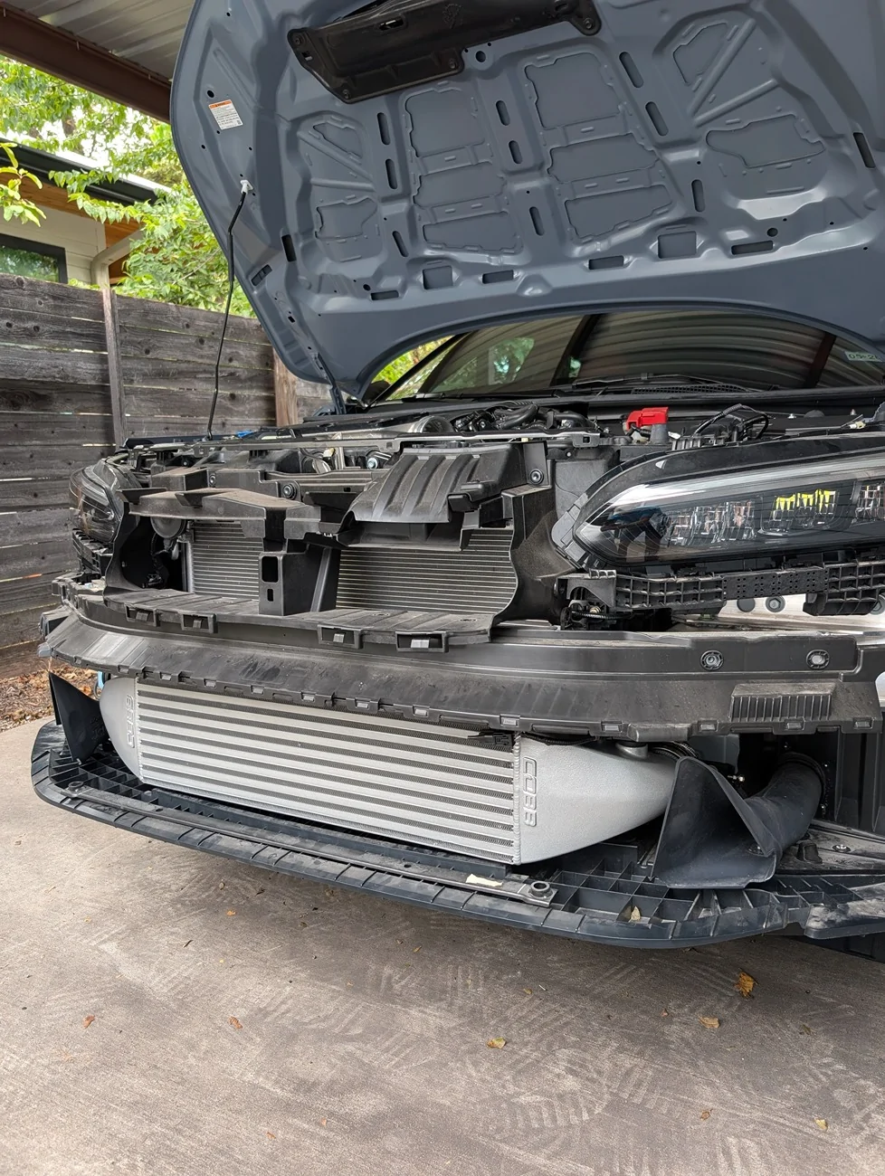

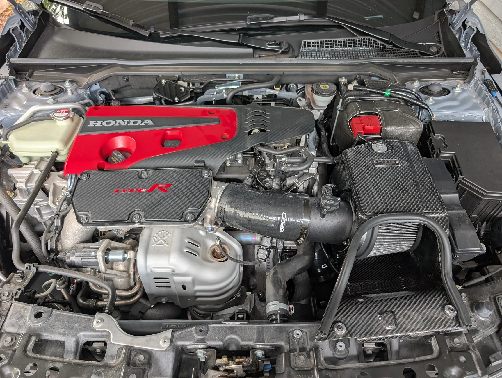

Got everything installed and test drove for a bit. Running the stage 2 Cobb map that goes along with the intake and intercooler. There is a stage 1+ map if you are just doing the intake too.
Some initial thoughts below. I'll drive it for the next week to get a better feel for the differences before the new parts
- Intake install was straightforward and easy
- Intercooler install was much tougher and is definitely a 2 person job. It was the first time I've taken the bumper off as well and took my time getting through all the pop out clips. The routing the charge pipes and hoses and getting them just right was the toughest part.
- Lots of turbo noises that I never heard from the stock intake
- Car feels a little quicker once it hits about 3k rpm and through the rev range but I'll be doing more testing on that
- I also did the acuity shifter bushings since thats all in the same intake/charge pipe area. Personally I don't feel like its a whole lot different then stock but I'm glad I did it
