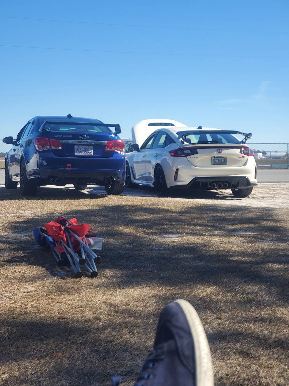

I took this picture during lunch and if you look closely it kind of does look like the left front tire is already going flat. But idk

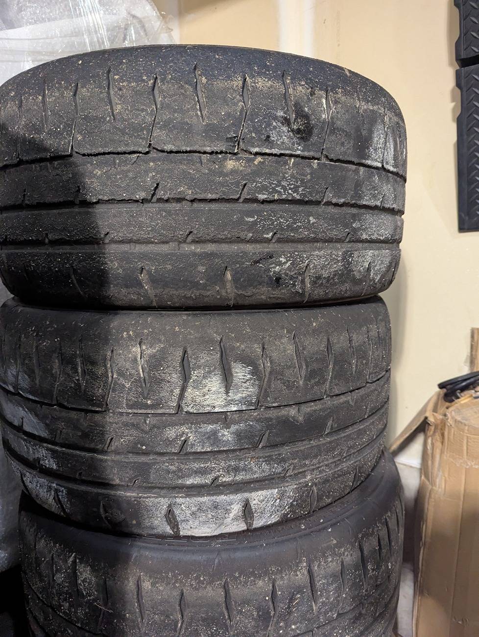

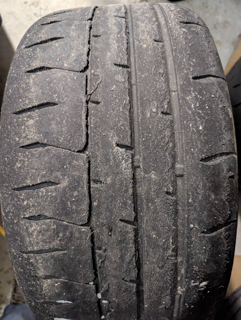

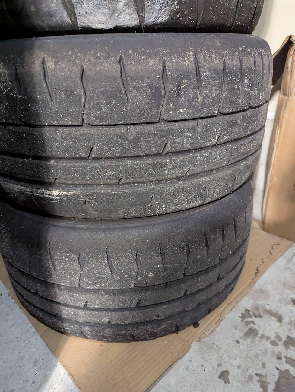

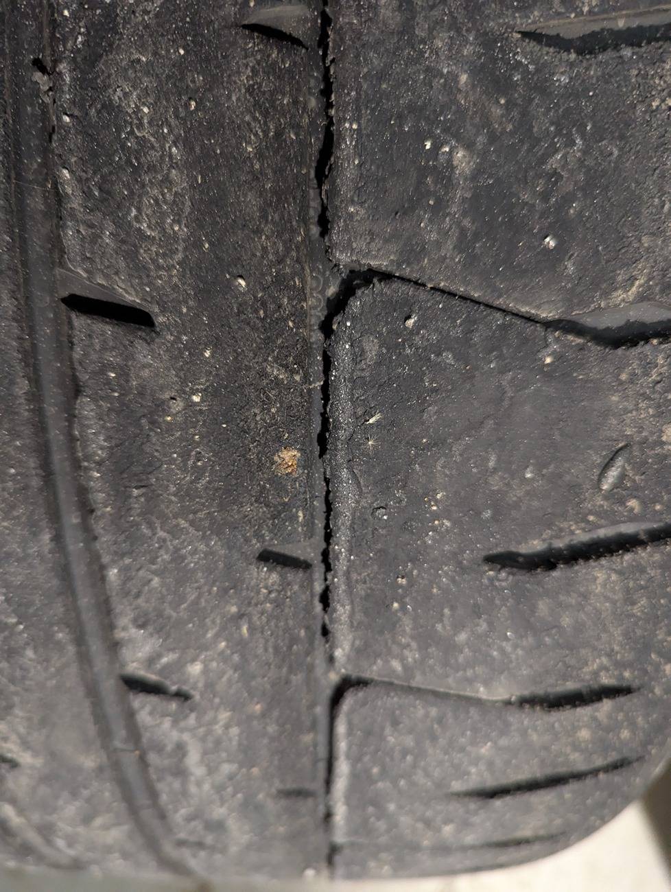

Hey everyone, long term lurker, first time poster as i finally just registered for an account.
I have some questions and would appreciate insight from the group. I'm looking to track my 24 CTR for the first time this season. I'm not looking to go crazy but I would like to do 2 to 4 track days this summer if possible. I'm going to see if I can get in with a car club that offers driver instructors to novice drivers like myself.
My car does already have some upgrades, spoon springs, tsp. Downpipe, PRL HVI, tsp. Stage 1 tune. I have done tons of research and from what I gather I should upgrade the brake fluid to Castrol srf, and maybe consider upgraded brake pads which I'm okay with. If so what brake pads would you recommend?
My main question is, I have the opportunity to buy 18-in Titan forged rims with Bridgestone re71rs tires that the current owner claims he's only had two half track days on them. It's actually a pretty great deal cost wise but I went and looked at the tires and for sure the front two have taken most of the abuse as I don't believe he's rotated them in that time.
I know most of you guys state that I should probably just go out on the factory tires and rims, but I'd rather keep those in good shape for daily use and have a dedicated set of tires and rims even if I'm only going out a few times a year.
I'll post the tires and rims and if you guys could let me know if they actually still have good life left on them for my intended use I would really appreciate that.

As for the tires I'm not sure how much life they have left. I would focus on the cost of the rims alone and not give a ton of credit for the re71rs.

If the deal is good enough - don’t pass it up, but I don’t recommend a Super200 for a first timer. It hides a lot of mistakes and lets you get away with some stuff that develops bad habits. If the deal is good enough, maybe sideline the tires after you get some more experience, and start out with something like an ECF. I very much understand not wanting to destroy you daily tires, since those aren’t cheap either.

Castrol SRF is definitely the way to go. Those tires still have TONS of life left on them, but I'd have to agree with James. 200TW tires will hide mistakes, and slicks will hide even more mistakes. Since it's your first time out, I'd recommend just sticking with the factory tires. A first timer is not going to destroy them as quickly or aggressively as an advanced driver. When I was a novice the PS4S's seemed just fine, but now I absolutely loathe them.
