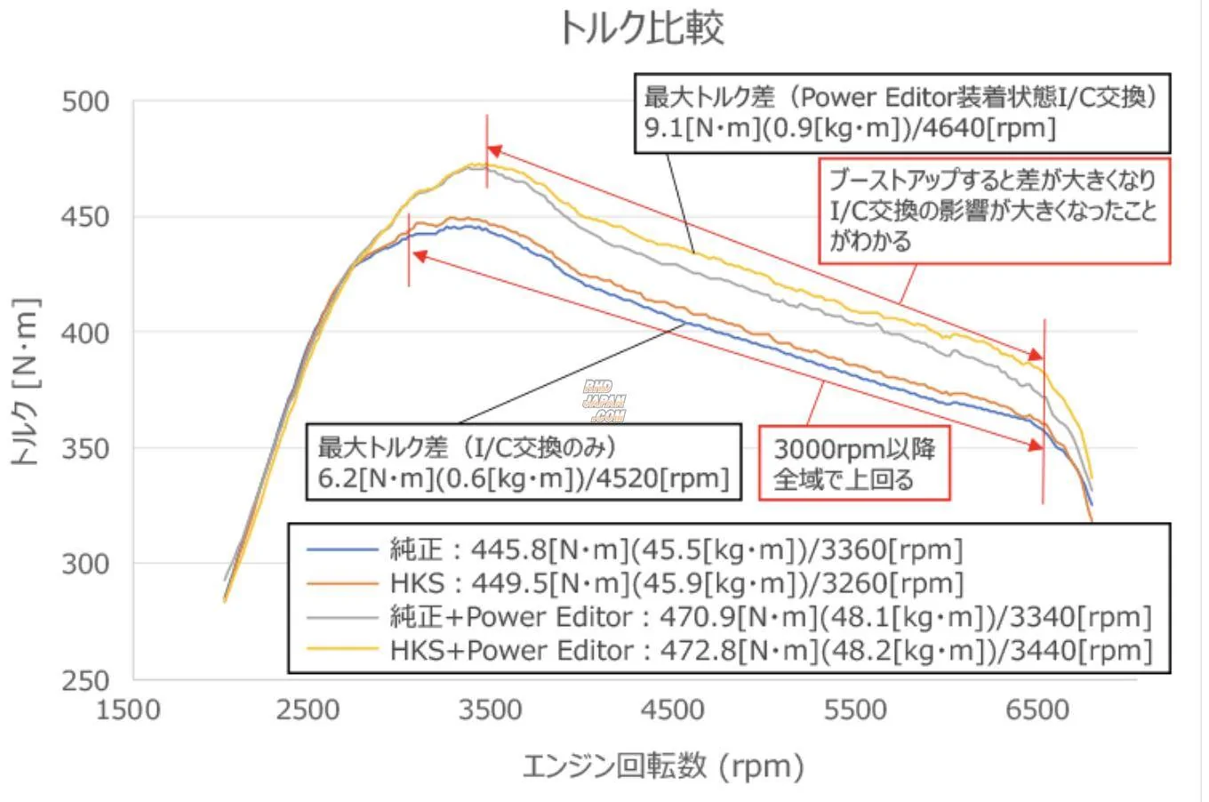

Here is the dyno of the HKS IC with their pipes that show minimal gains...which is what you would expect to see

I think it’s after the Wagner sticker and HPS sticker they supply.

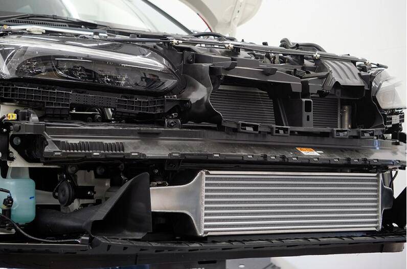

The endtanks on the J's unit are interesting. Perhaps they were wanting to limit overall volume. Definitely not the Wagner approach! At the end of the day there is no one design that is perfect for all applications. It is nice to have options.
