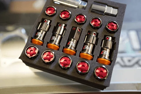

Make sure to get a lugnut that fits the wheels you are using. Most are conical but always good to make sure.
Open/Closed eneded is a personal style choice as well as length
I would go with Steel as they are more reliable if you are taking them on and off repeatedly. Ive had aluminum ones in the past and if you torque too much it can deform the end. I also noticed they tended to loosen up more after heat cycling so have to check torque after a drive.

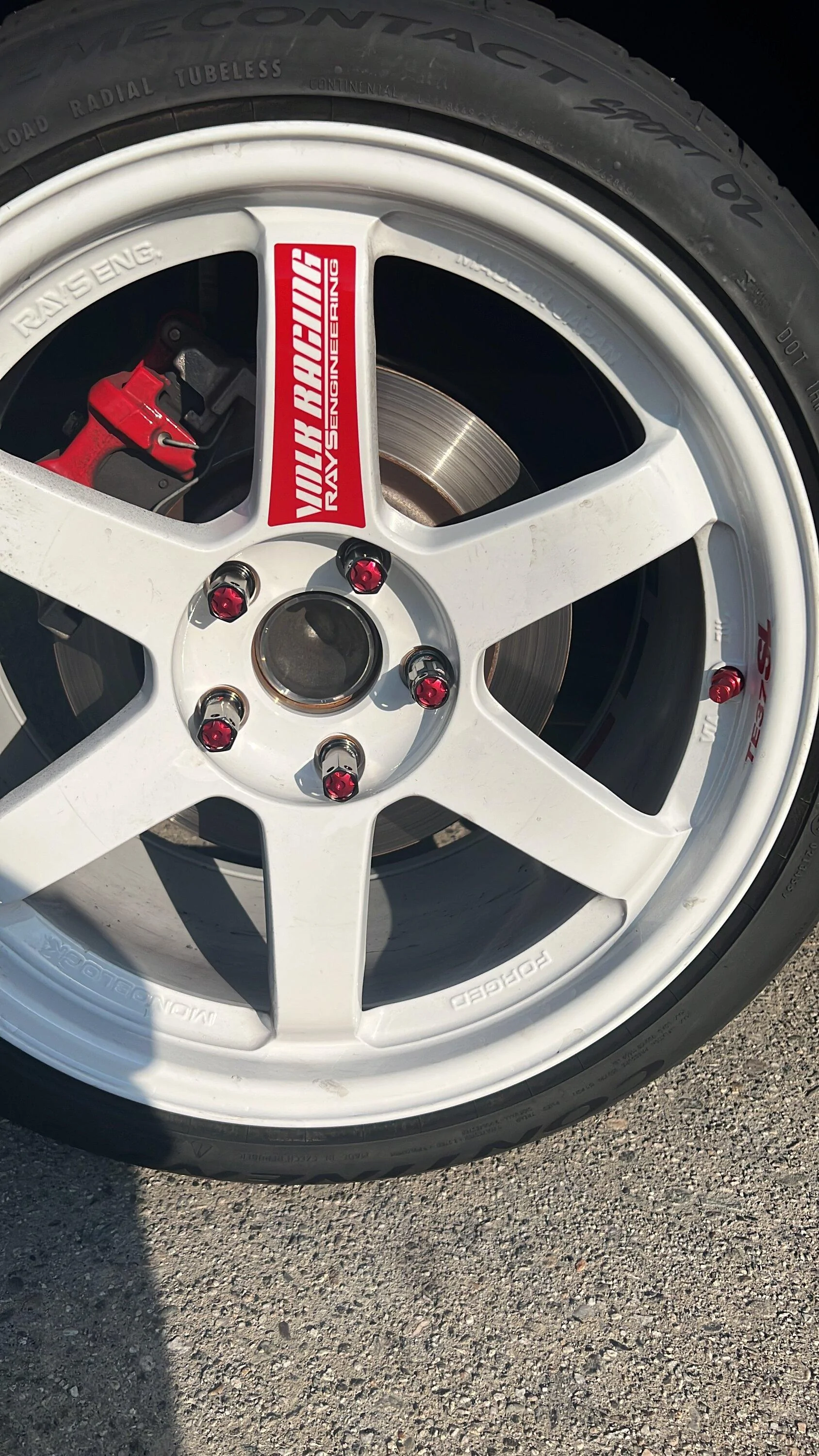

I ended up grabbing these ones as they are good for the price. I dont see the point in titanium or spending $300 on lugs.

How does it lock the wheel? or does it not?
(4) of the lug nuts have splines instead of hex head, thus requiring a special tool to remove. You can see it in the picture of the lug nut box and the lug nut at the roughly 3 o'clock position in the wheel pic.
