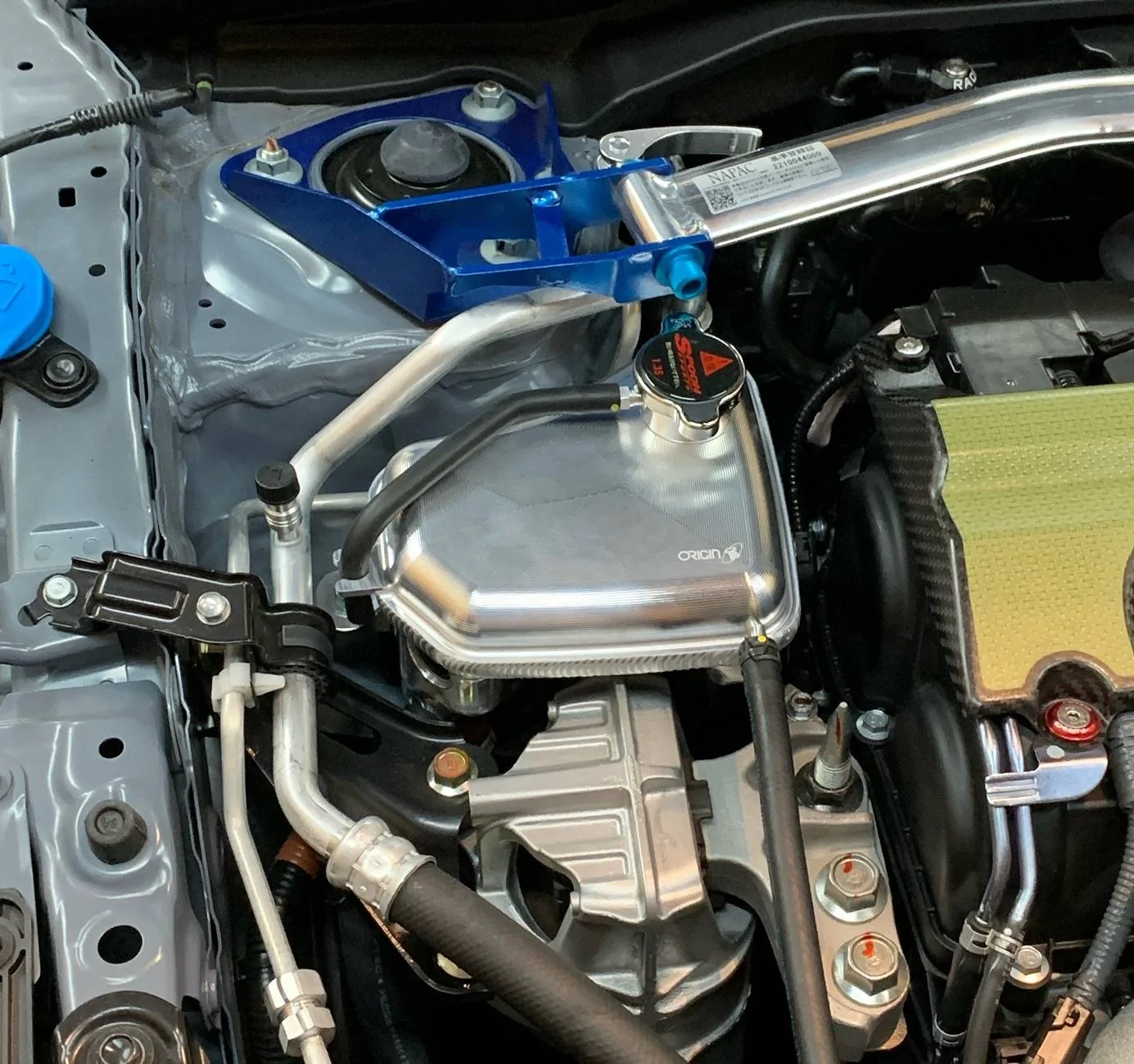

Changed the coolant reservoir today, surprisingly easy install with just a tiny bit of lost coolant. Didn’t have to remove any brackets and all the hoses broke their seal and twisted off easily.
Looks clean ?

That is my favorite OEM looking reservoir. It's what Honda should of made and used.

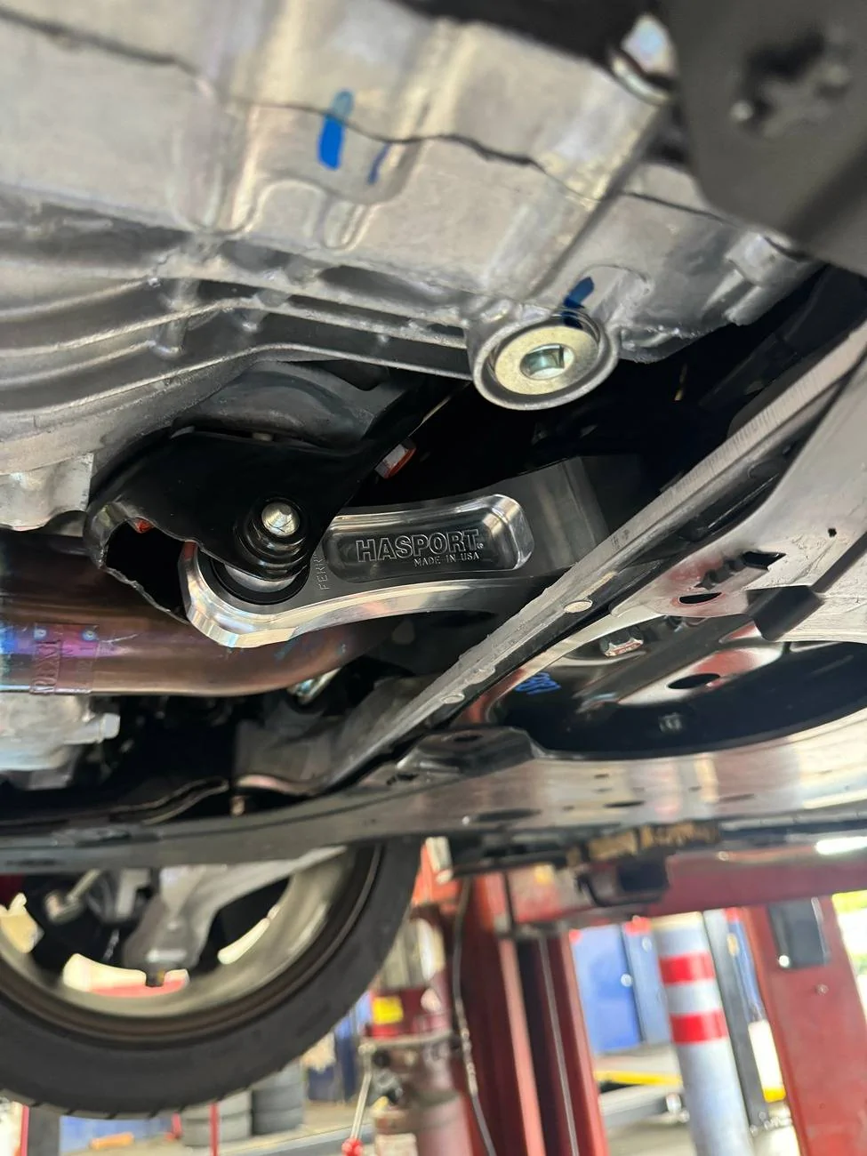

PRL Rear Motor Mount. Install would have been way easier if I didn't have my jack stands on their lowest level lol
For those that installed the RMM yourself, how were you able to get the horizontal bolt off the OEM one? I tried doing the install yesterday. The bolt was loosen but I didn’t have enough space to pull it out, so couldnt finish the install.

If you have an aftermarket front pipe you'll need to remove it. If you still have the OEM front pipe and its not hot, you can just push up on it a bit and you'll be able to remove the bolt.

Okay thanks! I tried doing that but maybe I just gotta push harder.

I was able to wiggle the RMM out after removing the vertical bolt and loosening the horizontal bolt (if I recall correctly, I did not remove the horizontal bolt completely out, or wiggled a bit, then took it out? I vaguely recall having to push on the pipe)
btw, to tighten the bolt back to specs, I had to get a "crowfoot" adapter to get my torque wrench in there
https://www.amazon.com/ANPUDS-Crowfoot-11-Piece-Extension-Adapter/dp/B0CBMFZG96

I had to pry a little either direction to get mine out too. Took a little force but it got done.
Yeah it’s hard to get leverage on your back, but maybe I’ll try again this weekend. Thanks!
