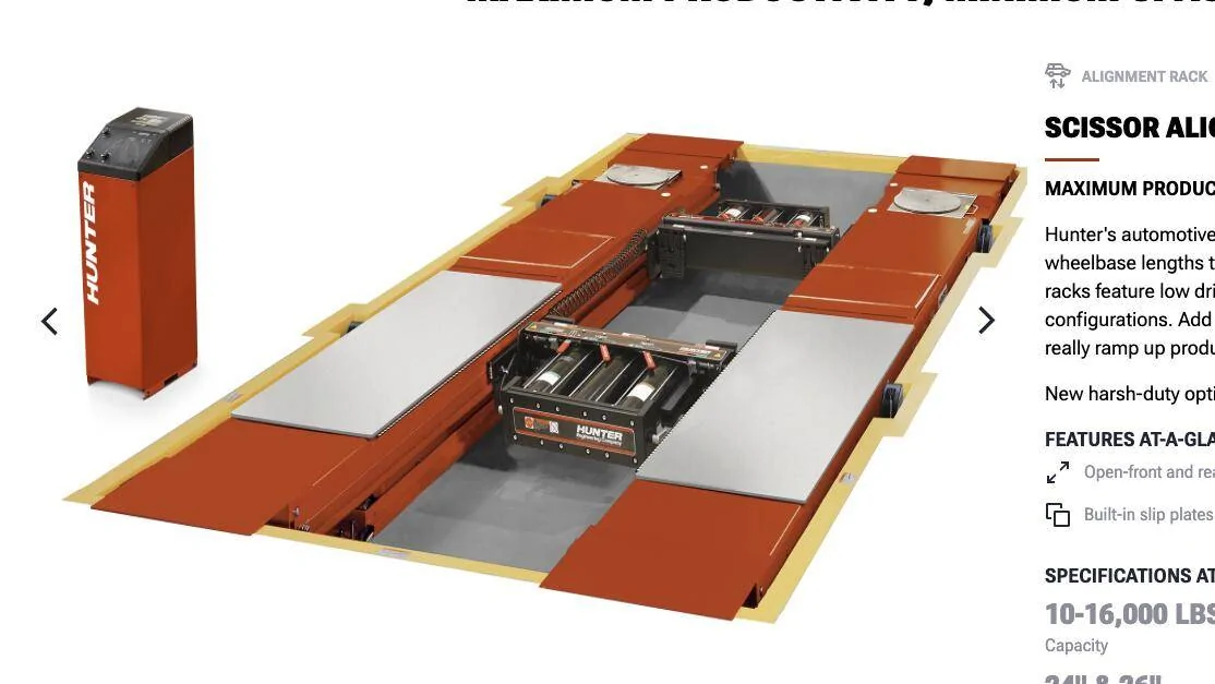

My local dealer won't even touch my car. LoL. Their alignment rack couldn't get the car on it without scraping when at stock ride height.
I’ve heard of that problem before and I’ll have to make note for sure when getting mine done also.
call around and ask if their alignment rack is flush mounted - AKA level with the ground - all you do is roll onto the rack, no ramps.
there are a handful of shops in southern california that have flush mounted racks... I'm sure there's one near you too
11th Gen Honda Civic What did you pay for your Spring install in your area ? Screenshot 2025-06-24 at 11.07.42 AM
https://www.hunter.com/alignment-racks/scissor-lifts/?#overview
