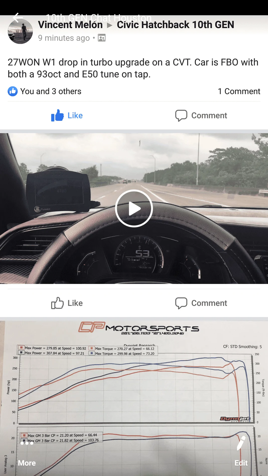

Here is a screen shot of a dyno graph from a CVT customer of ours in Singapore. Car is custom tuned on a Hondata with bolt on's and a little bit of ethanol.
You can check it out on IG @civic_mljj

I thought our cvt's are maxed out at 250 foot pounds of torque?
Look at how “smooth” the graph is and the fact the dash shown is not a Sport model. So, question the fact how the power curve is that smooth w/o the ability to transition at peak power? Cough cough
Besides..look at the TCF on the 1st one, it is 25% above what is REAL. Typical Singapore trying to get false attention
Yeah something is "interesting" about those numbers and graphs. It looks nothing like the other supposed CVT dynos. There's no way that dude is getting 300+HP and near 300lb/ft torque without the internals or transmission failing with just FBO and pump gas. Let alone the quality of the graph pattern on a CVT without paddle shifters.
Again, I'd like to see some data from US CVT Civics, analyzed by credible professionals.

Just watched the video. It doesn't look like a sport trim, but it looks like there's shifting going on? I'm so confused by all the information on this turbo in CVTs.
I really would like to buy the W1, but can't rightly let myself do it without credible information of how it will behave or affect a CVT.
The Ktuner 21psi is pushing roughly a tad over 200lbft at a rather lower RPM. With a W1 having both 60% larger Compressor-Turbine wheels, the power is shifted to the right. A savvy tuner could play with a number of variables (WG, Timing, BBG, etc) to achieve a pretty strong tune; even if 250hp and 230lb ft. In addition to that is much less boost; this less heat - That is consistency all day long. Granted the use of an upgraded IC.
Slightly opening up the stock mid pipe and the 2.125 exhaust piping to maybe 2.25-2.35 would also alleviate increased torque generation down low. Couple that with (maybe) running no more than 18-18.5psi and you again have a very cool and efficient machine. Food for thought....
What I am eluding to is, just because you upgrade a turbo - does not mean you have to shoot for Big #’s. It can be used for higher efficiency.
