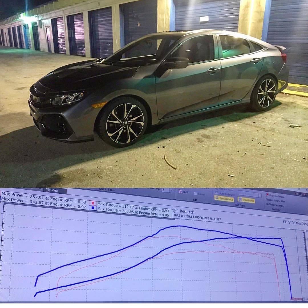

Hey guys,
So it's been a while since this thread was updated and lots more turbochargers and dyno results have come out from all our happy customers. I wanted to use the next few posts to share some of the graphs and info from other W1 equipped cars. This way a more rolling average can be shared and people can see the great results that are possible with this easy bolt on. The delta in these graphs is amazing and shows just how much you can get with the turbo swap alone.
This is a FBO car with stock exhaust and an E45 blend. You can see with the W1 upgrade and some E that he net over 85whp and 53 tq
11th Gen Honda Civic 27WON W1 Upgraded Turbocharger Pt 5 POWA Derf Tuned
