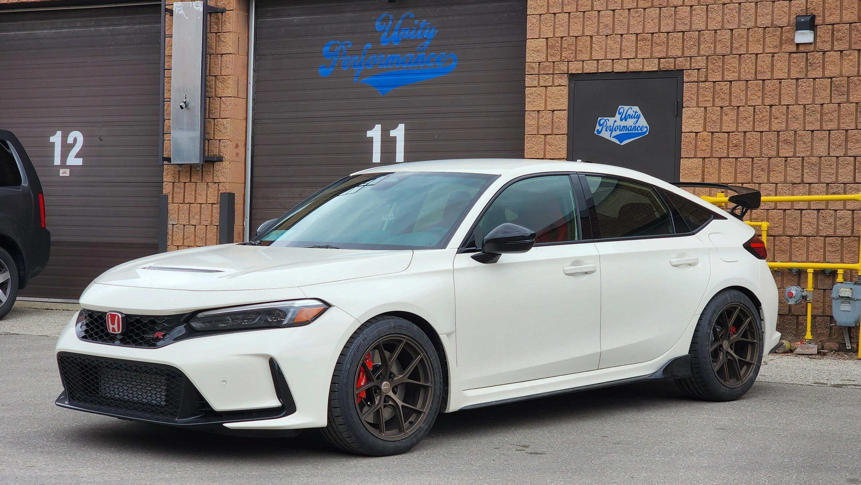

Stock Height - this setup will 100% rub on a lowered FL5
Superspeed RF05RR - 18x9.5 +38
Continental ExtremeContact Sport 02 - 265/40R18

More pics as requested of the 265/40. The tiniest amount of poke, that can be dialed out with some additional negative camber with an alignment. If you have a +45 offset wheel there will be no poke with factory alignment.
Turn-in is not as hyper responsive as it is with the factory setup, but with it's not floaty at all. The ECS 02 tire competes and is some aspects exceeds the Michelin PS4S so we've still got all the grip we need.

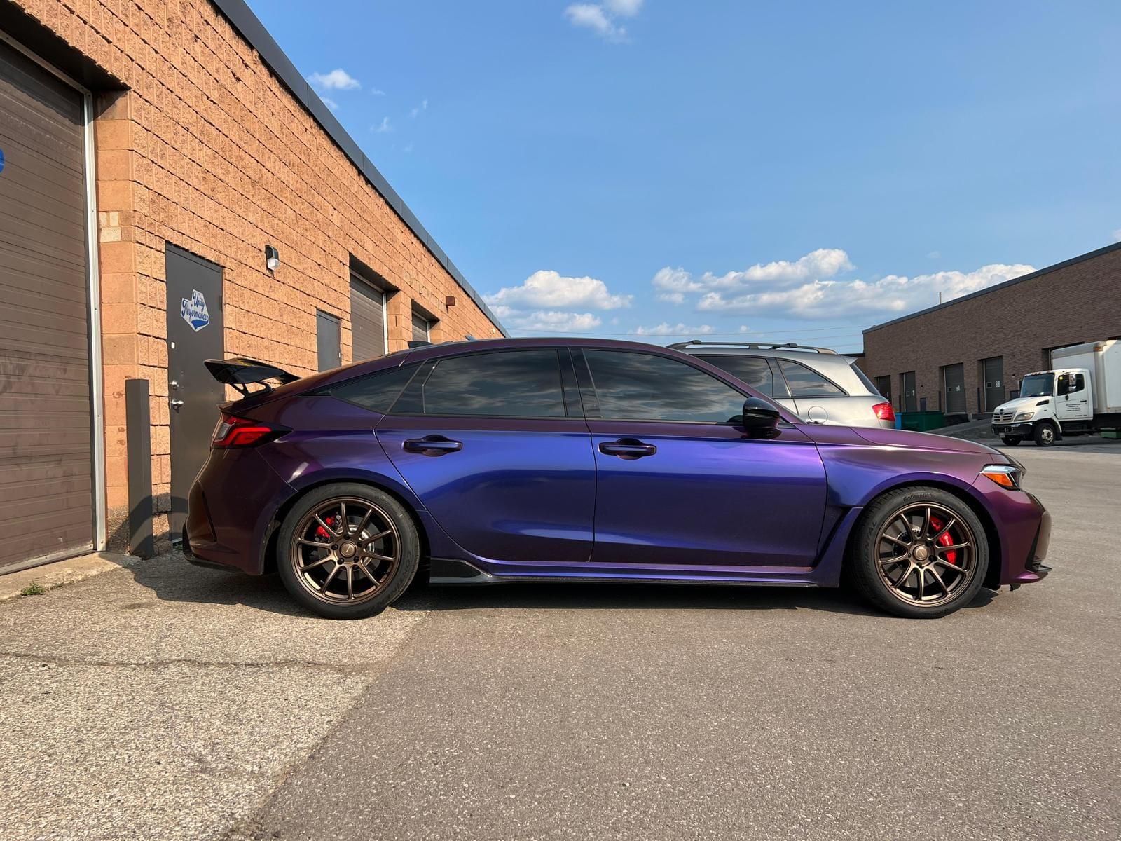

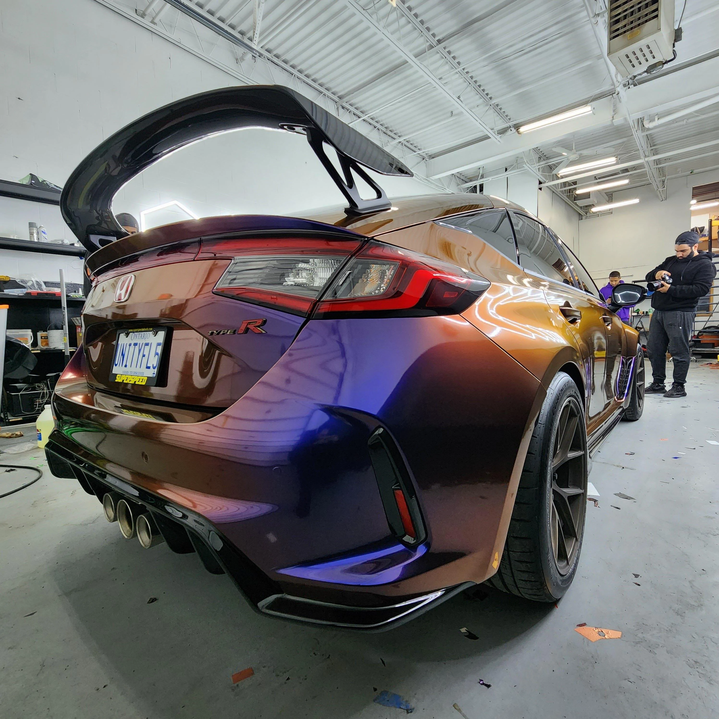

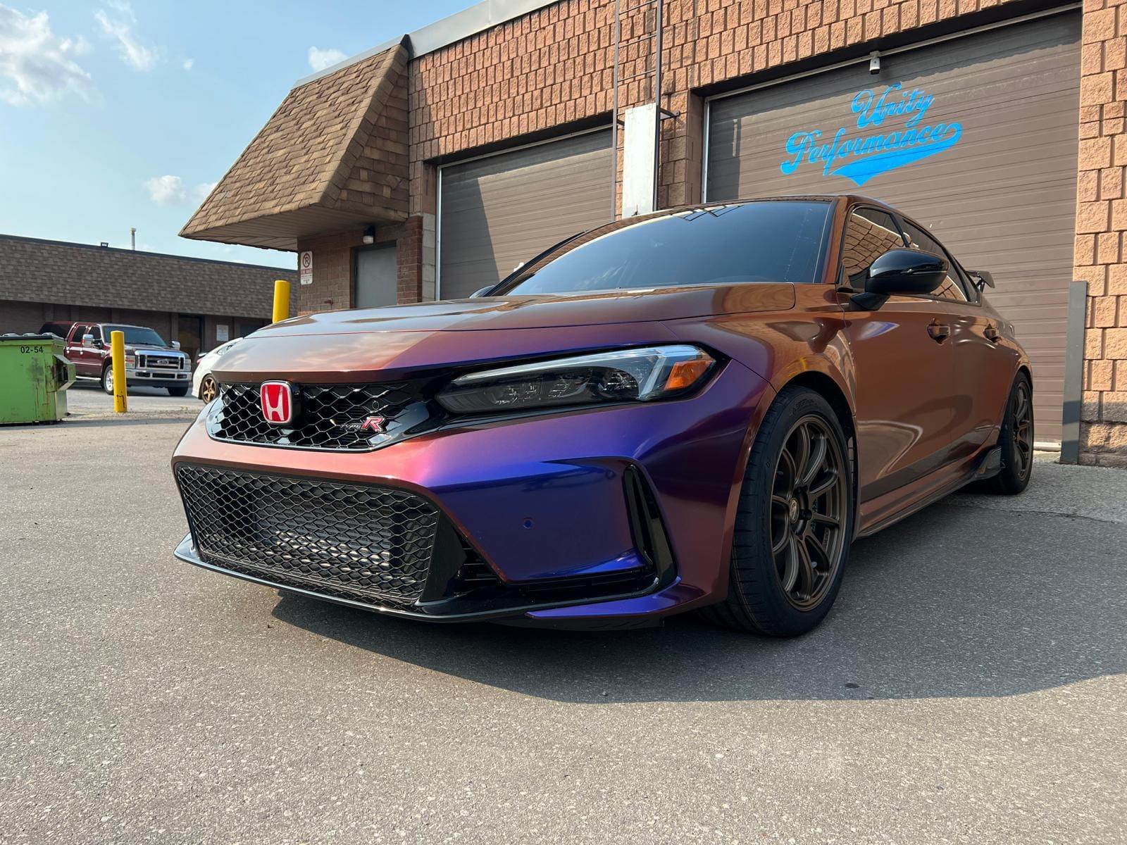

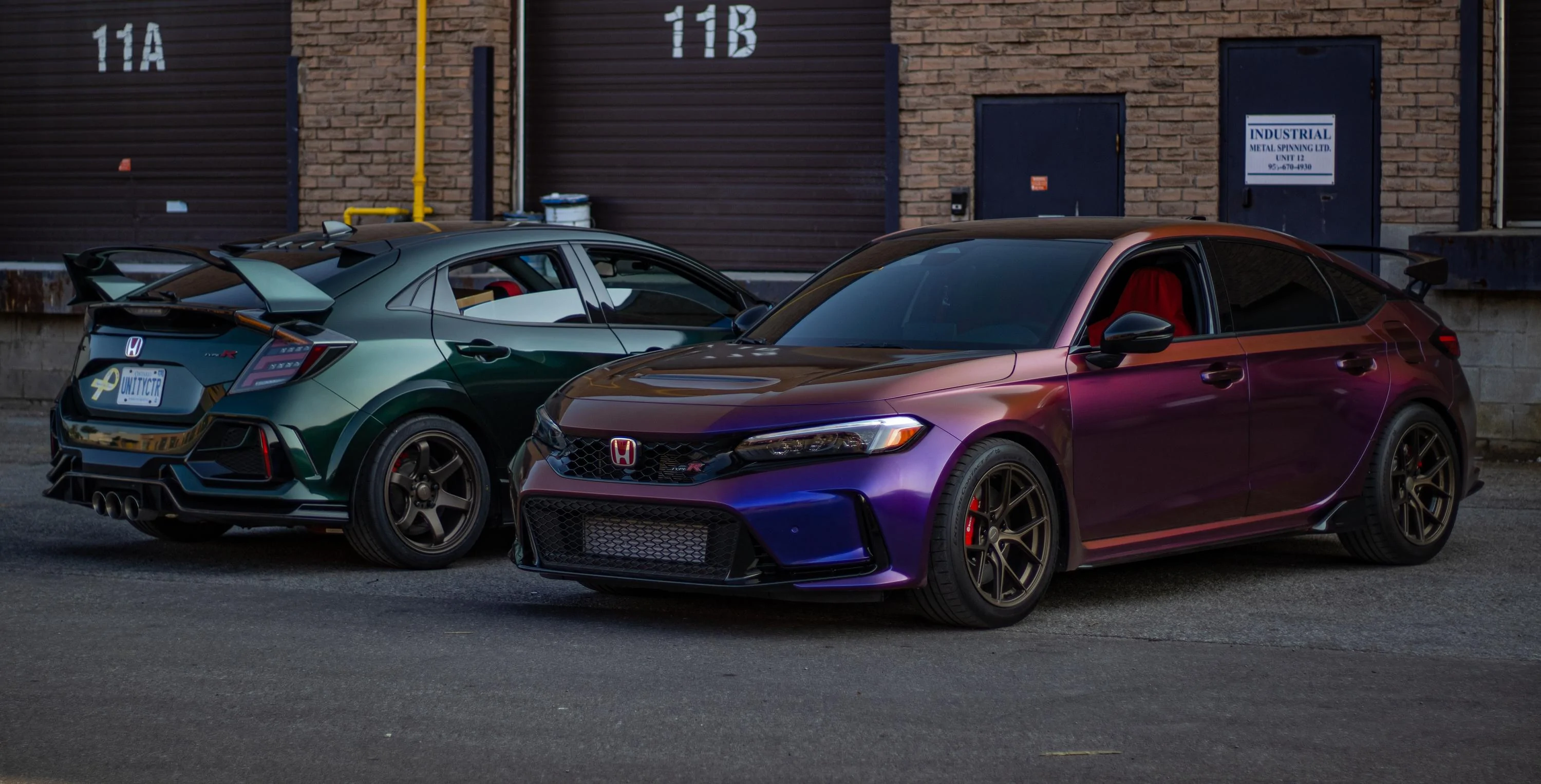

It's been a busy summer to say the least!
Update #1 Wrap! Went a little wild here, the FL5 is White is so subdued so why not have some fun with it! Avery Gloss Roaring Thunder Blue/Red

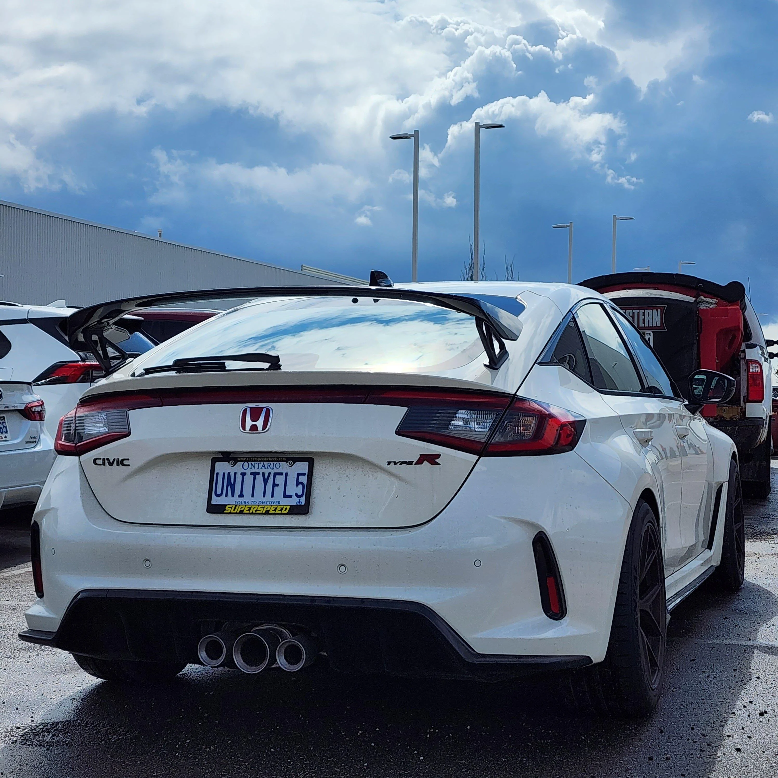

The car then spent time with MBRP Exhaust, being their development car for the upcoming exhaust. Here were my requests from what I've learned with my own FK8 and the community at large when it comes to an exhaust that we want to run:
1) Triple Tips
2) Configurable Muffler/Resonator options
3) No Drone - shouldn't be a problem with a stock downpipe, but most can't accomplish that with an aftermarket downpipe
4) Valved - FL5 has a valved exhaust, so let's retain that
5) No rattle - doesn't need to be said, but some FK8 options have/had rattle, which really hurt their reputation
6) Configurable Tips - not the most important, but MBRP already offers that for the FK8 Exhaust so why not
^ Above is the preview of the first prototype that we had on the car, zero drone with stock downpipe, perfect OEM+ sound, and Valves would open a little in Sport, fully in +R.

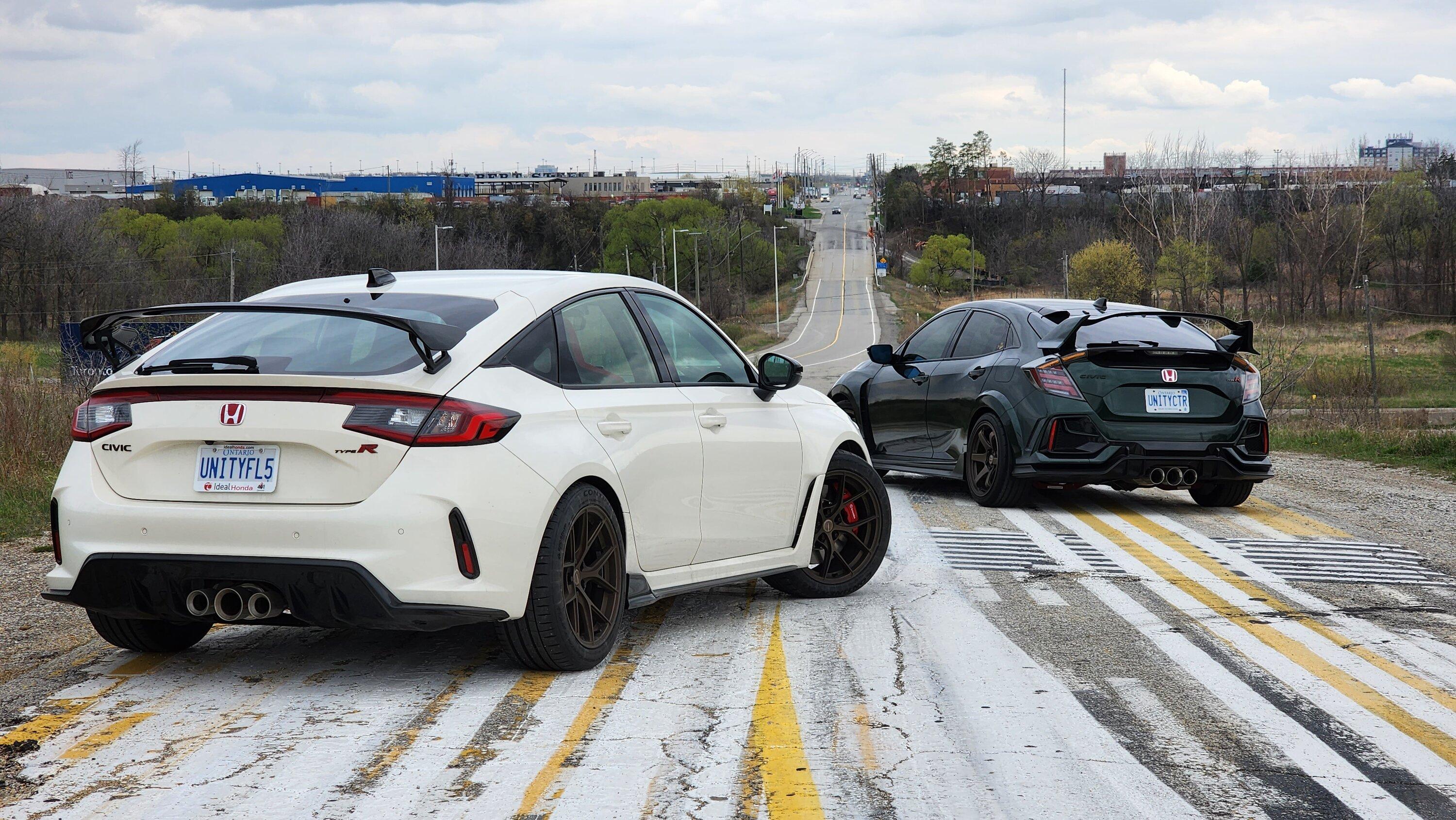

Looks great! which shop car do you guys like more?
Having to choose here which child I like more :p
The FK8 is certainly more raw since it has the absolute book thrown at it for parts. It's on a hoist right now getting even more upgrades. It was also the car that I've had more experiences in per say such as track days, Tail of the Dragon, and it's also my personal car so there's that.
The FL5 is owned by a very good friend who's given it to Unity to have as a shop build, so it's mine and not mine at the same time, but it's still special. Love how wide it is, the color pops, it's an overall more refined package, and the interior is miles ahead.
