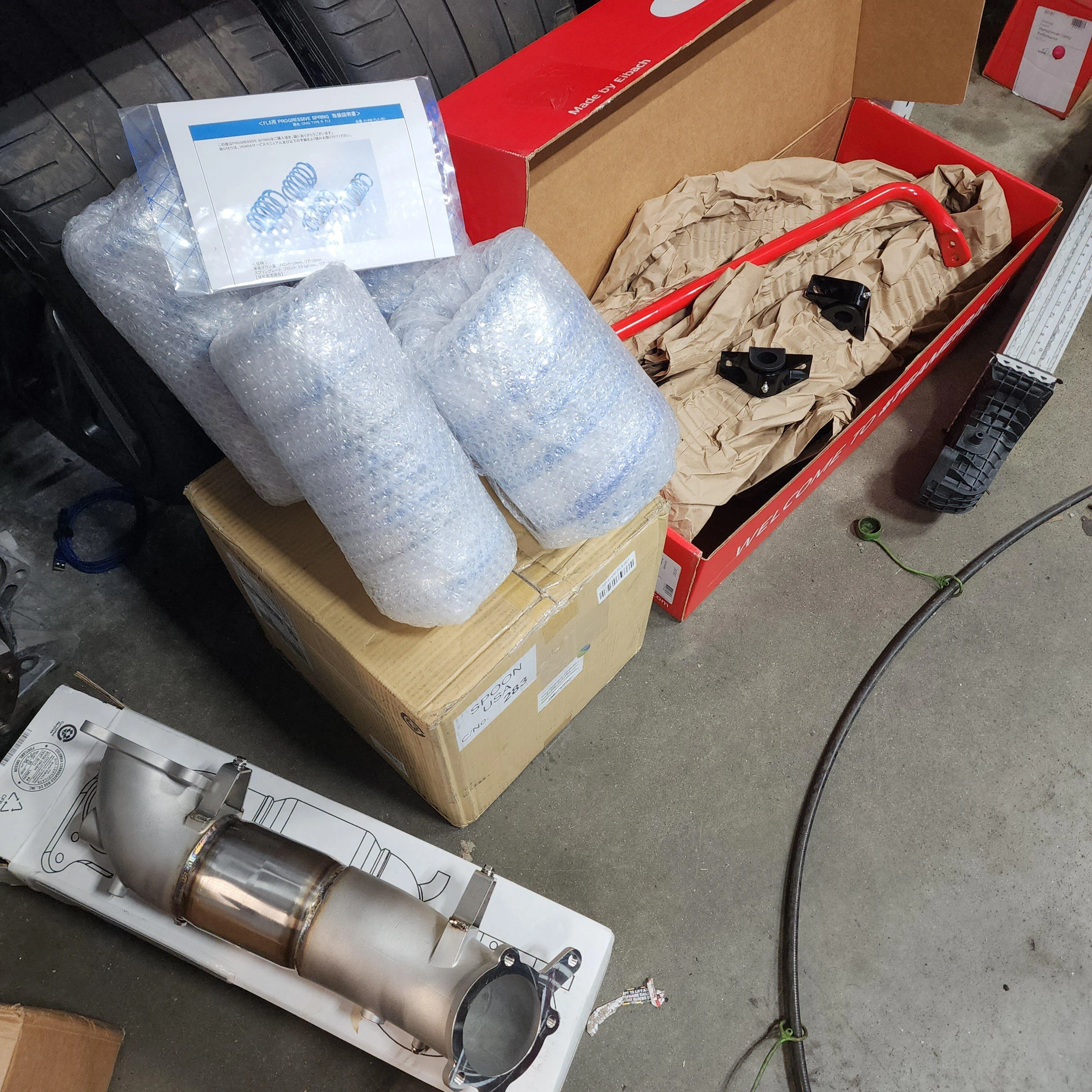

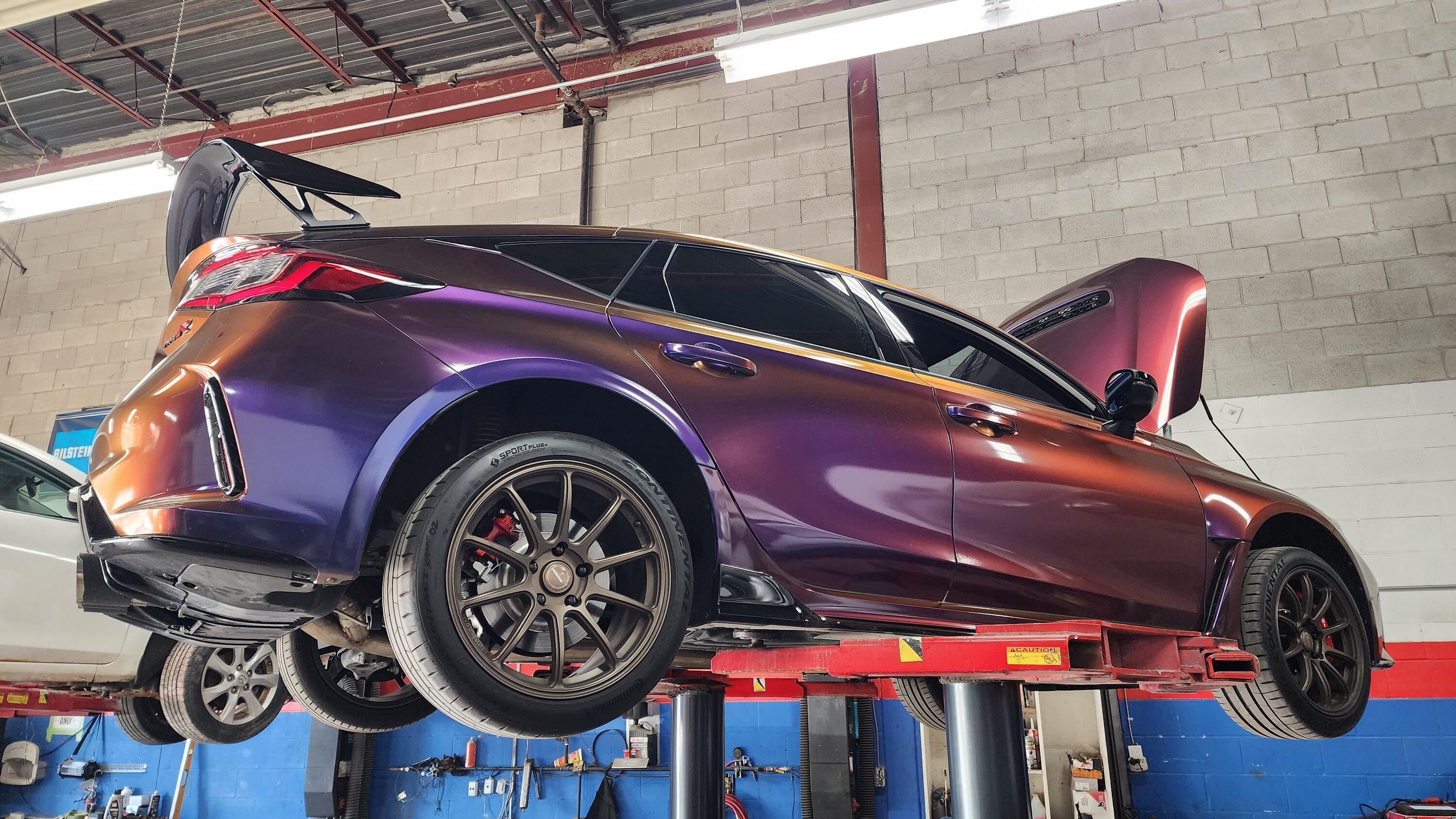

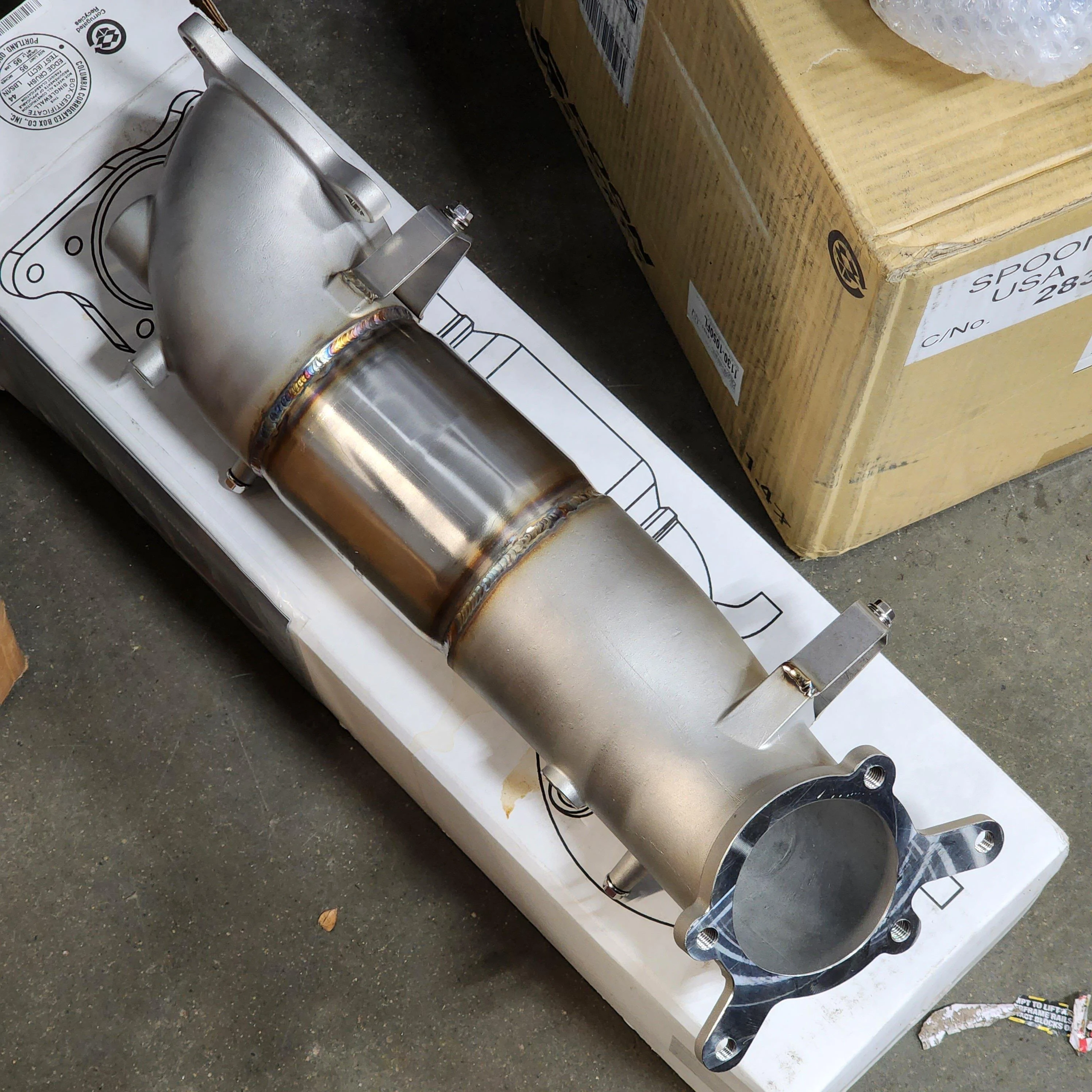

The 27WON Kuro was always in the plans for this build, we were just waiting for MBRP to finish up the final production version of their upcoming FL5 Valved exhaust, shoot their media content with the stock downpipe of course, and then we can tear it down for the round of upgrades!
- 27WON Kuro Drop-in Turbo upgrade
- 27WON 3" Catted Downpipe
- PRL Intercooler (painted upside down by error, doesn't bother us)
- MBRP 3" FP and Exhaust
Other notable upgrades: Eibach 25mm Rear Sway Bar Kit, and Spoon FL5-specific springs

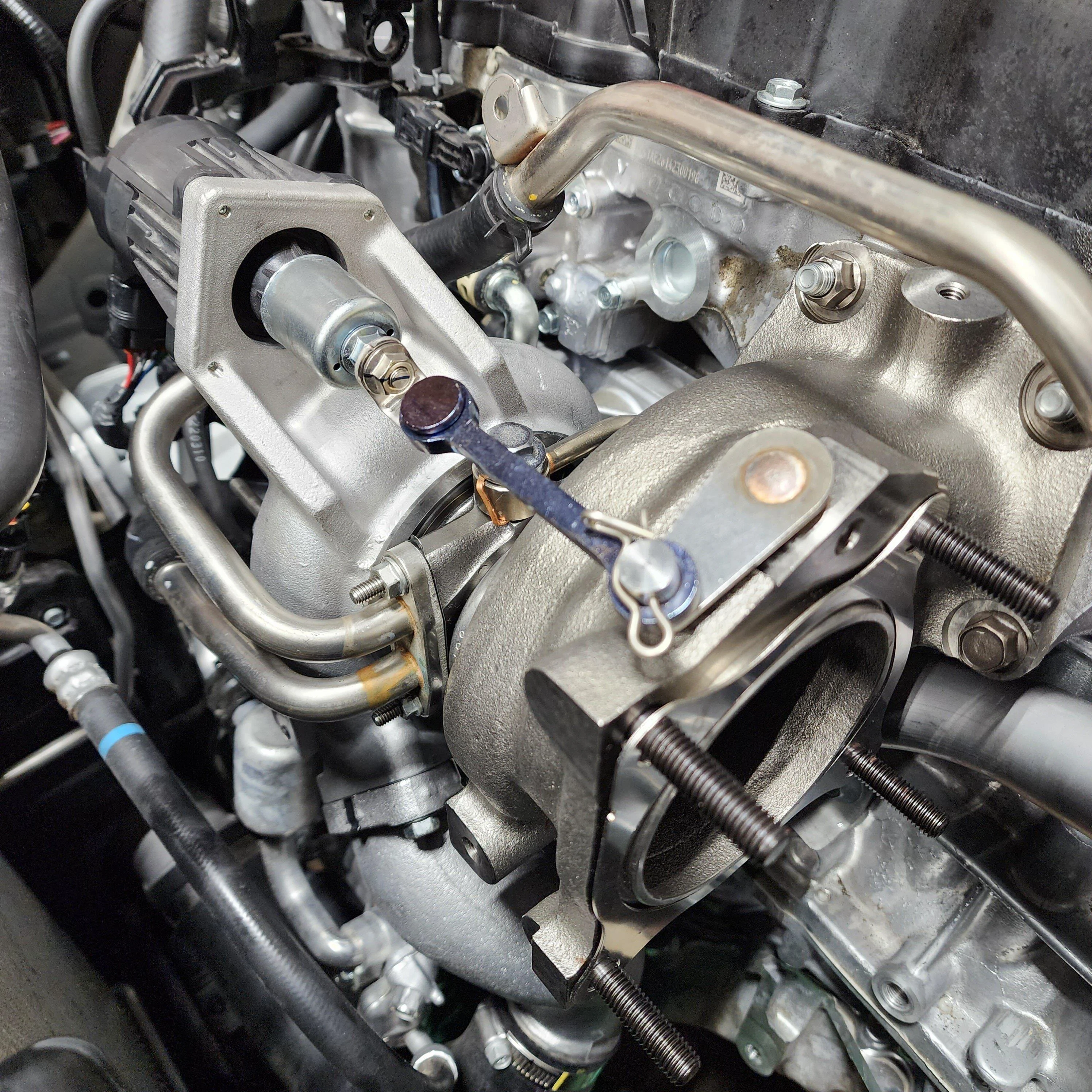

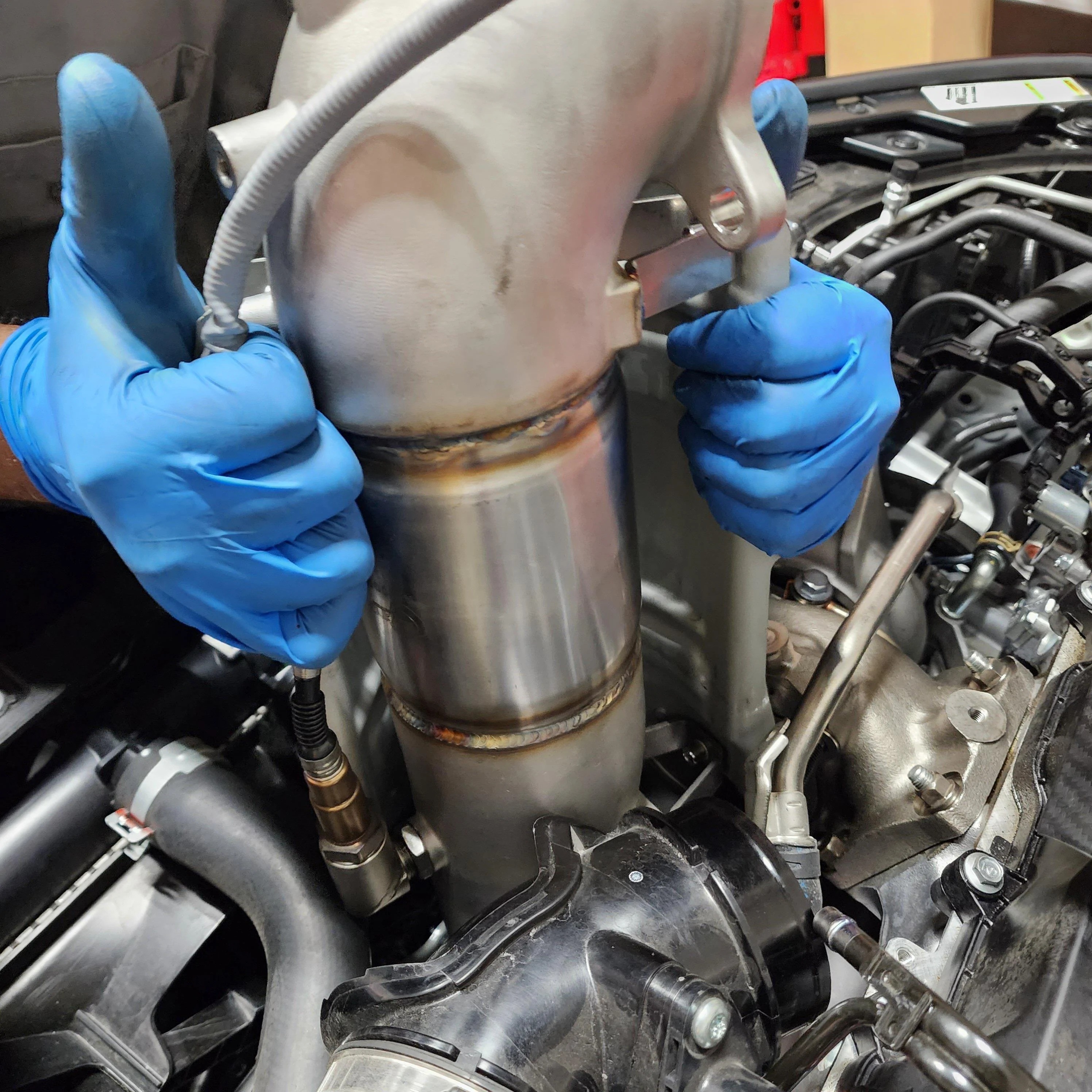

DP test-fit with stock turbo, all good! True 3" DP, most others will taper down to a 2.8"
11th Gen Honda Civic "UNITYFL5" Unity Performance 500HP FL5 Build Thread 20230830_203343

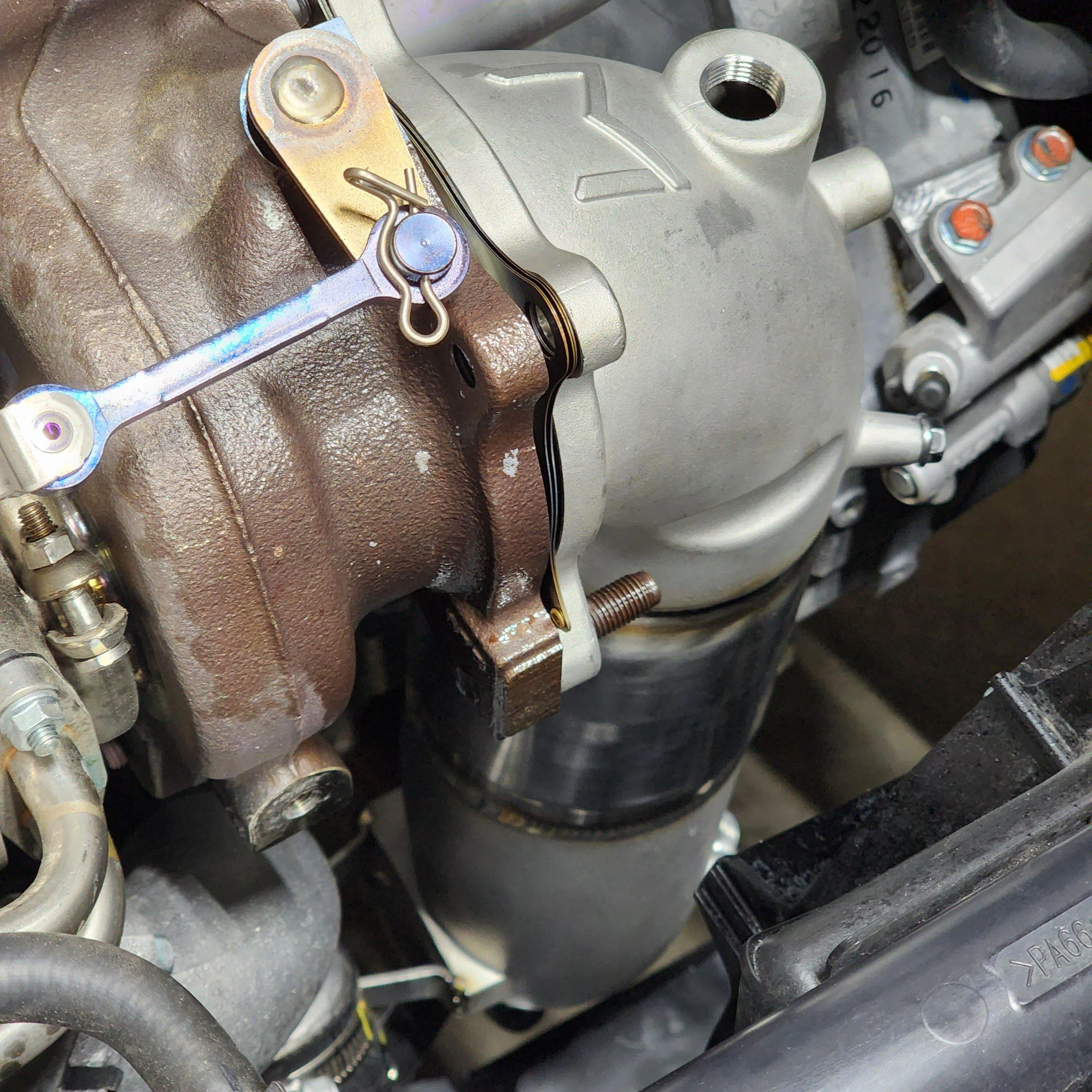

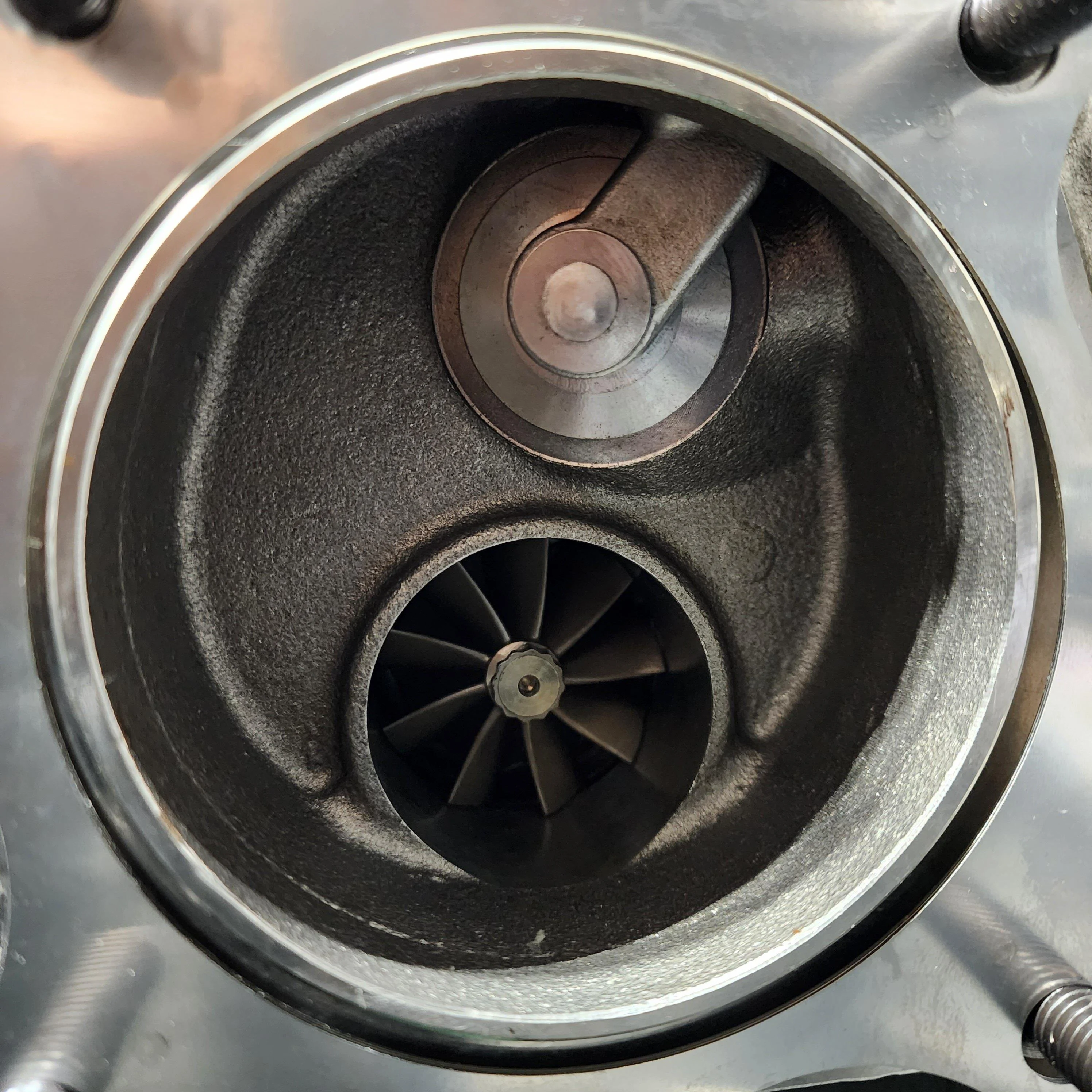

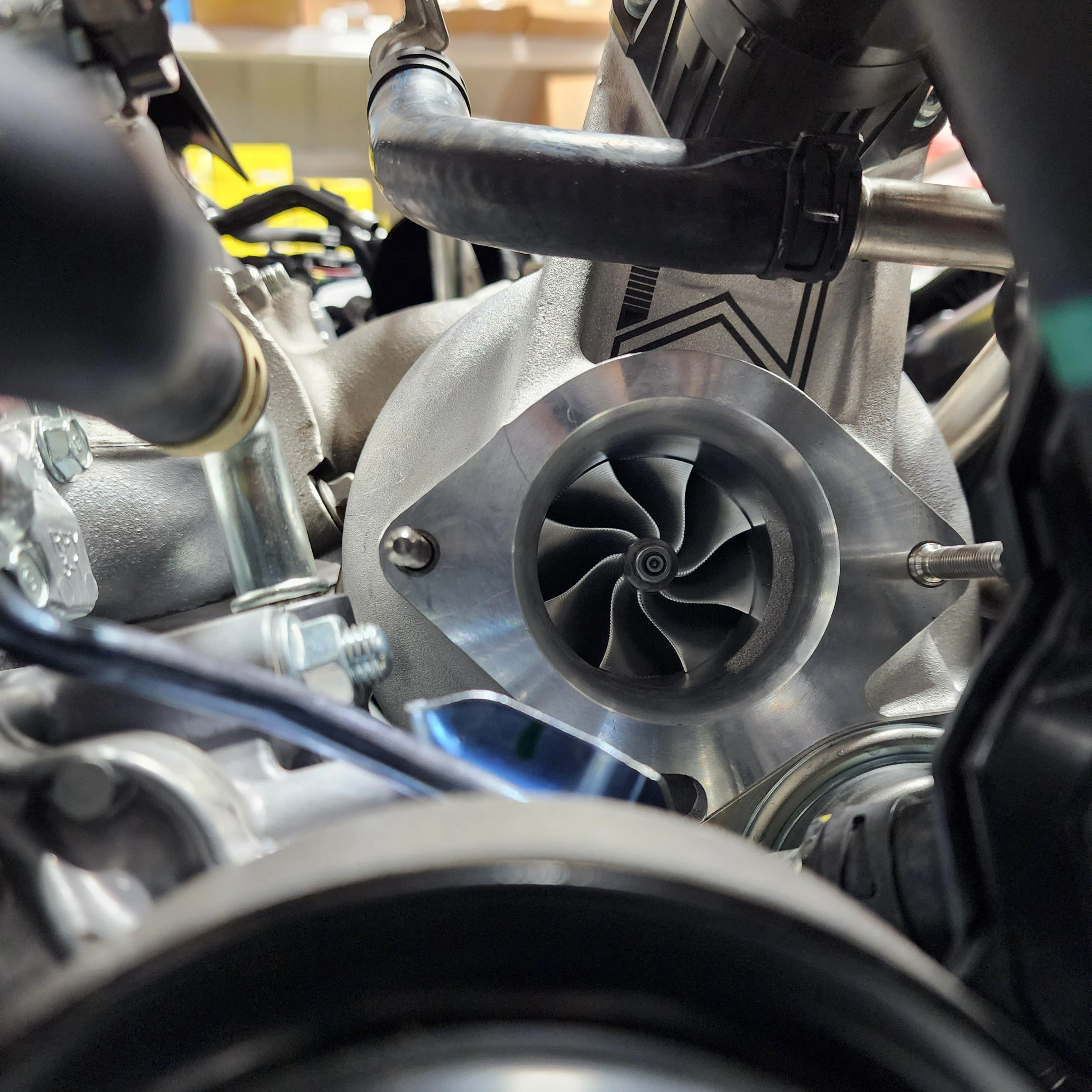

Kuro bolted up

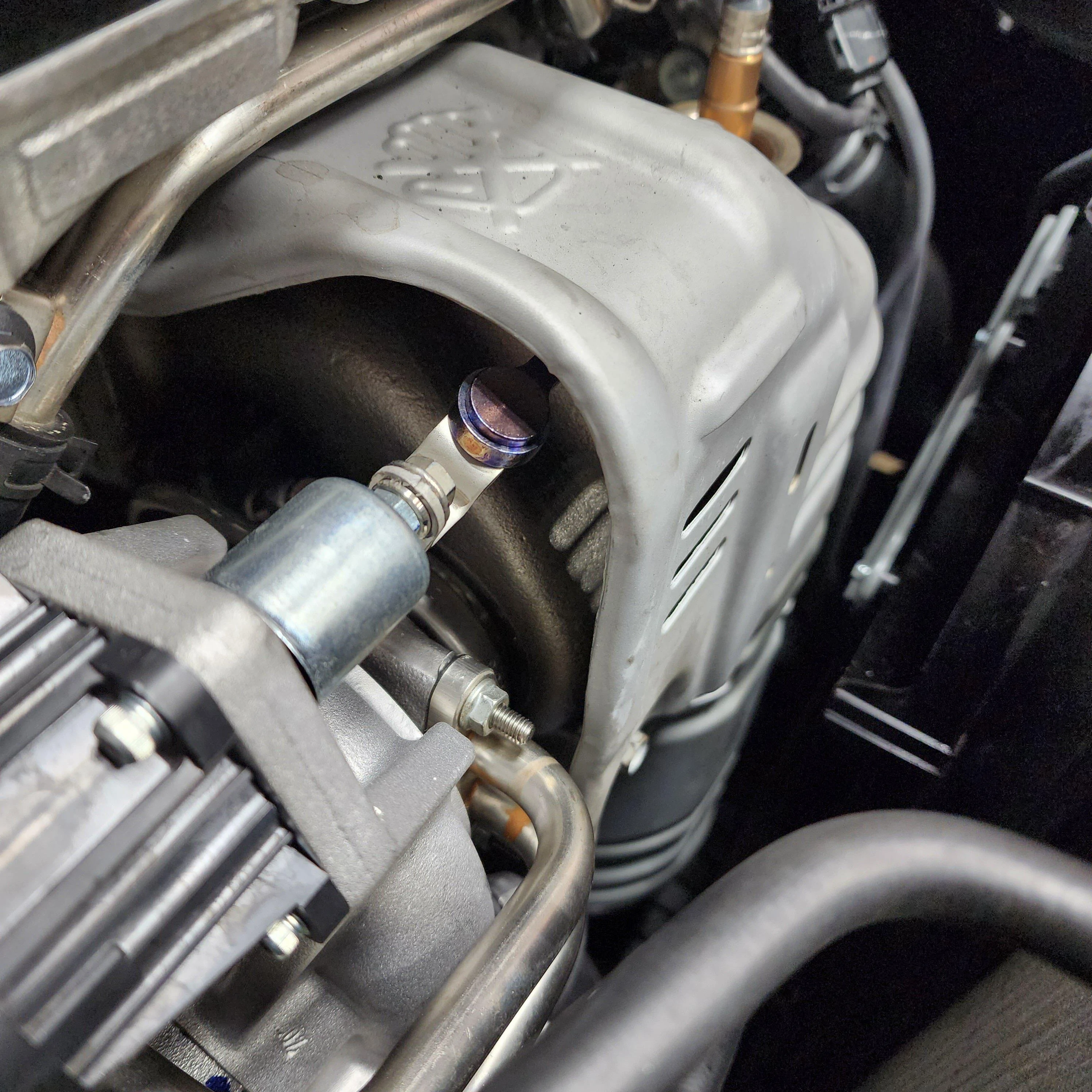

Heatshield on and DP getting dropped into the engine bay
11th Gen Honda Civic "UNITYFL5" Unity Performance 500HP FL5 Build Thread 20230901_155903
Top heatshield back on

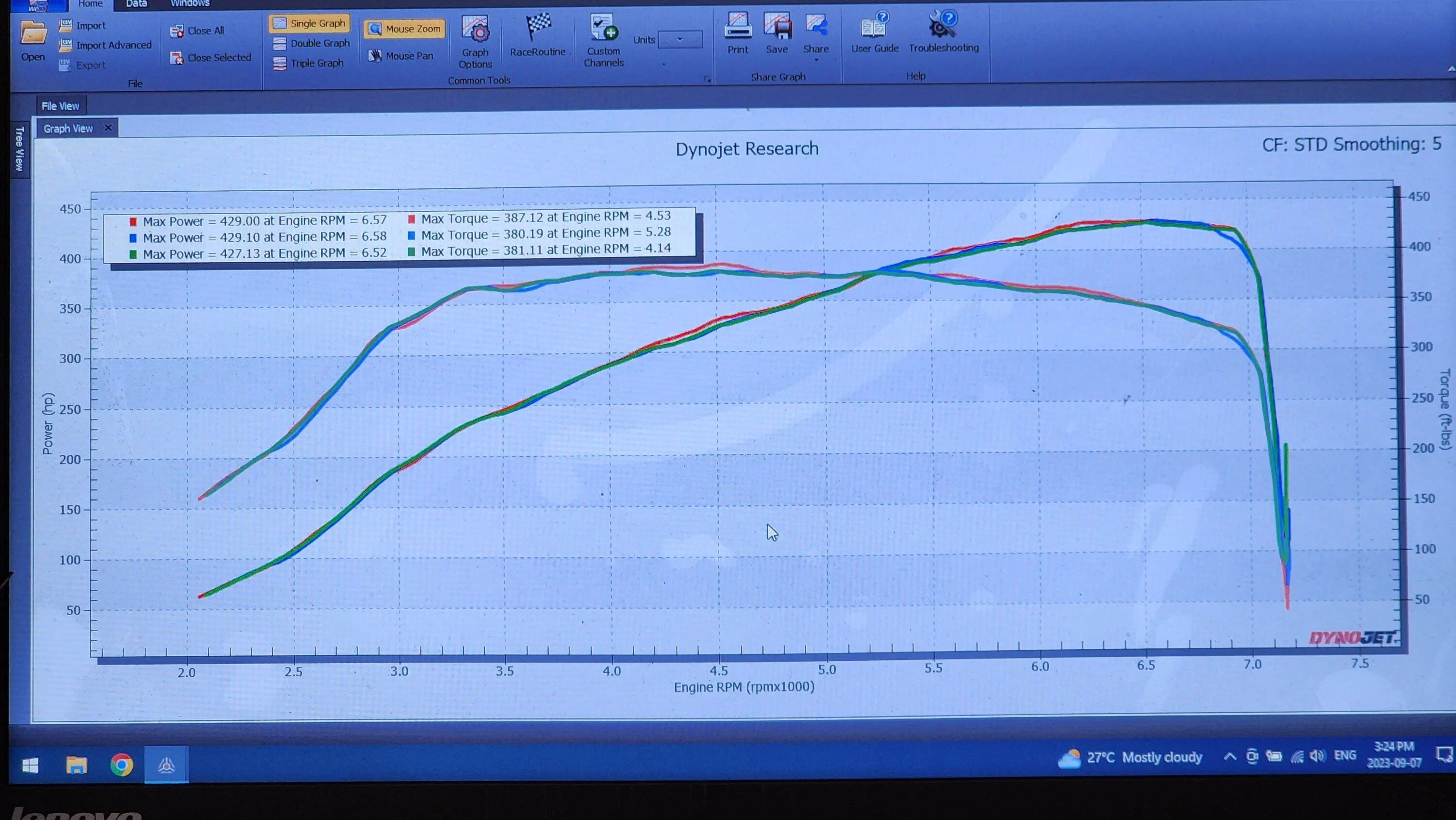

We've had good experiences with Derek Robinson from IMW before, so it was great to have him onboard for this project as well! Derek had a Kuro basemap ready for us on Hondata with 93, and a few days later we were able to book some dyno rental time to get the final tuning done.
429whp/387wtq is what she put down on the Dynojet! Super happy with these results!

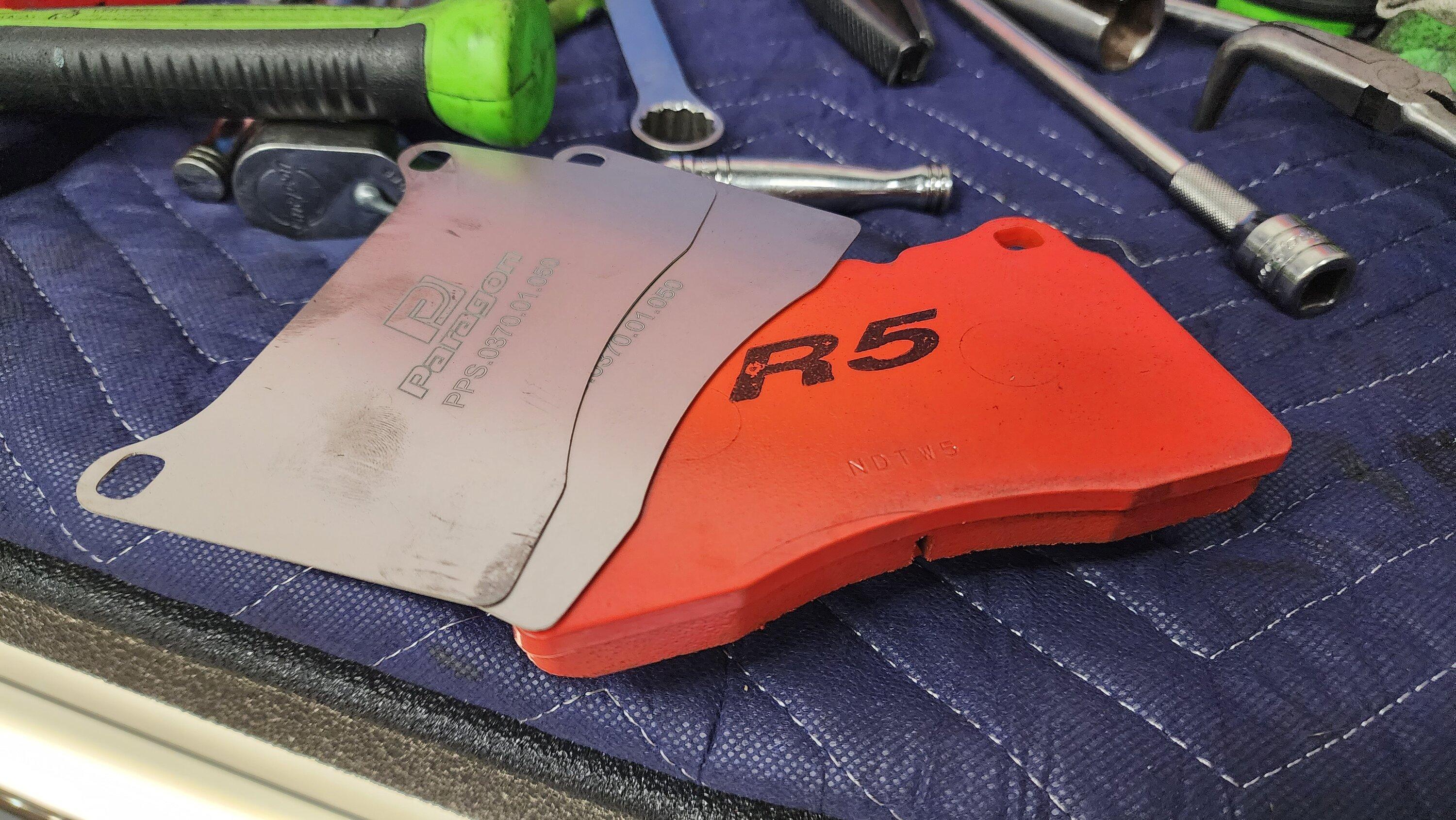

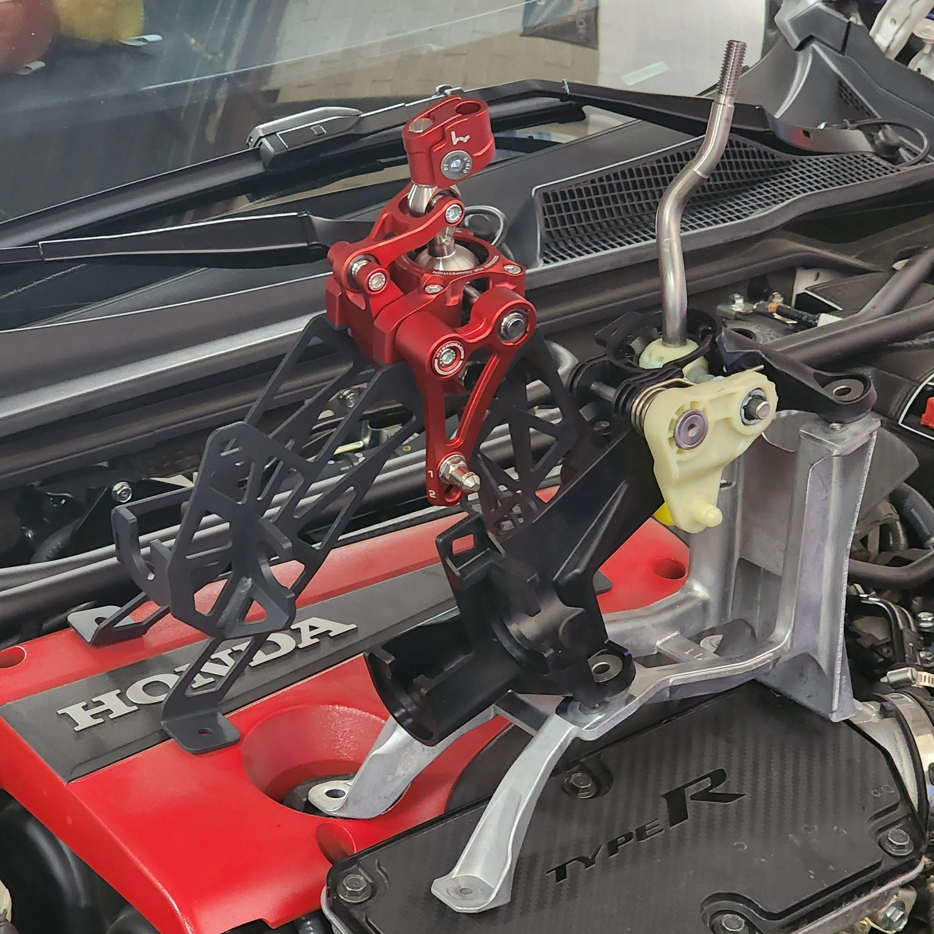

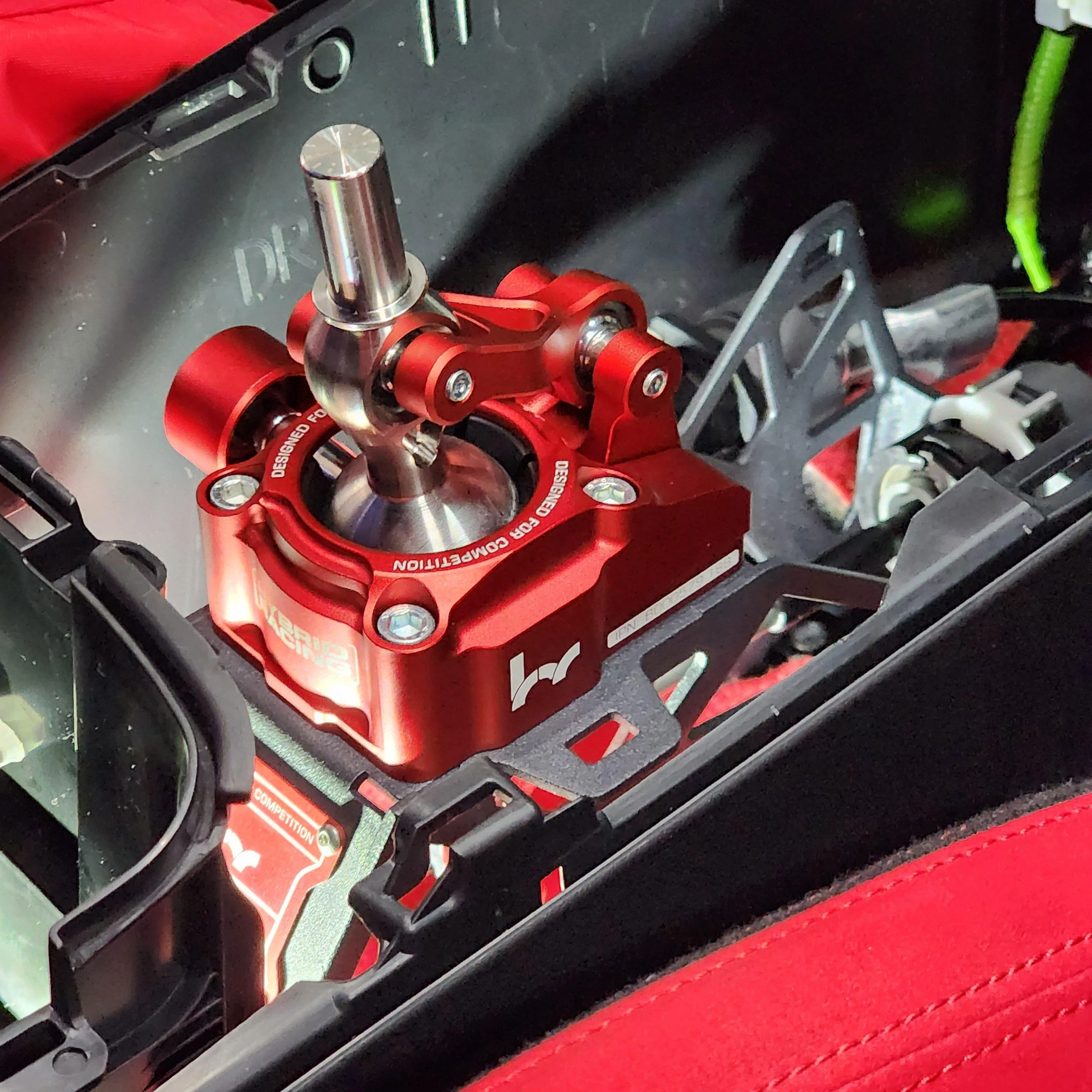

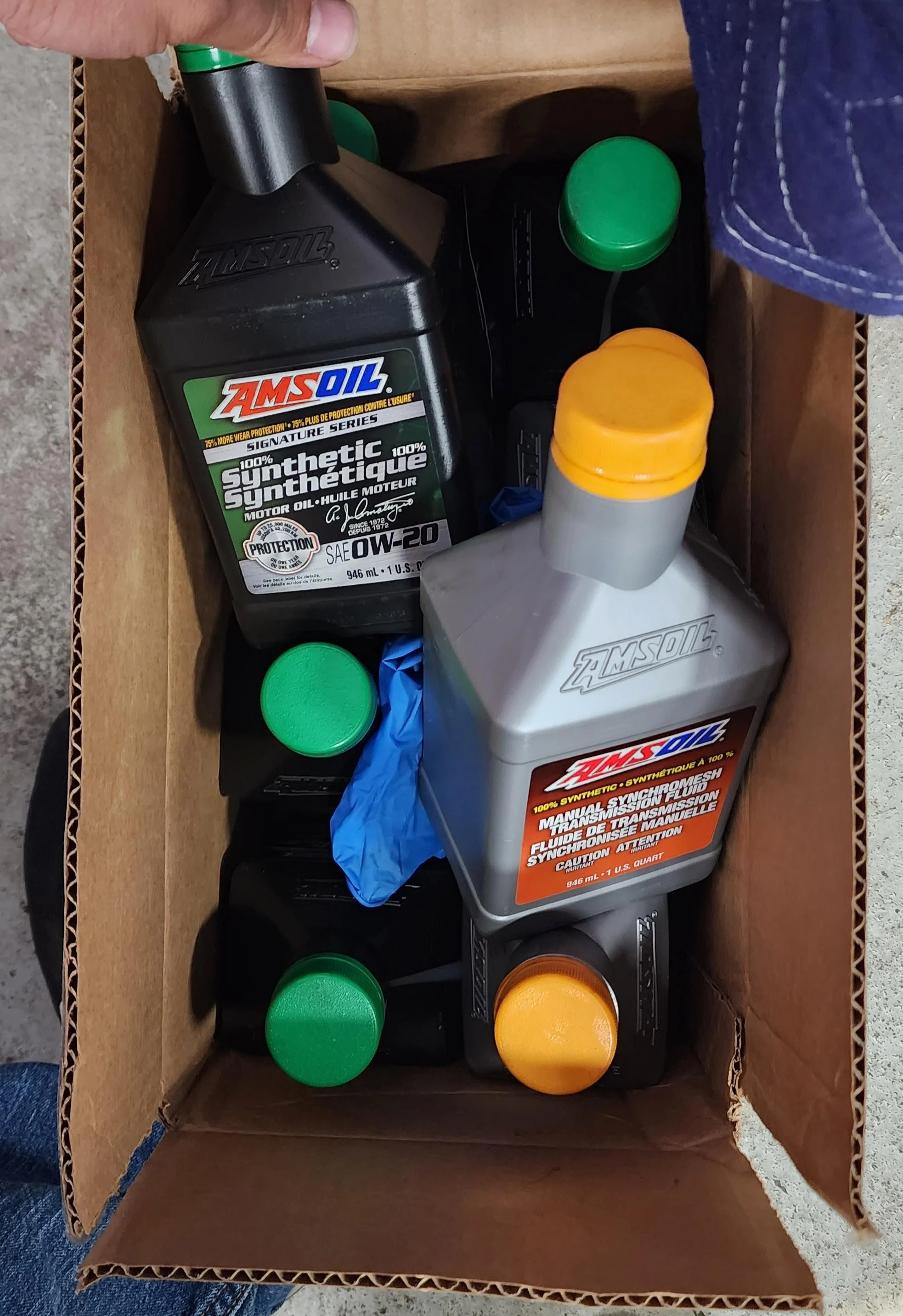

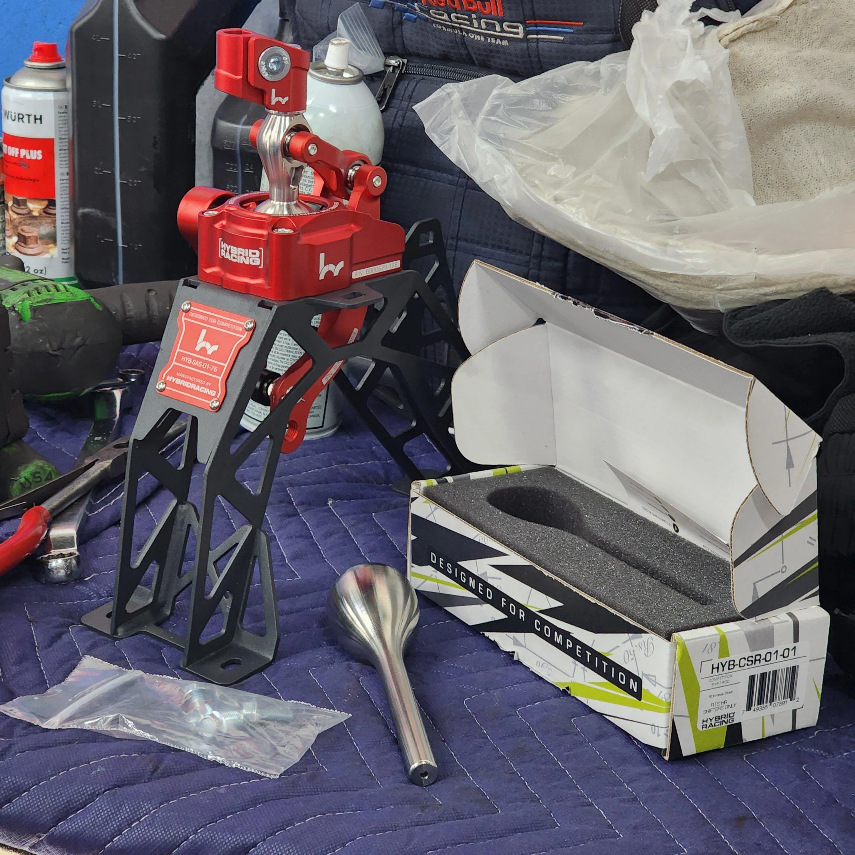

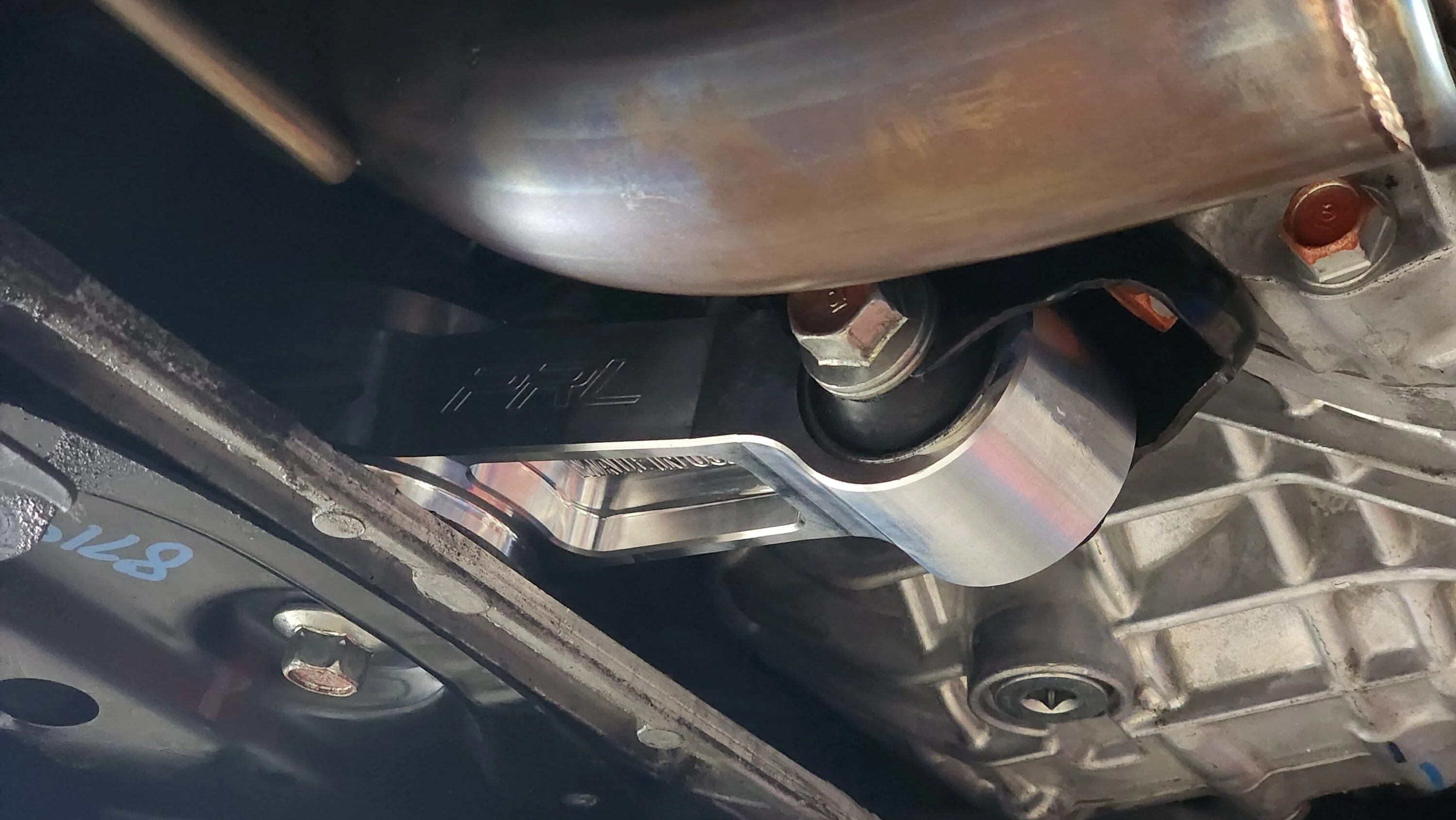

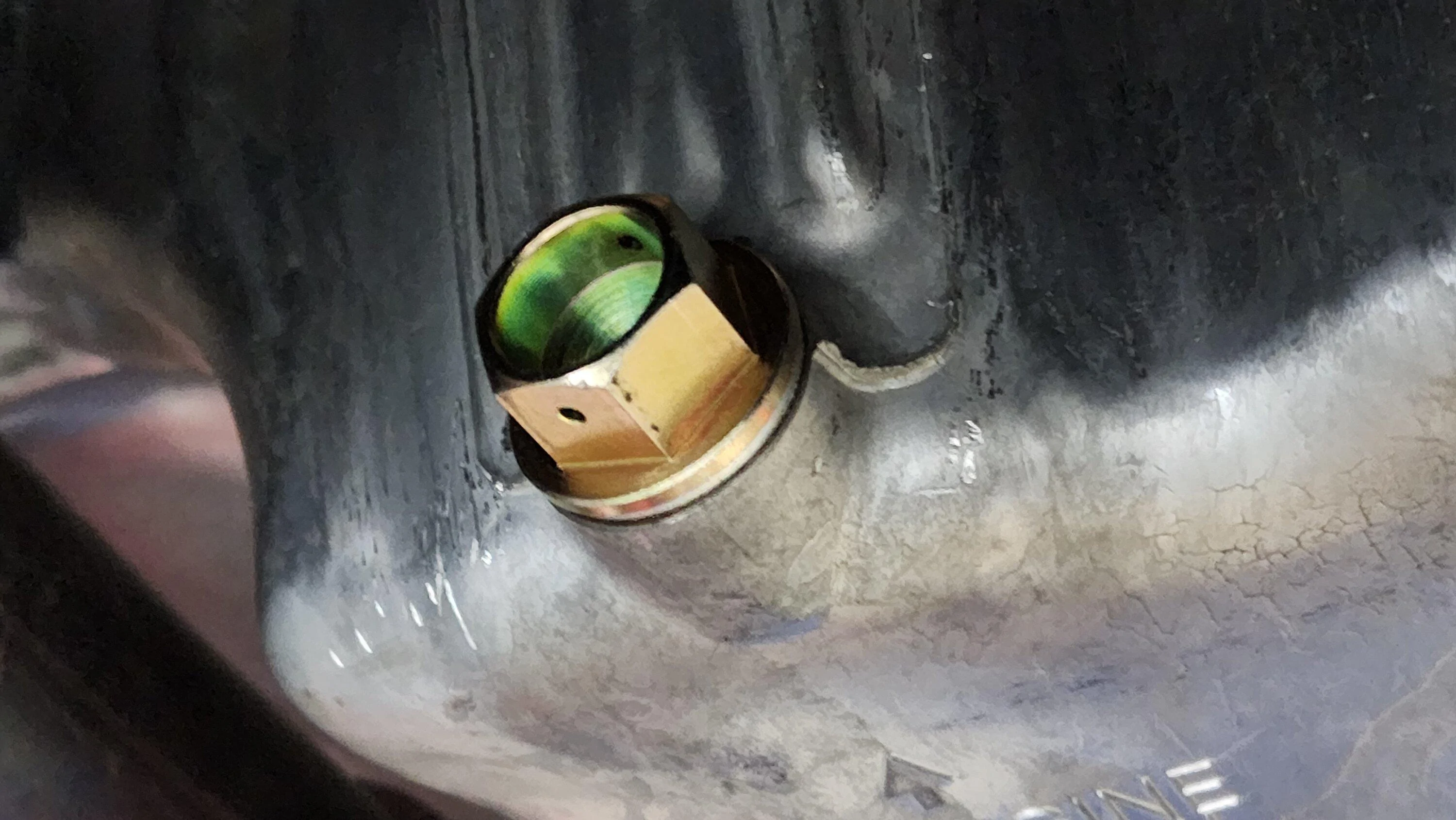

Track Prep!
Amsoil Signature Engine Oil
Amsoil Synchromesh Transmission Fluid
Hybrid Racing Shifter + Competition Rod
Paragon R5 Front Pads + Shims
PRL RMM
Spoon Oil Drain Plug
11th Gen Honda Civic "UNITYFL5" Unity Performance 500HP FL5 Build Thread 20230927_180647
