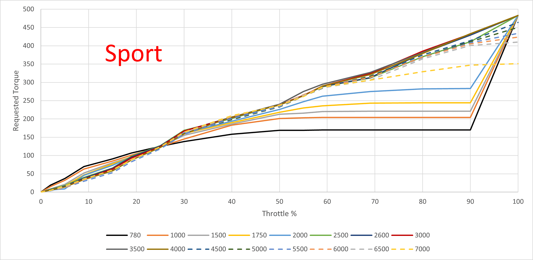

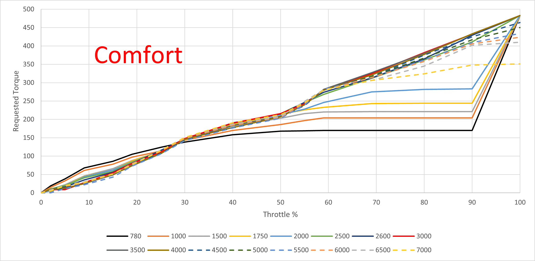

Wow thanks. I used picture to text to convert the tables to spreadsheet so I could plot them - surprisingly little difference between the modes and quite linear.
Ideally I would make a gif of the 3 images looping so you could see the differences but maybe someone else could do that.
It has been said on this forum elsewhere that +R and Sport have the same throttle mapping. It’s good to see that this indeed appears to be a factual statement. Case closed! Thank you and @Jester04
