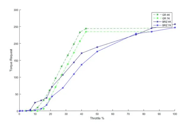

What does the CTR's "throttle curve" look like for each mode? Meaning what is the requested torque per %throttle (how far pedal is pressed)?
I used Sport setting initially as I was weary of overly touchy gas pedal from my Subaru experience - see below. CTR sorta seemed that way to me in +R, too touchy. In the end I settled on +R as it has been easy enough to drive smoothly and is seemingly more predictable there.
The stupid GR86 effectively has an on/off switch pedal. The plots show the requested torque vs. pedal position (throttle %) at 2 different engine speeds. My understanding is the curves are similar from idle as well, including the dead zone under 10% press. Very frustrating flaw to an otherwise perfect car.
11th Gen Honda Civic There’s a Reason Honda Made Active Exhaust, Don’t Disable 1710422716245-yl
If I only drove the GR86 I'd get used to it but jumping back and forth between it and a car with a very intuitive and linear throttle (GR Corolla) made it hard. The CTR's throttle does not seem linear to me, not as easy to control as GRC but isn't terrible. Sport and especially Comfort modes in CTR seem to introduce some initial dead zone making them harder to be consistent with than +R.

Question for you - I'm only curious so if you don't have this information I'm not asking you to go dig it out

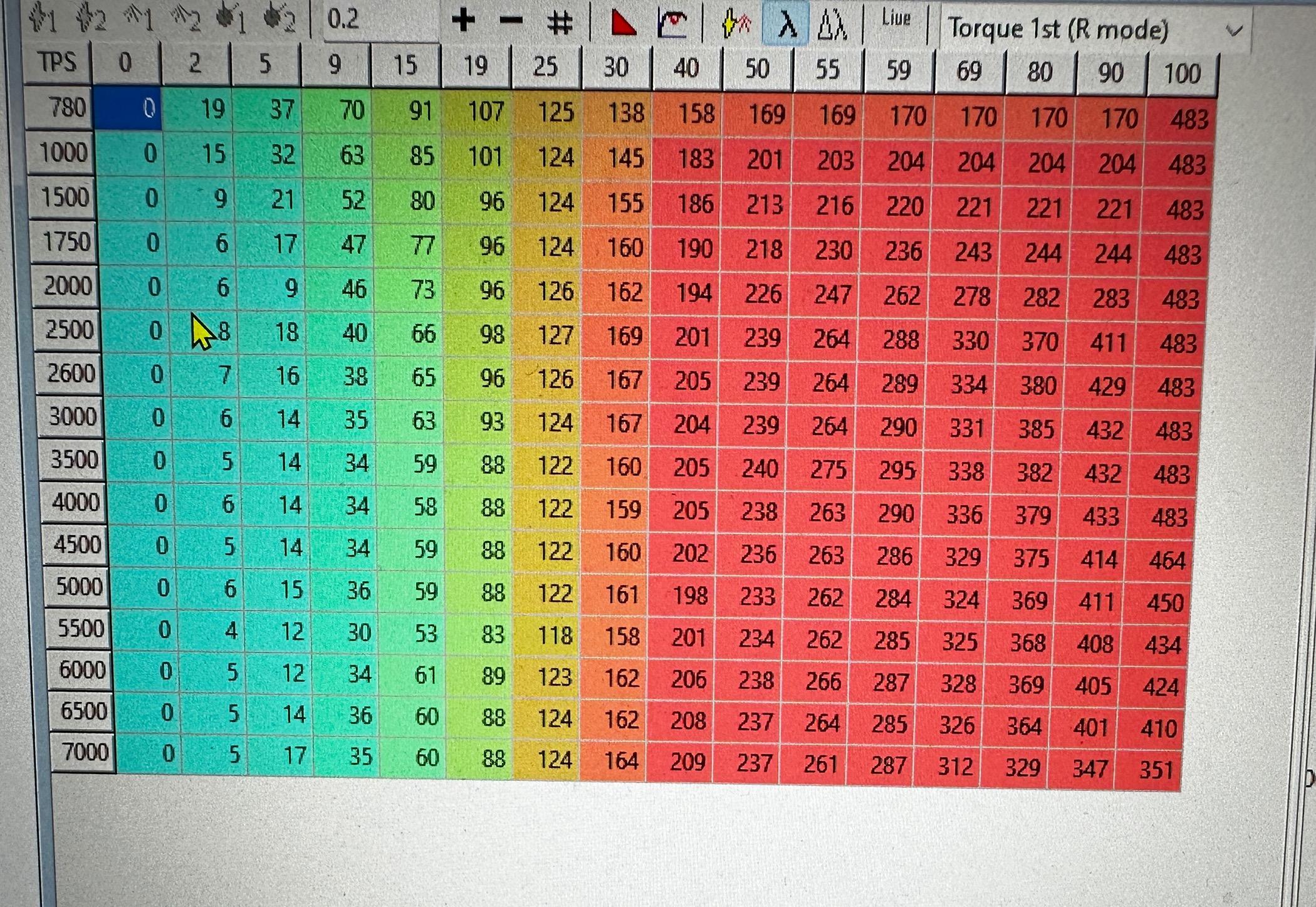

Yes so I can snap you a picture of the tables when I get home but there are some deadspots and it’s not the most linear throttle. But the good news its that it can be adjusted in the Hondata software. I spent a good deal on them to get them just right for my driving style.

Here are the torque throttle tables for a stock car.
Comfort
Sport
R+
Comfort
Sport
R+
Wow thanks. I used picture to text to convert the tables to spreadsheet so I could plot them - surprisingly little difference between the modes and quite linear.
Ideally I would make a gif of the 3 images looping so you could see the differences but maybe someone else could do that.
