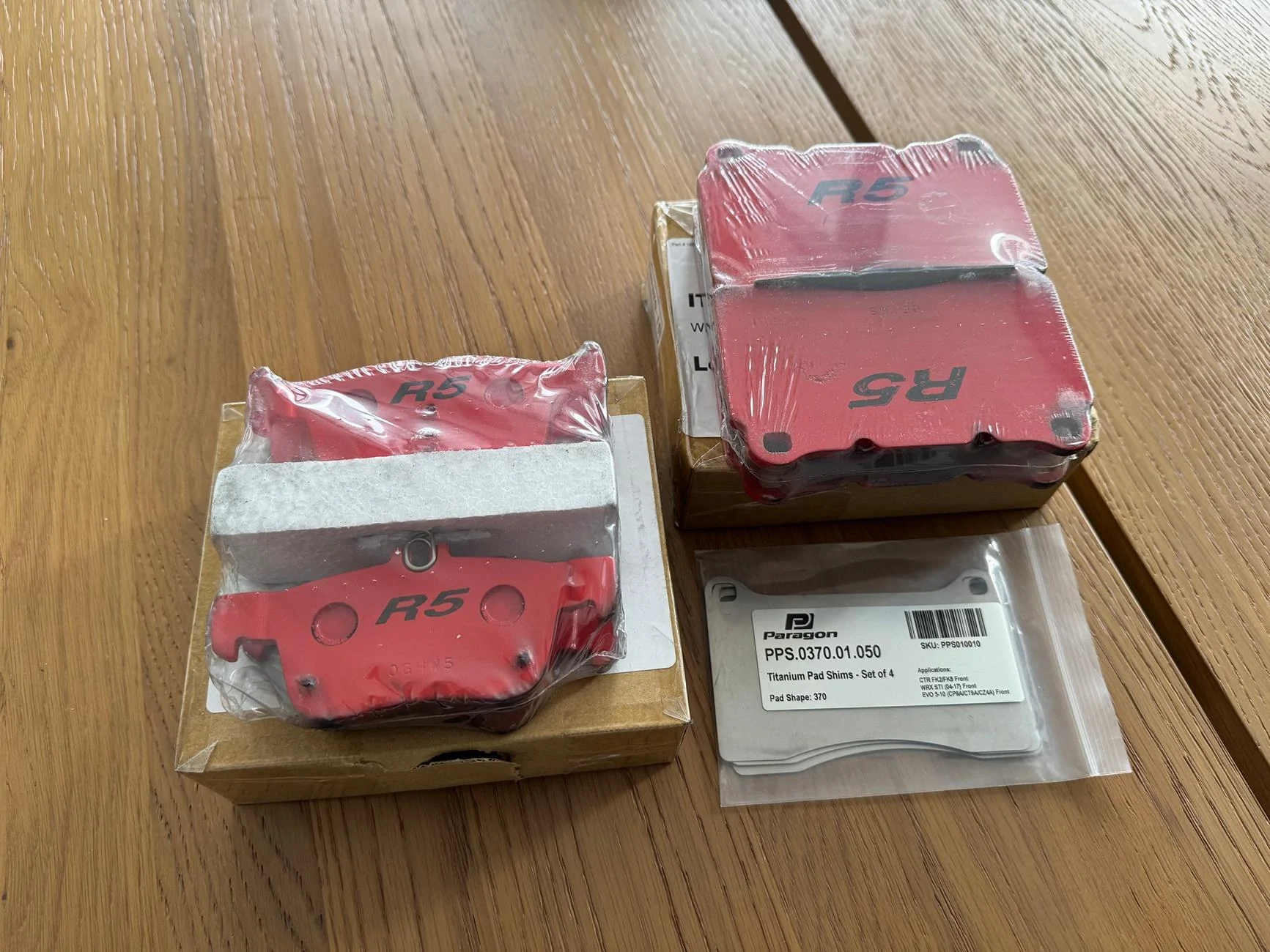

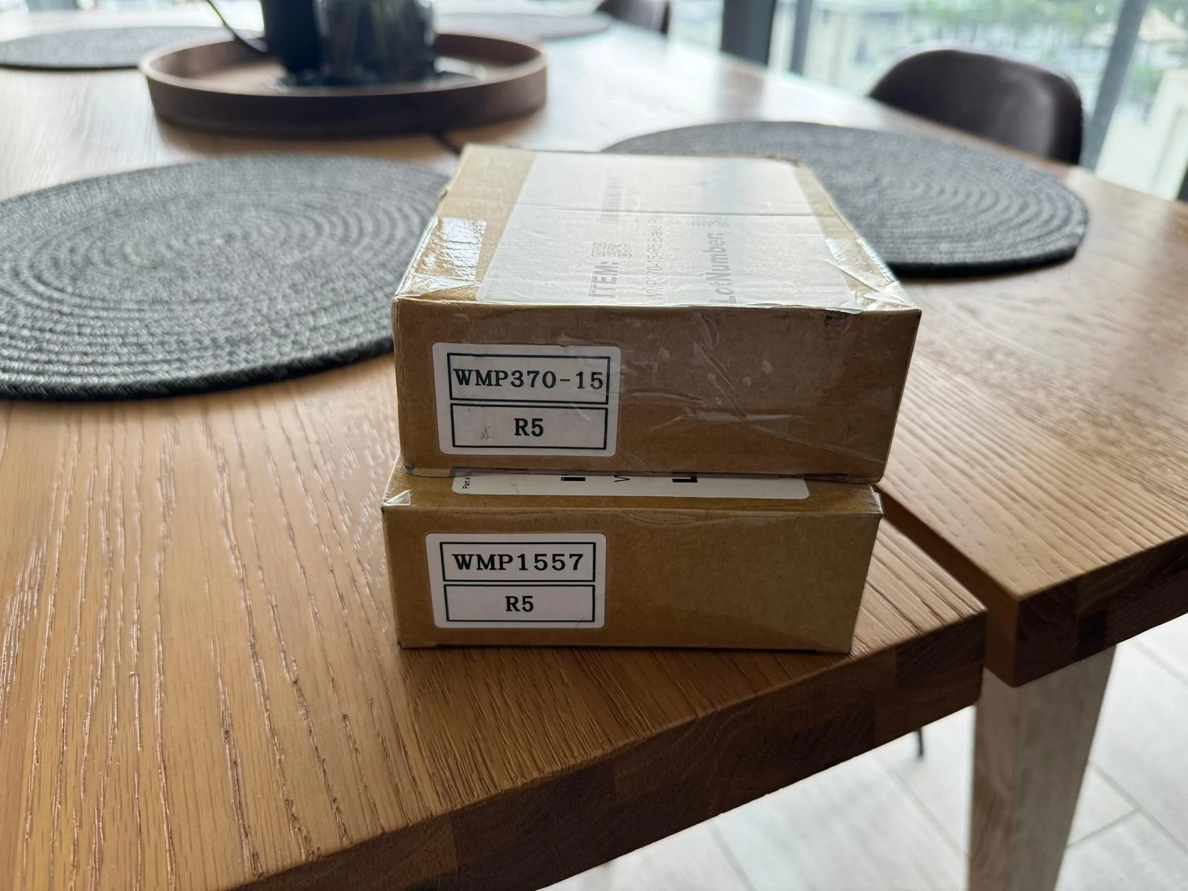

I have a track day coming up at the end of this month and my Project Mu's are looking a bit thin. So I just picked up a set of the rebranded Winmax W5 pads that everyone is talking about, along with the titanium shims.

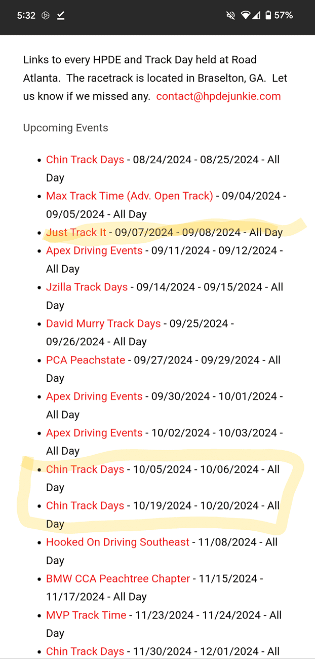

Anyone attending either of these weekends at Road Atlanta?

I have the three you highlighted on my radar but have not decided yet.

Same here. I am leaning toward the 2 dates with chin since I have 2 local events Aug 24 and 25th. Sept 7 and 8 may be a little close together for me.

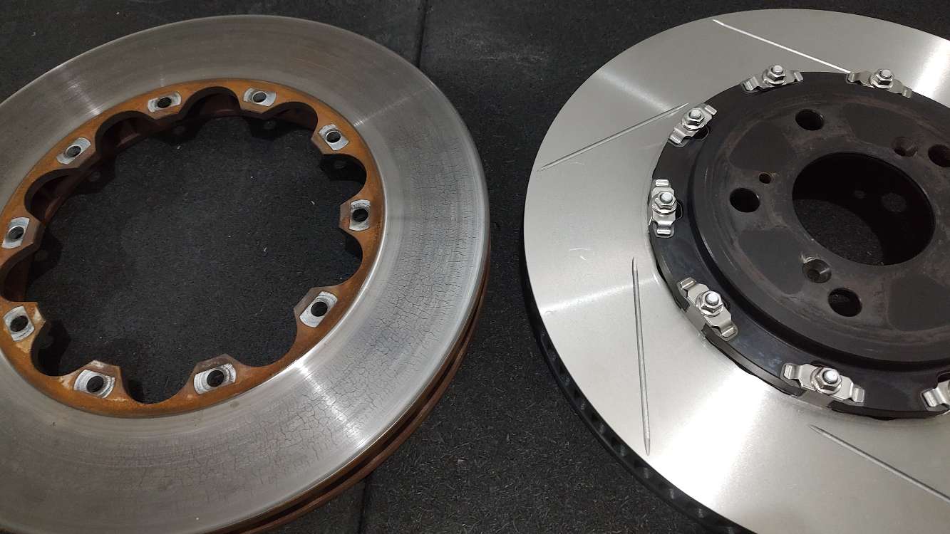

I went through 5-6 RPX sets before changing rotors for the first time. Rotors still had >50% life, but the rotor surface was badly deteriorated and required more and more time to seat new pads to it. I decided to install new rotor rings from Paragon ($550 for a pair) and from the very first use (!!) the combo SR11 and new rotors felt a lot better than properly bedded in RPX pads. From now on I'm going to replace rotors more frequently - they aren't that expensive when compared to the brake pads we use.

@keller you kept the factory center hats and just swapped rings, right? No more difficult than a regular brake job I imagine. Just more time consuming.

Yes, those rings are for the OEM hats. To be fair, not the easiest job no, considering any under/overtightening or missing the sequence can be of catastrophic consequences. I also had an issue with a manufacturing defect that Paragon promptly helped me out. All in all it unfortunately was a multiple day job, instead of just replacing rotor assemblies.
